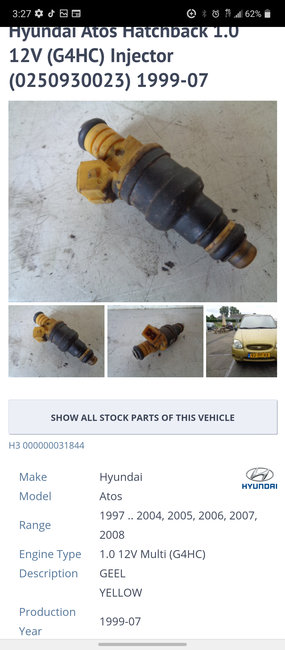

LOREN STOVER
  • 130 POSTS
I just pulled injectors and the number on it came up with this. I have not rotated injectors yet but I thought you might be able to shed some light on what year motor the injector belongs to.
Monday, December 14th, 2020 AT 1:32 PM
STEVE W.
  • 13,631 POSTS
Okay, if the plug was wet that injector is likely bad. The black is from excess fuel and it sounds like it is sticking open. OEM number for the injectors for the 2.0 is 35310-23210.
So I think you found the culprit. Because the other plugs looked dark as well I'm going to say someone stuck a set of salvage yard injectors into it and were not real particular about what part they used. Then one of them failed and is dumping a lot of extra fuel into the engine and that is also why the trims are so high, it is trying to lean out the mix because of the extra fuel. I would probably replace all 4 with the correct part numbers and do an oil change as it's very likely the oil now has a lot of gas in it.

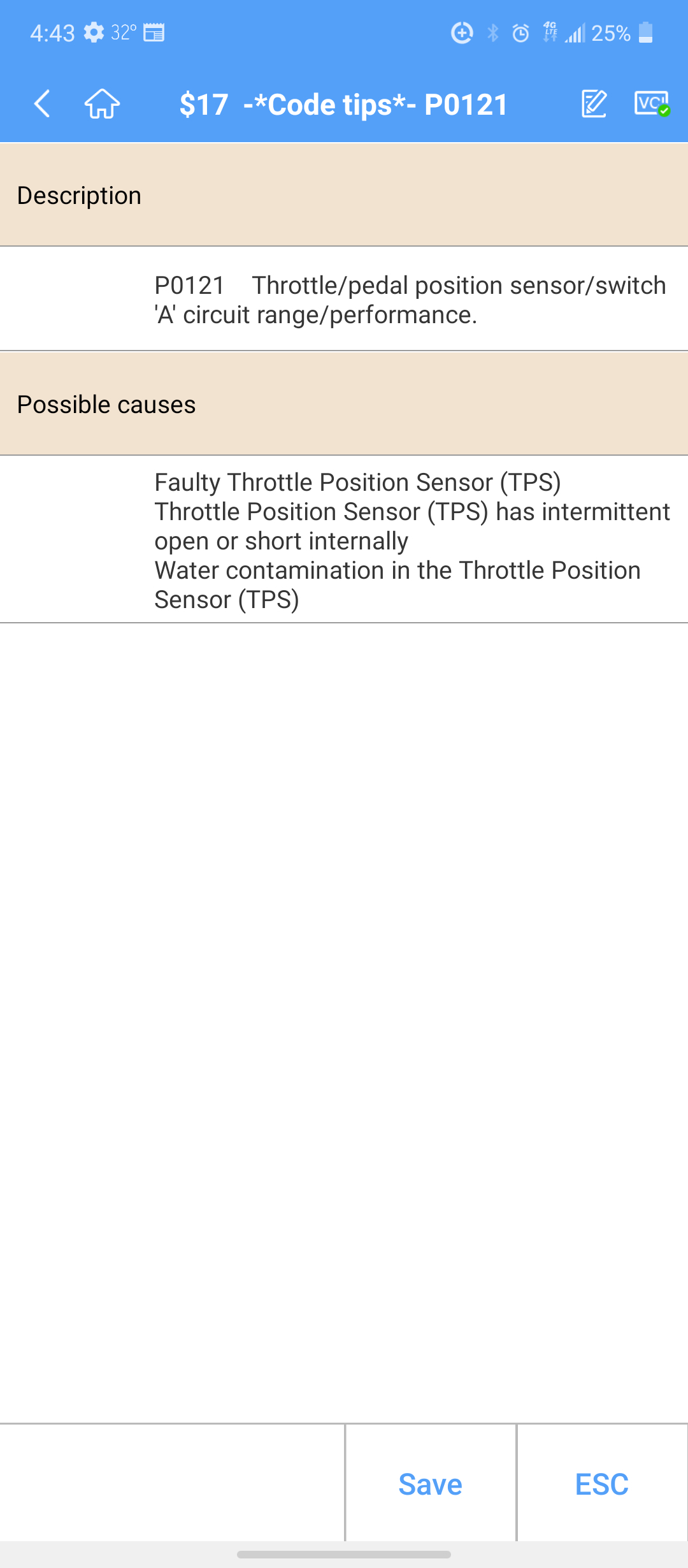

LOREN STOVER
  • 130 POSTS
I just drove the car again and It did excellent except for whenever I stop or give it gas. And I got a code P0121. I sent you a picture of that code.
Tuesday, December 15th, 2020 AT 2:46 PM
STEVE W.
  • 13,631 POSTS
Great to hear it runs. Okay, it looks like you answered your own question about the TPS. If your scan tool can graph the data you can watch the TPS voltage and slowly press the pedal down. If it's got an issue you should see the voltage drop out, just go very slow as the data has to go through the network and that time lag can hide a momentary drop.
