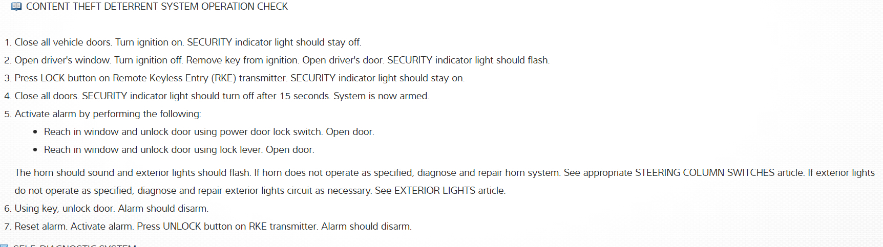

Thanks, I will read through this soon and get back to you. I believe that when I hit the ice and spun it did in fact trigger the pass-lock on the truck. I came to a very abrupt stop as the tires dig into the ground. So I think that the engine is not getting fuel due to the security feature.

Hello Amanda,
I have included a step by step system operation check for your vehicle's Pass-lock anti theft system down below in the diagrams. Please go through it and let me know what you find out.
