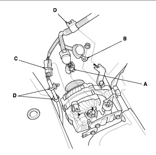

Hi, this is my friends car. The battery terminals were loose. I know it can short out the alternator. I had a 2002 Honda Civic and it was the eld. Does a 2010 have one also? I have voltage to the alternator. I did notice the battery light goes on and off real fast when i turn on the key. It doesn't stay on steadily with the key on. It also is not on and it's not charging. I did check the main power fuses all good. Am I overlooking anything before i diagnose it as a bad alternator? Thanks, Neil

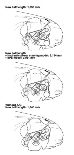

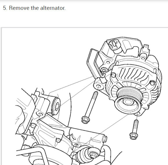

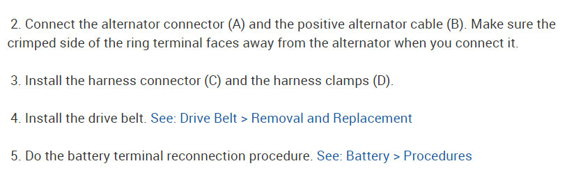

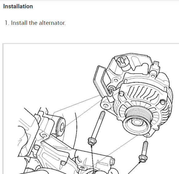

Having the battery terminals loose won't necessarily short the alternator out but it will keep it from charging properly. After tightening the battery cable clamps I would definitely have have alternator load tested to see the actual output. Most auto parts store will do this for free. Here is a tutorial showing what is involved for an alternator load test and replacement:
https://www.2carpros.com/articles/how-to-replace-an-alternator

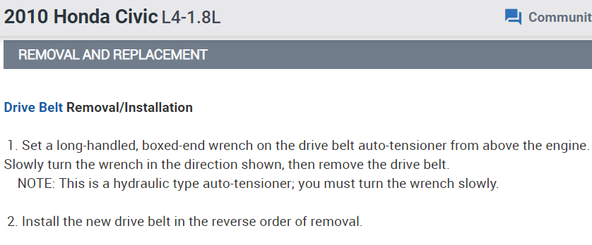

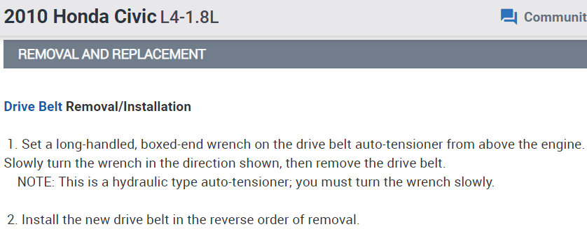

If you want to remove the alternator yourself to be tested here is a tutorial showing how to remove and replace the serpentine belt to gain access:

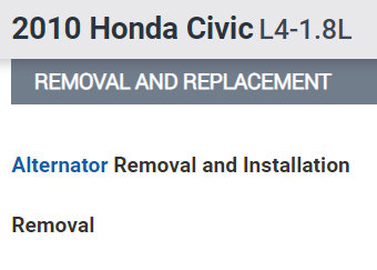

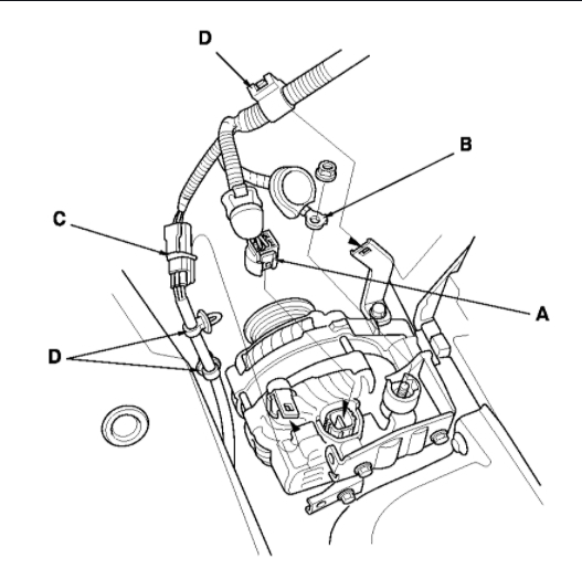

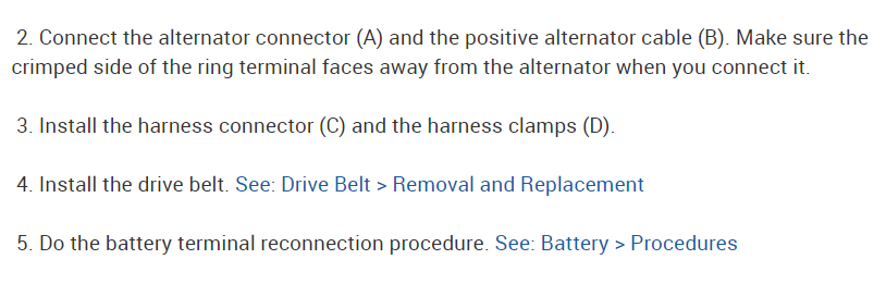

I've attached picture steps below on how to remove and replace both the serpentine belt and alternator on your car. Get back to us with the alternator load test results and we'll go from there. Hope this helps and thanks for using 2CarPros.

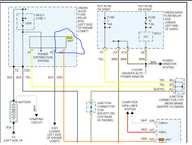

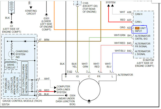

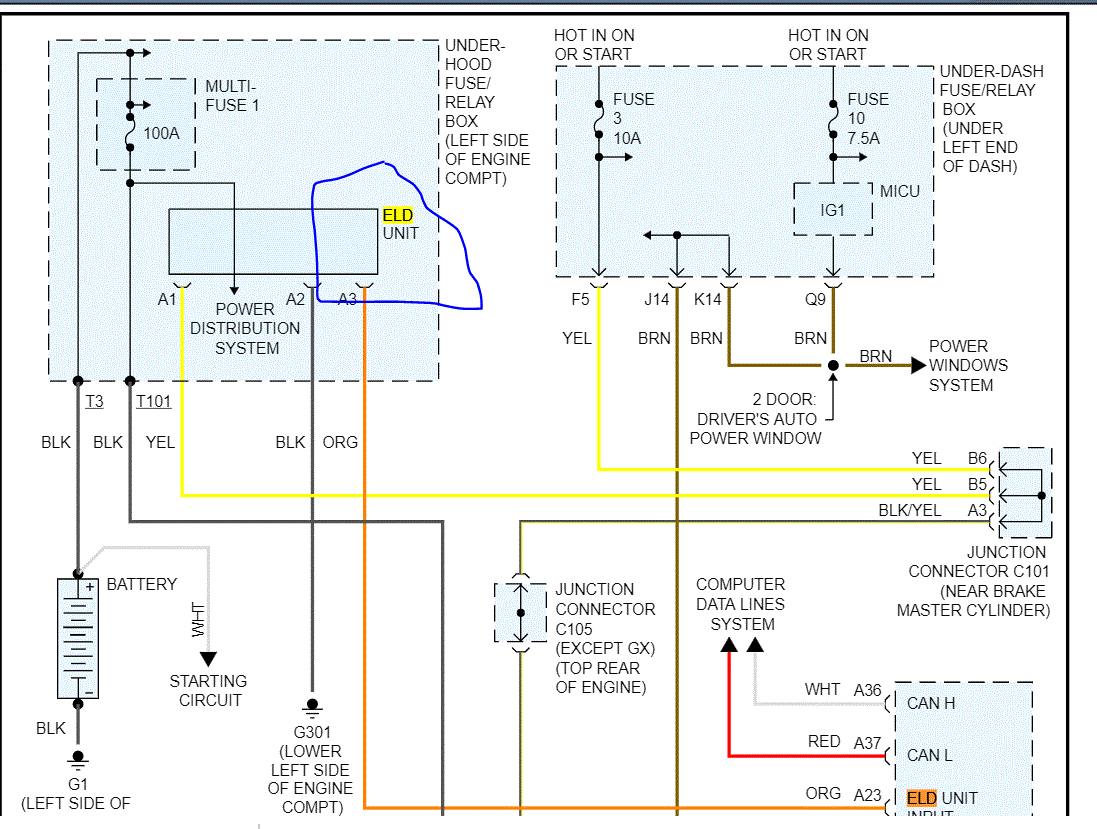

It does have a load detector. If you take a look at the attached pic, they show the entire charging system. I had to cut the pic in half to make it readable. I did overlap them.
If you look on the pics, I highlighted ELD to help you find it. I also highlighted where it attached at the PCM.

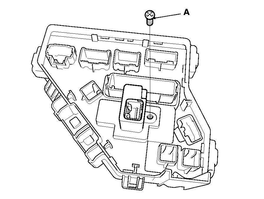

If you find it is bad, here are the directions for replacement. The remaining pics correlate with the directions.
_______________________________________
2010 Honda Civic L4-1.8L
Removal and Replacement
Vehicle Powertrain Management Sensors and Switches - Powertrain Management Sensors and Switches - Computers and Control Systems Electric Load Sensor Service and Repair Removal and Replacement
REMOVAL AND REPLACEMENT
ELD Replacement

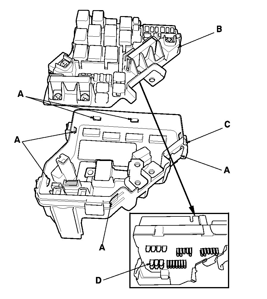

1. Remove the ECM/PCM. See: Engine Control Module > Removal and Replacement
2. Remove the under-hood fuse/relay box. See: Fuse Block > Removal and Replacement > Under-Hood Fuse/Relay Box Removal/Installation

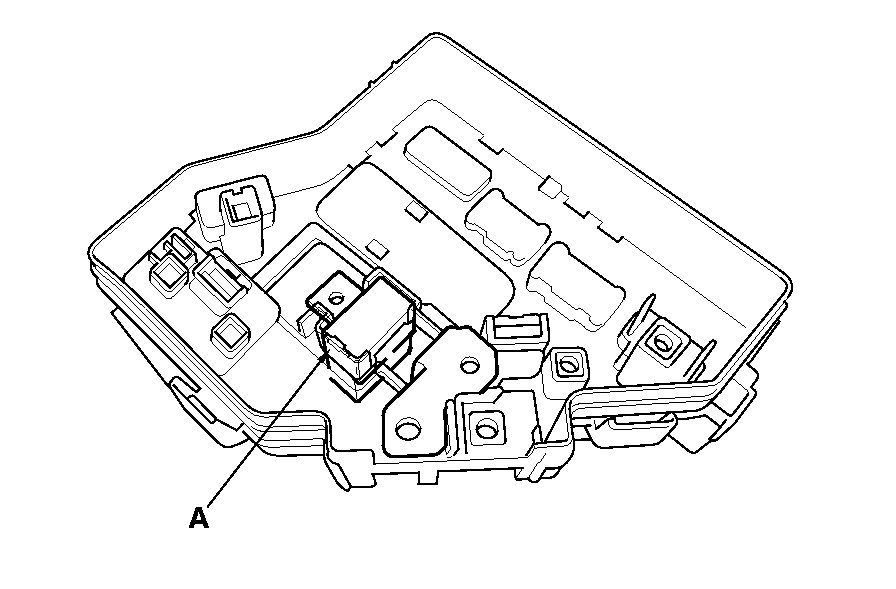

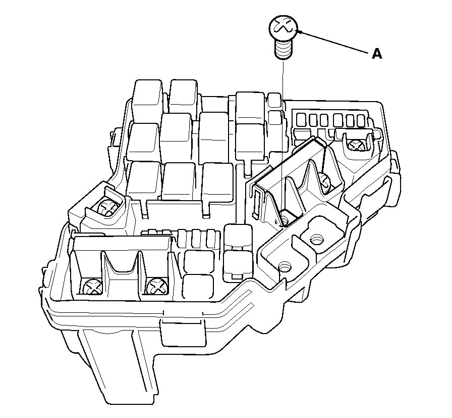

3. Remove the screw (A).
pic 3

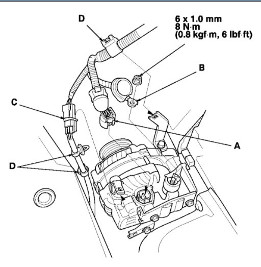

4. Turn the housing over, then remove the screw (A).
pic 4

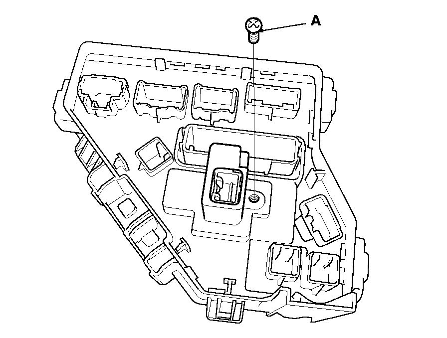

5. Turn the housing over again. Using two flat-tip screwdrivers, release the tabs (A), and pry up the fuse/relay box base (B) from the fuse/relay box housing (C).
NOTE: Make sure the terminals (D) are not bent or damaged.
pic 5
6. Remove the ELD (A).
7. Install the parts in the reverse order of removal.
pic 6

Hi, sorry I've been recovering from hip replacement surgery. Is there a way to check the ELD or bypass it to confirm it's good or bad? I also noticed the battery light when you put the key on goes on and off quick. Is it supposed to stay on all the time while the key is in the on position? Just something i noticed not sure if it means anything. i thought it was wrong/weird. Thanks. Stay healthy and have a great day.

There isn't a general test, but there are specifics based on diagnostics codes. Have you been able to pull any codes?

Battery was removed to charge. No check engine light. Would it store it? One more question/possibility. If we pull the alternator and have it tested and it tests good, would it be the ELD then? It does have power at the main lead on the alternator. I checked it while running.. Thanks
Jan 18, 2021 at 9:17 AM
  • 110,244 POSTS
If the alternator is good and all connections are good, that would be my first suspect.

Thanks for all your help. It was a bad alternator. Great suggestion to have the alternator checked prior to buying. Best part was I wasn't the one out the in a 5 degree wind chill doing it, lol. Have a great day/weekend and stay healthy!
