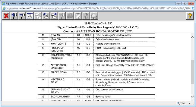

I have a '99 honda civic lx that the alternator and battery went out it is a manual transmission. I repalced them and now the battery will not charge. I replaced the alternator a second time due the new alternator failed the bench test. The latest alternator passed the bench and the car still does not charge. It runs fine but if I use heat/ AC or radio the car will not restart due to dead battery. As a side the vehical speed sensor stoped working at the same time which I have replaced twice and it still does not work. I thought it was a bad alternator connector so I went to a junk yard found a honda with and replaced about 1 foot of wiring harness but still does not charge? Any tips or thoughs?

Alright with the key in the run position see if the white wire and the black wire with a yellow stripe at the alternator has battery voltage?

The key was in position 2 which turned on the accessories but was not started.
First check battery voltage good
Next check white wire to ground = 0
then white wire to black/yellow strip =0
back/yellow strip to ground = 0
Did not get battery voltage.
+1
Wednesday, May 22nd, 2013 AT 11:04 AM
SATURNTECH9
  • 30,869 POSTS
For the white wire check the 80 amp fuse which is number 41 in the under hood fuse box. Next for the black and yellow wire check the 7.5 amp fuse number 15 in the under dash fuse box. Let me know what you find.

It is fixed! Thanks when I check the fuse the first time I must have pulled the wrong fuse. I am very greatful for the help!

Reaching out for any help I can get. So I replaced the fuse it works well for about 7 days and now has stopped charging and keeps blowing fuses every time I start (that same spot as was blown prior). Any suggestions?

Which exact fuse is blowing?
Sunday, June 30th, 2013 AT 5:53 PM
AUGMAN3
  • 8 POSTS
Sunday, June 30th, 2013 AT 9:08 PM
AUGMAN3
  • 8 POSTS
Which is labeled alternator and vehicle speed sensor but I am wording if it is in the same circuit as the oxygen sensor because that is the computer code that is coming up.
Sunday, June 30th, 2013 AT 9:11 PM
SATURNTECH9
  • 30,869 POSTS
Sorry for the long delay I didn't get a email alert you responded I just saw your reply I posted what that fuse powers doesn't power the o2 sensor.
