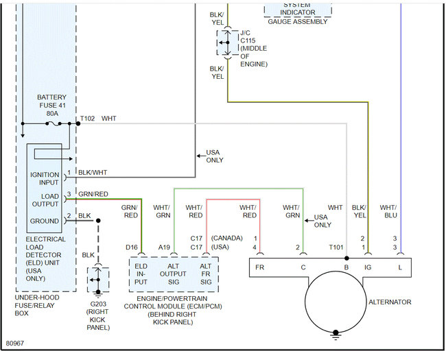

Hey, I have a 1998 Civic EX manual. My battery keeps draining. It's brand new made last month along with a new alternator. I cleaned off all grounds, checked all fuses and still no charge to the battery. The battery light on the dash does not come on I checked the bulb it's fine and so are the fuses. What else could possibly be the problem?

Battery does not drain over time so it's not parasitic draw. When ignition is turned to on position oil light turns on so does the e brake light, but not the light for the battery. I put a new bulb, I checked all fuses and still no light. I then checked for any dirty grounds and cleaned them all off, making sure they have good connection. Checked all under-hood fuses as well all good. Even checked for continuity between the white and blue wire from the alternator wire harness and the gauge cluster. So, I'm really out of ideas and need help.

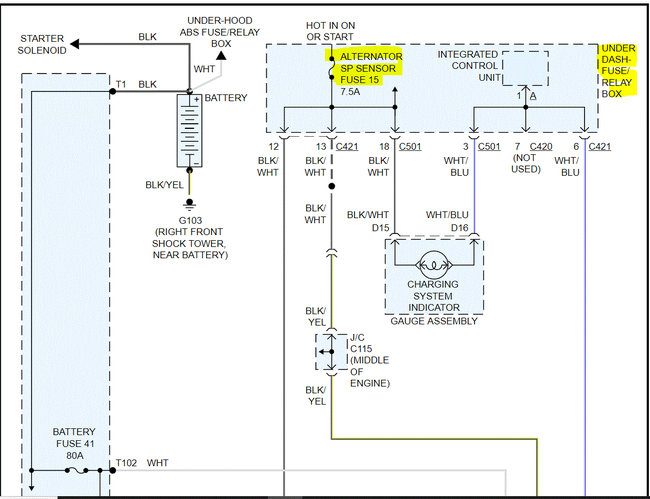

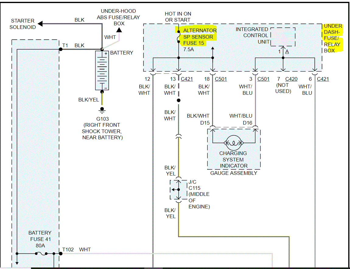

Also, if you haven't made progress, I need you to first confirm if the SP sensor fuse in the under-dash fuse box is good. In addition to checking the fuse, confirm there is power both to it and from it. Here is a link you may find helpful:
Now, I attached the wiring schematic below related to the charging system. Note that I had to cut the one picture into two, so it was readable for you. I did overlap them so you can follow from one to the next.
Next, there should be a white wire on the alternator which has battery voltage at all times. Please confirm that for me as well.
If it is good, we simply need to confirm the alternator is producing. Here is a link that explains how to test it. If you have already done this, let me know the results:
Let me know the results. Also, for some reason, my manual isn't providing the fuse layout for the vehicle. However, the SP sensor fuse is in the under-dash fuse/relay box. It will be fuse number 15, a 7.5-amp fuse. Note: If the SP fuse is bad, it will prevent the light from turning on.
One last thought. If I recall correctly, there were issues with the wiring to the alternator near or under the intake that were known to dry out and have the insulation fall of causing shorts. Inspect that as well. Make sure nothing has rubbed through.
Sunday, October 10th, 2021 AT 8:37 PM

i appreciate all the help I did find out that the white wire that connects directly to the battery was only hanging on by 2 copper wires, so it was barely even connected to the alternator. Once I got a new connector for it and tested the alternator with the car running it worked! But the light was still not working I got tired of testing and trying. So, I took it to a mechanic who told me that its most likely just the cluster that has gone bad, but the alternator is for sure charging the battery.
