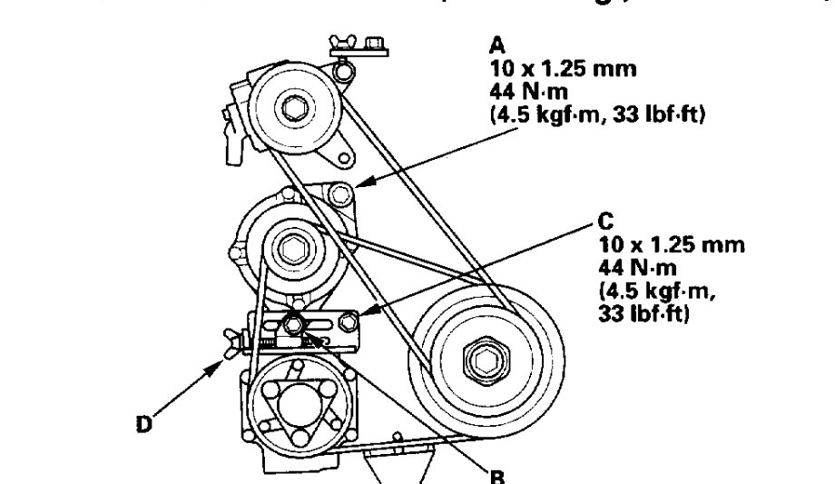

I have been having a lot of problems with my car making squeaking noises in the last few months. First my compressor went bad, so we had it changed and then the alternator went bad, and we had that changed as well. After all that, now my car is making this squealing noise every time that I press the gas and it continues until I stop pressing the gas. It's not a screeching sound but it's also a sound that you can't avoid hearing. Turning on the ac makes it stop a little but not very much. I had the smaller belt changed because it was cracking but the noise continued.
Sep 16, 2023 at 6:34 AM
  • 110,244 POSTS
It sounds like a belt issue. Is it possible for you to record and upload it for me to hear?
There are two belts on this vehicle, so one may be loose. See pic below.
Let me know which one was replaced and if you have checked for tension.
See pic below.

Hello Joe,
Thank you for helping me. I changed the belt on top, but the noise continued. The noise continues to go away for a few minutes when I have the A/C on.

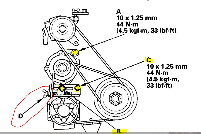

Hello, I was able to figure out that it was the lower belt that stopped squeaking when I put some water. What do you think I should do moving forward?
Sep 28, 2023 at 2:59 AM
ROMON
  • 6 POSTS
Hello, I was able to figure out that is the lower belt that stopped squeaking when I put some water. What do you think I should do moving forward?
Sep 28, 2023 at 3:00 AM
  • 110,244 POSTS
Is the belt in good condition? If it is, chances are it needs tightened. I attached a pic below. I highlighted 3 bolts that you will need to loosen (not remove). One they are loose, the nut that I circled in red needs to be tightened.
When you tighten it, there should be approximately 1/2-inch movement up and down at the belt.
Try this and let me know if it resolves the problem.
See pic below.
