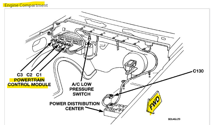

Hello, yes, it's been a while, what is the VIN for this vehicle? There are quite a few different 5.9L 2wd RAM models. There are two different vin #s it can be. V8-5.9L VIN 5 or VIN Z. There probably isn't much difference, If you have no bus messages and no comms with a scan tool, have you gone through and checked all the fuses? Your PCM is most likely missing power or ground.

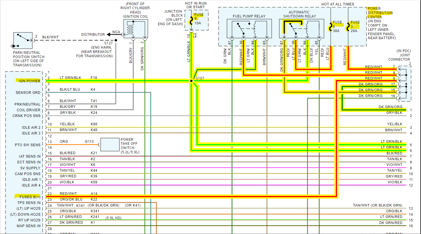

Do you have a test light to check for power? And the Power Distribution Center which houses the ASD relay, Fuel Pump relay and Fuses for the PCM, located on the driver side inner fender panel near the battery is where I would look for corrosion issues.

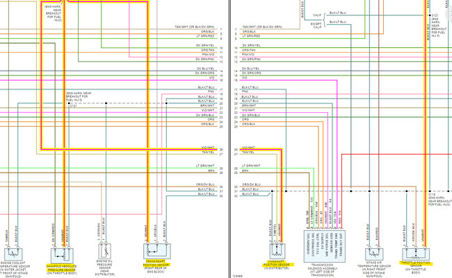

Ill post a couple diagrams where there are some fuses to check with a test light
hooked to battery negative.

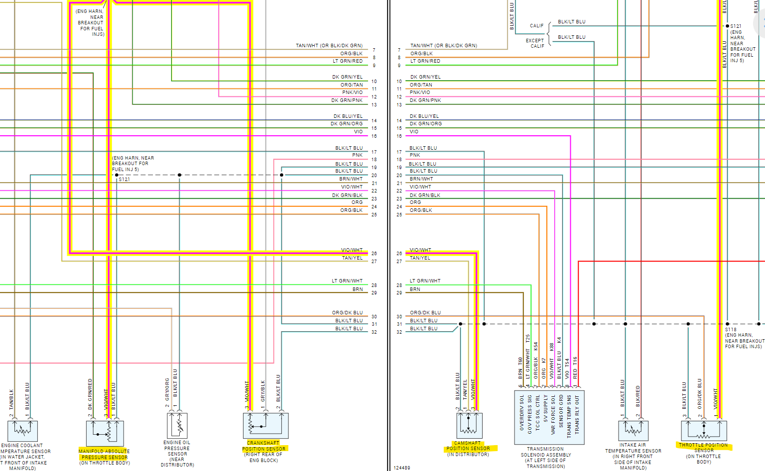

A quick check to see if the PCM is powering up at all is to check one of the 3 wire sensors for a 5volt Reference with the key On. Even checking the Intake Air temperature sensor unplugged should reveal 5volts on one of the wires.
You can check the throttle position sensor, Map sensor, crankshaft and cam position sensors all have a 5volt reference. If one of these sensors has shorted out its 5volt reference, it will pull every sensor's 5-volt reference down, and in turn cause the PCM not to power up.

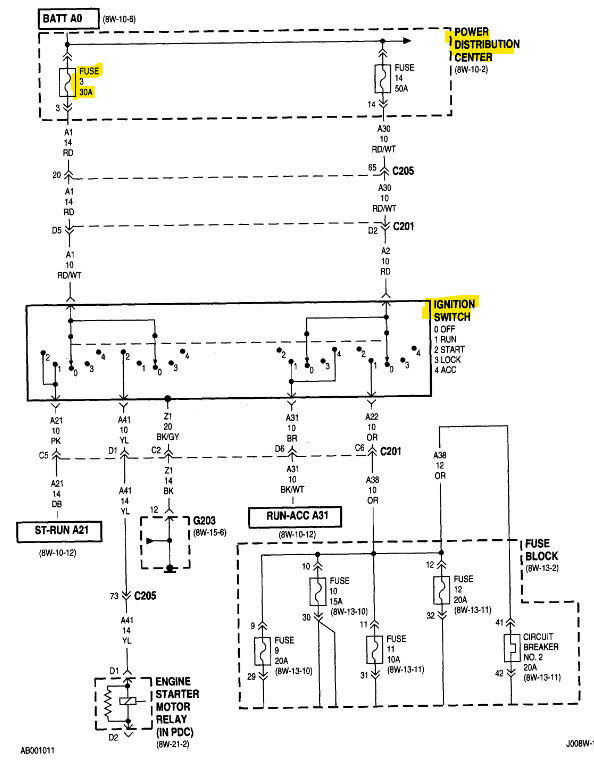

In the 1st diagram there are some fuses to check for power, the ones labelled "Hot At All Times" should have power even with the key off. Fuses 6 20Amp and Fuse 3 20Amp.
The 2nd diagram are the engine sensors you can check with the key on for 5 volts. On the highlighted wire. It is a violet wire with a white stripe on it.

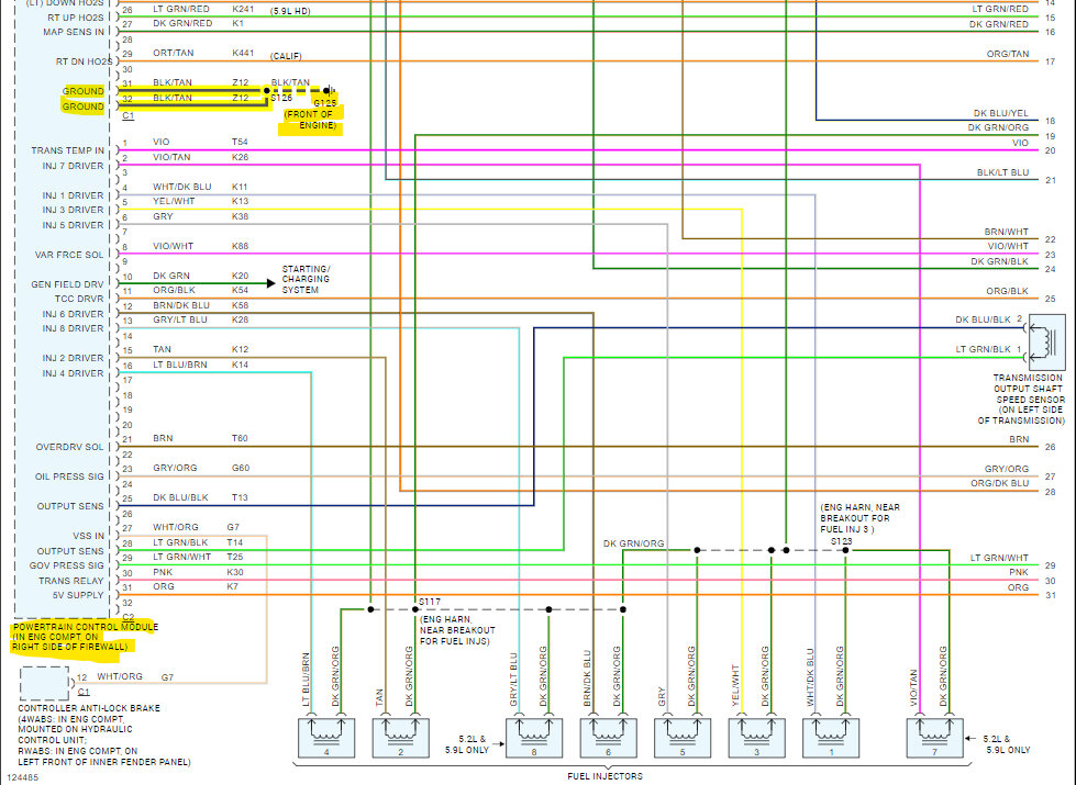

Diagram 3 is the two PCM Grounds located on the front of the engine. I will try to locate it. They are black/tan wires going to the same place.

Use the test light hooked to battery negative, it will put a little bit of a load on the circuits, start by checking those 2 Fuses 6 and 3. You may find they are missing power.
Fuse 3 30Amp feeds the Ignition Switch as well.

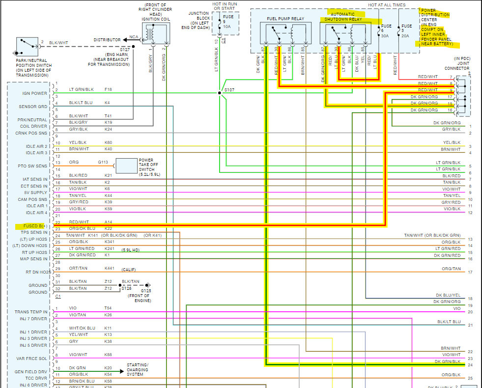

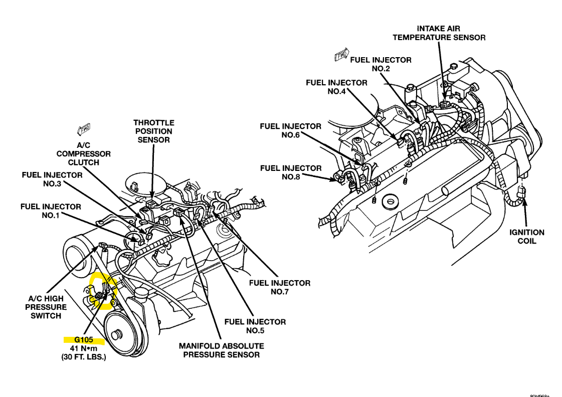

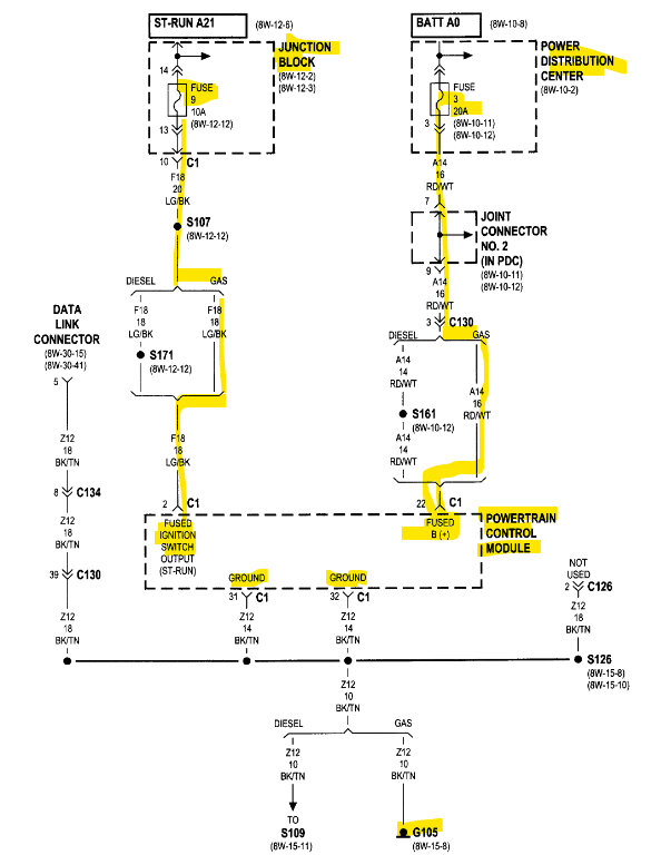

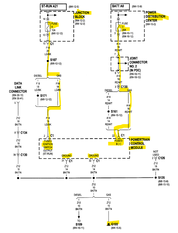

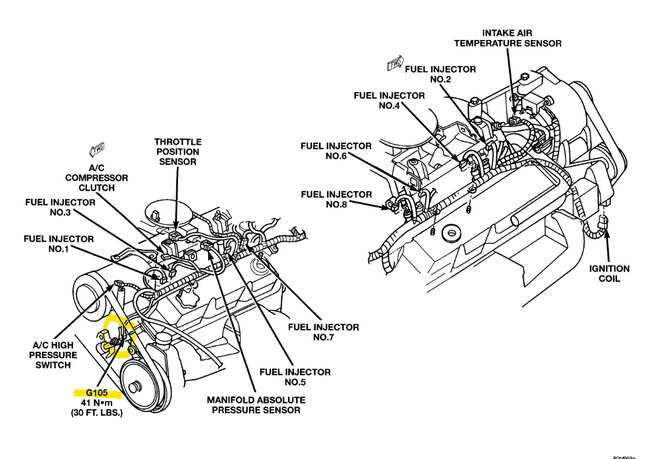

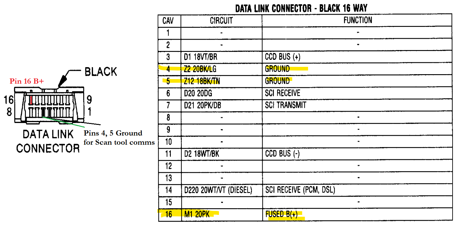

Here are the OEM diagrams, the 1st is the PCM's only Ground location (G105). The 2nd is the Fuse 3 20A may also be an error, It's the memory fuse for the PCM, but I don't think it's located in the Power Dist Center. I believe it's in the interior fuse panel. But diagrams 3 and 4 look correct. And the 5th is the PCM location.
But I think you're looking for a corroded connector or broken wire in this case, just the way the problem progressed.

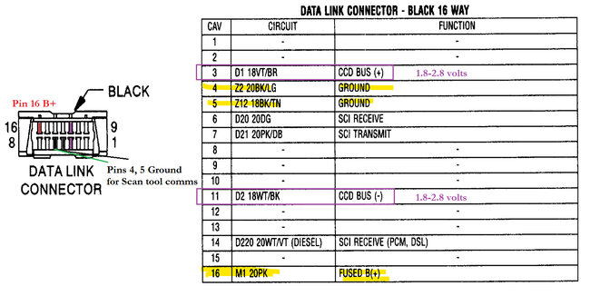

Diagram 6 is the Data Link Connector where you plug in your scan tool, Check for power on pin 16 and Ground on 4 and 5,
When checking just don't push the meter leads into the connector pins, just lightly touch the pins with the multimeter leads, so you don't spread the DLC pins inside. Use pins 4 and then 5 for Ground with the meter, if you get no voltage reading using those pins as ground, Use the vehicle body for ground and see if there is B+ on pin 16. Let us know what you find.

Update: I've checked and found 5 volts at sensors, OBD port has full voltage, fuses are getting power at distribution center.

Did you check the two grounds at the Data link connector as well, pins 4 and 5? Something to keep in mind here is that heat equals resistance, so that is most likely why this issue is happening when it's warmer out. I will post the PCM connectors here for you, and what you should have at each wire. It's odd you're not losing the 5v reference, with communications going down, the PCM would lose those 5 volts as well,

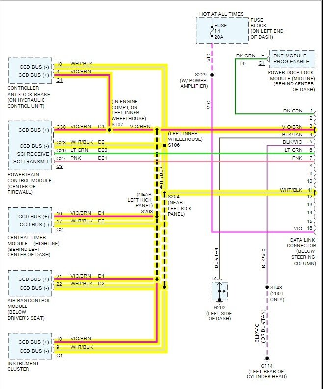

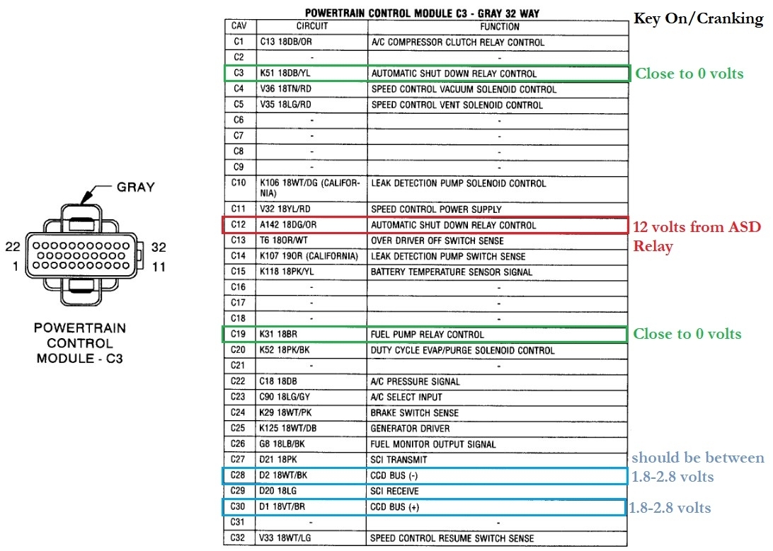

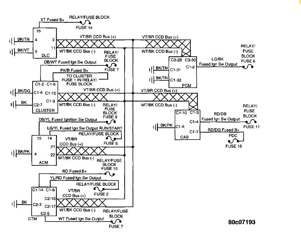

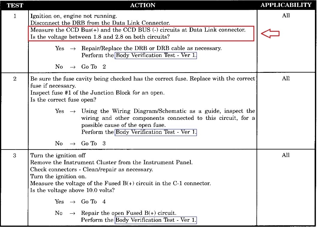

I'm looking over the PCM operations right now, and under PCM Outputs it has listed the "CCD bus (+/-) circuits for: Speedometer, Voltage meter, Fuel gauge, Oil Pressure gauge/lamp, Engine temperature gauge, and speed control warning lamp."
but you are only losing the fuel gauge, correct?
I would also pull the relays out and inspect them for any signs of overheating, pins that look dark, or the relay socket for loose pins. I'm getting these PCM connector diagrams ready for you.

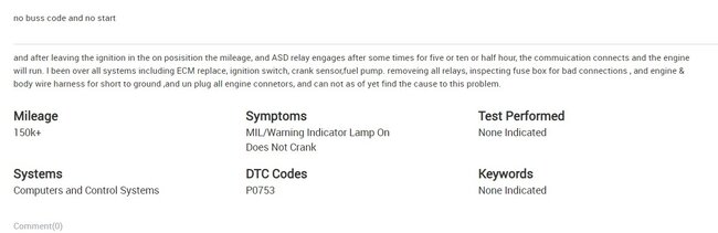

Back story, unsure of its relevance. Last year the CEL worked, and it threw transmission sensor codes. I brought it to AATCO Transmission Repair in Bullhead City, AZ and they replaced the sensors, however when replacing the harness connector at tranny apparently they crossed wires and according to them, fried the PCM, at which point they ordered a new one and installed and Van ran perfect for at least 6 months before this no bus issue occurred. When I got the van I noticed that the check engine light was off and no problems, so I figured it was fixed but now looking back I am wondering if the CEL was defunct since the fix. If one part of the 5v reference was down it would take down the entire system, correct?

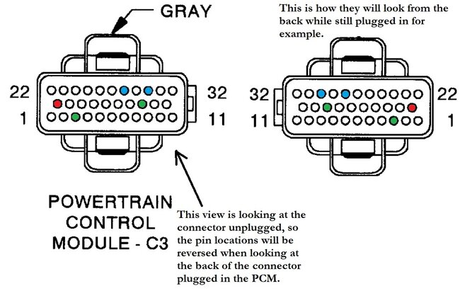

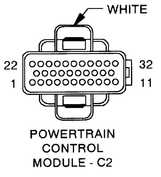

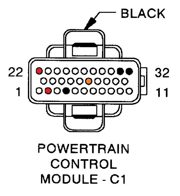

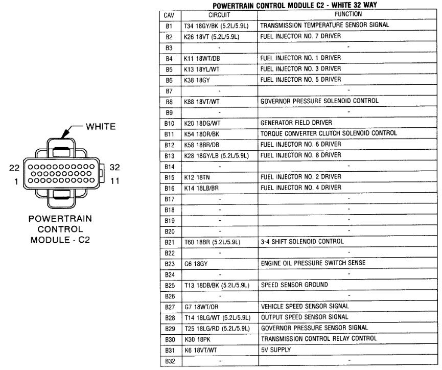

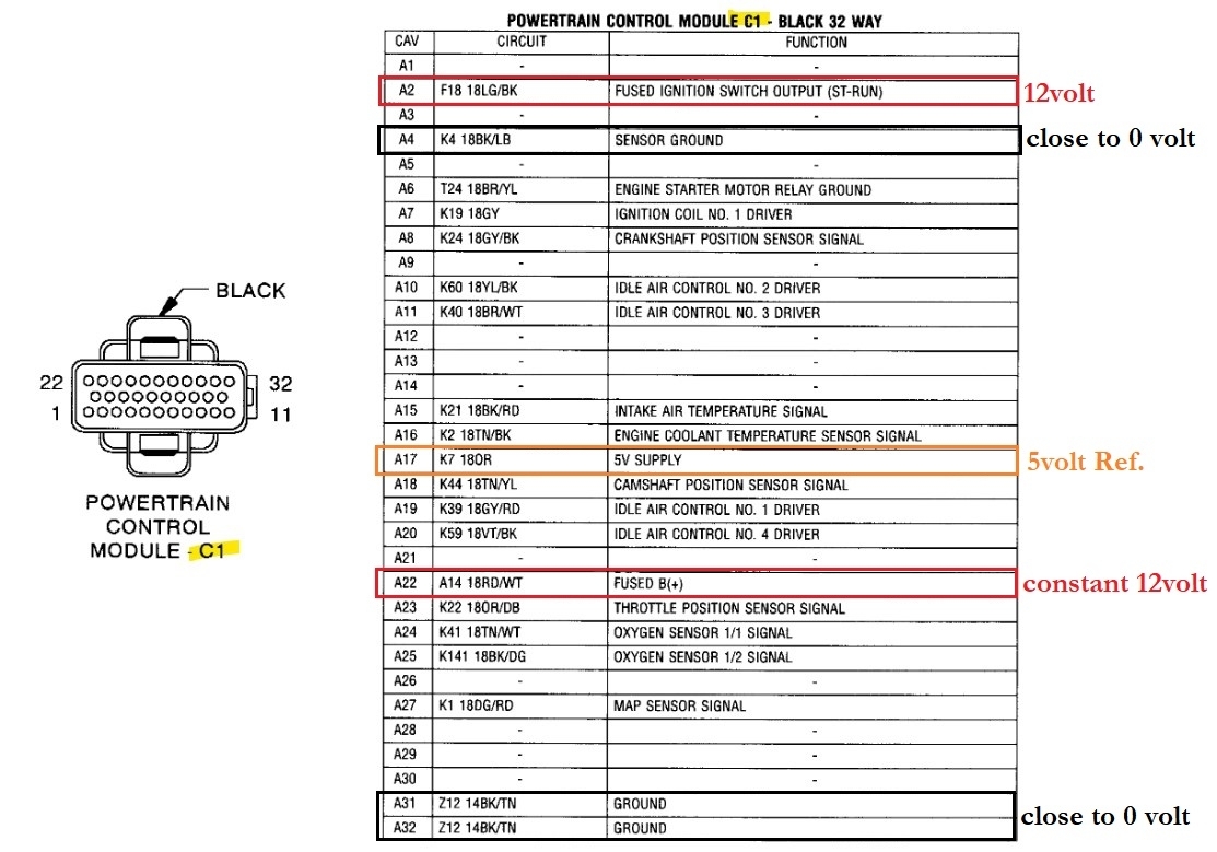

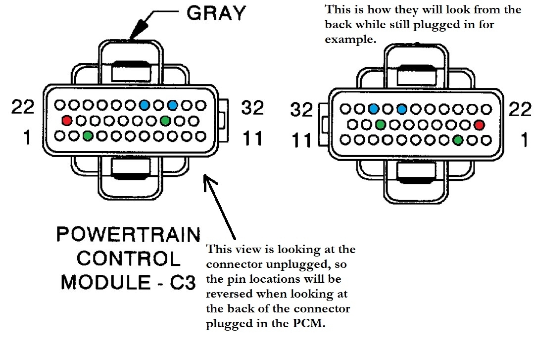

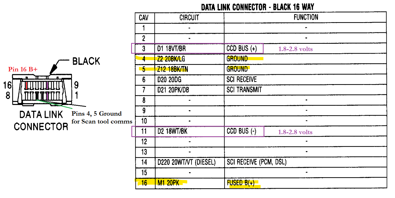

Here are the PCM connector pinouts, diagrams 1-6, diagrams 7 and 8 are for checking for a bias voltage for the CCD network at the data link connector. Service info states the voltage should be 1.8 to 2.8volts on pins 3 and 11.
Another test to do when the fault is occurring, with the key on first, set your multimeter to DC volts with one lead on battery negative and the other on the engine block, then also on the body/frame. This is a voltage drop test on the Ground side of the vehicle. It should be close to 0 volts. Then try it cranking.
Next check with one meter lead on battery positive and the other on the Alternator positive post. Same test, set on DC volts, key On and then Cranking. Should also be close to 0 volts.
If you read anything over 1 volt, there could be an issue with the Grounds to the engine block or body/frame.
Bad frame ground straps, especially the braided types can look okay, but have high voltage drop on them.

Double checked Data Link Connector and both pins 4 and 5 work as ground with positive in pin 16 and I get voltage of 13.

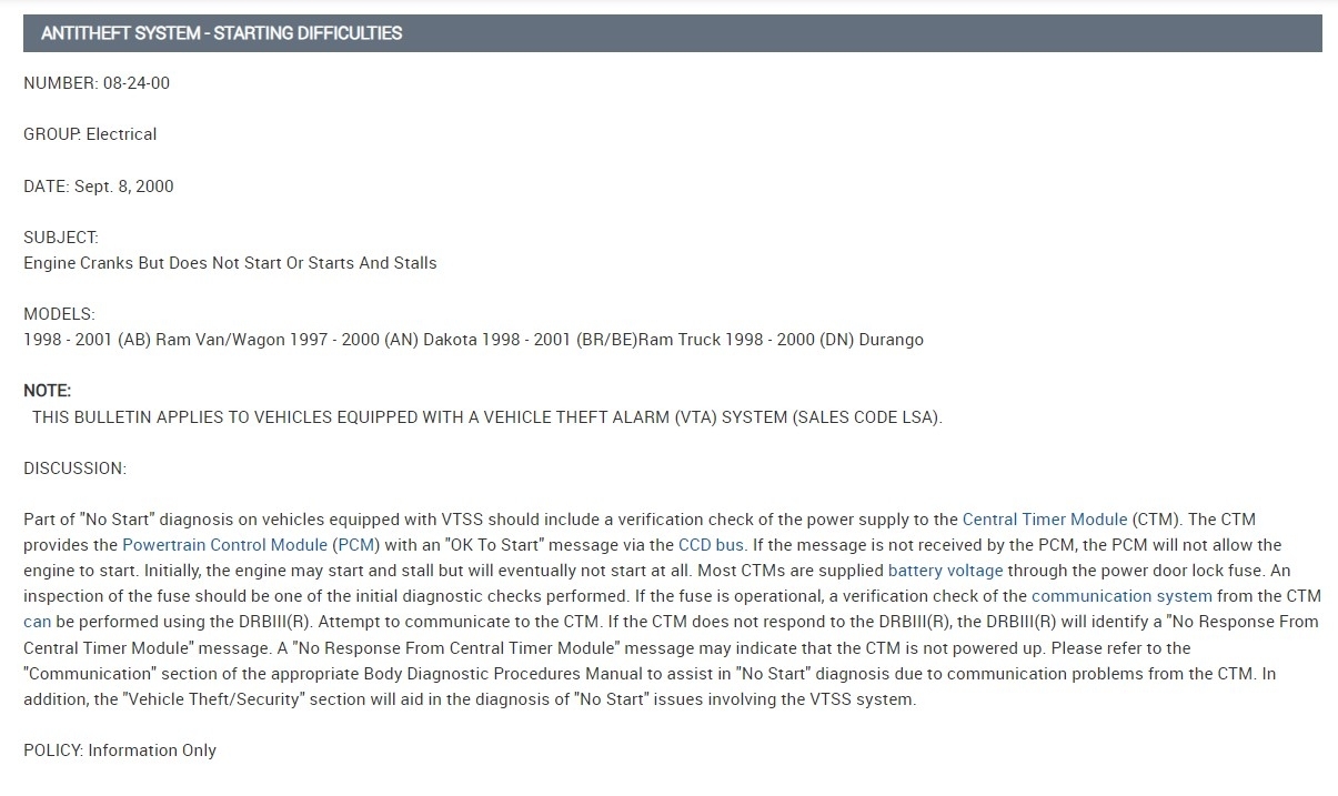

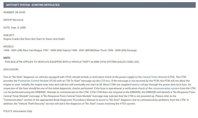

The check engine light should come on at key on every time for 30 seconds or so then go out. If they hooked up power wires to grounds, which is what it sounds like they did, they could have damaged other modules. Do you notice any missing lights on the Cluster, such as security lamp, airbag lamp, brake lamp?
I'd go through checking for any blown fuses using a test light as well. There's a Technical Bulletin for the Central Timer module, which is part of the theft system, so if there's an issue with that module due to a voltage spike or voltage applied temporarily to a ground circuit, it can cause the stalling or starts and stalls.
When battery voltage is hooked up backwards like this shop did, there can be all kinds of issues, who knows if they even tightened up all the grounds really good, and there's loose connections somewhere now, it's really unfortunate that happened.

DLC pins 3 and 11 read 3 volts, ground test shows 0 volts, they had no idea which wires were crossed and upon inquiry I found out they fired most of their employees not long after they did my van so no luck getting info on what actually happened other than it was one of the wires in harness at transmission.

This van has manual window and door locks and as far as I know, no active security system. Upon checking fuse panel there is no CTM fuse in its labeled spot.

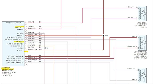

My concern with them shorting out who knows what, would be other modules, the Cluster communicates on this CCD network to the PCM as well, so they must have replaced the transmission connector pigtail, cut the wires, then using crimp connectors to attach the new connector and that's where they went wrong. In that case I would even be worried about how well they crimped the wires together. Are there visible wires crimped together? If they didn't use the heat shrink type connectors to keep moisture out, problems will start to show up eventually, I'm just looking over the transmission wiring to the PCM and Cluster. I'm just looking for a reasonable explanation to why issues are showing up a half year later.
You're getting the no bus message with just the key on right now?

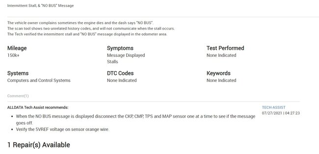

There's a couple other case studies with the same exact symptoms, so with nothing on the Cluster working, the no start condition, a no bus message and no scan tool comms, this looks like the network is down, and it doesn't have to be the PCM that's pulling it down, it can be any of the modules on it. When you were reading the 3volts on the CCD wires, was that measuring each pin to ground separately? Or was it across pins 3 and 11?

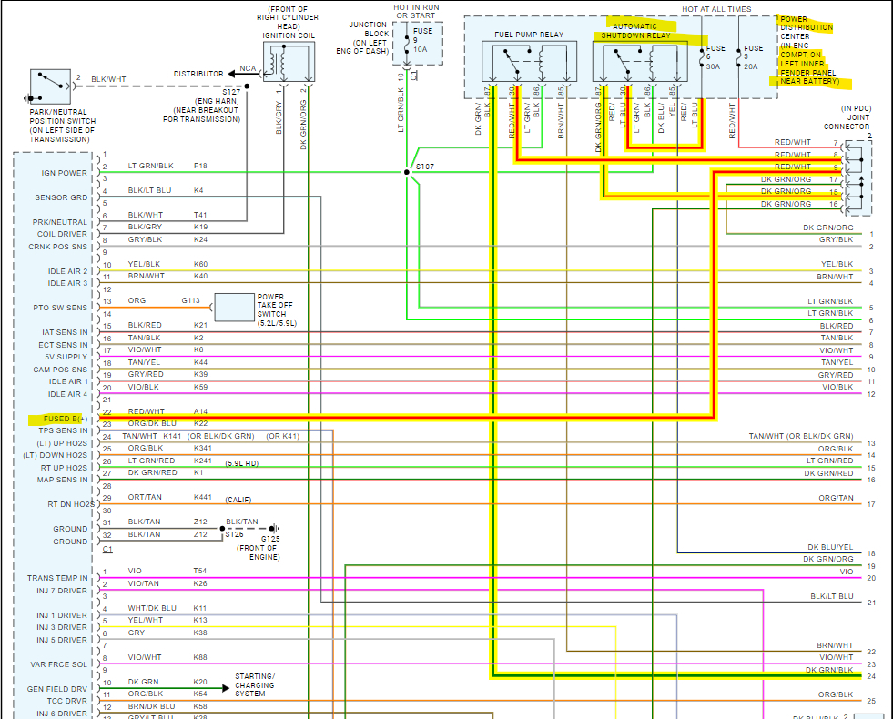

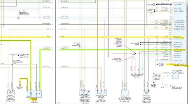

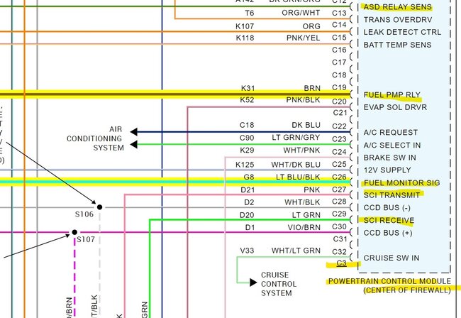

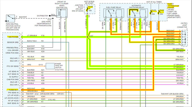

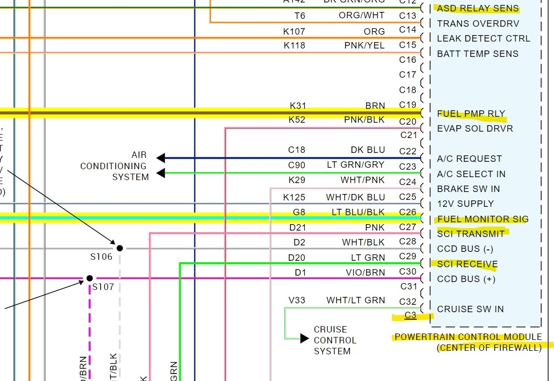

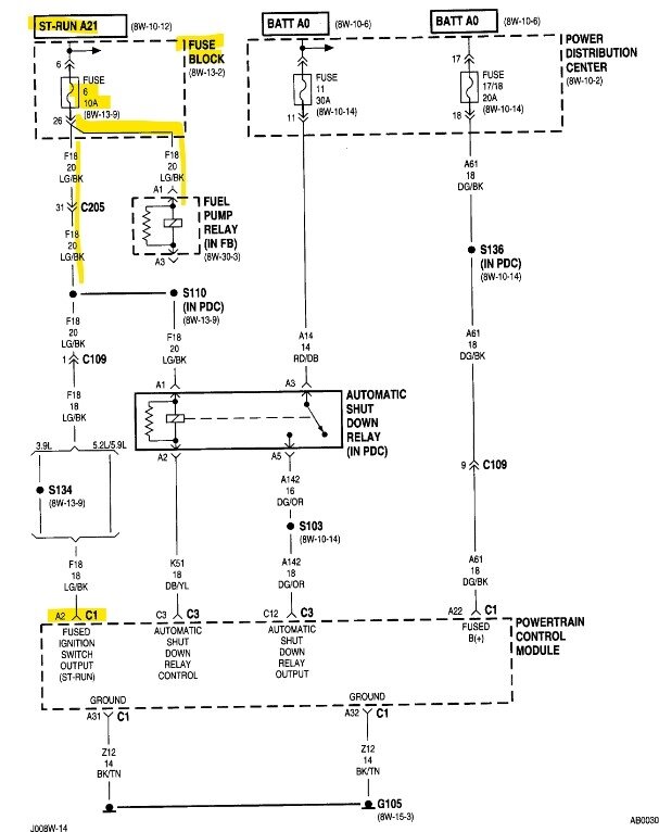

Okay, well that's something, A22 is a constant feed to maintain the memory in the PCM, A2 should come on with the Ignition switch, the power comes from Fuse 9 10amp in the Junction Block fuse panel, I believe that is the fuse panel inside the vehicle.
Now the 5v Ref at A17 goes to the throttle position sensor on the throttle body, but also branches off to the MAP sensor, the crankshaft position sensor, and the cam position sensor that is inside the Distributor.
Are you checking A17 with the PCM disconnected, or are you back probing the connector with it plugged into the PCM? The 5v ref comes out of the PCM, so if it's unplugged you won't read anything.

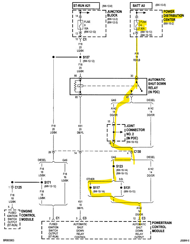

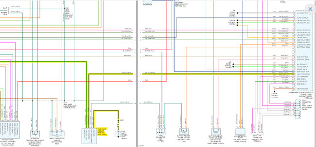

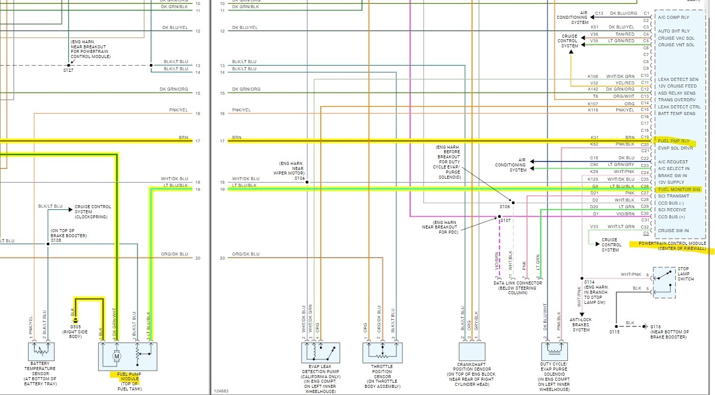

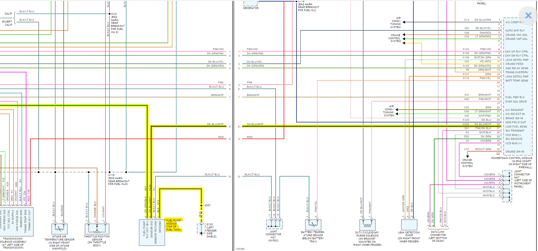

The 3rd diagram is of Fuse 6 10amp which feeds the fuel pump relay, the ASD Relay and PCM C1 A2, there are a couple of connectors in between the fuse panel and PCM. So, check Fuse 6, I believe this is the fuse block inside the vehicle.
Even some of these OEM diagrams are incorrect but let's start at Fuse 6. This will prevent the PCM from powering up, and it can prevent just a section of the PCM powering up. Some of these are designed like that. Where they have multiple power inputs.

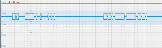

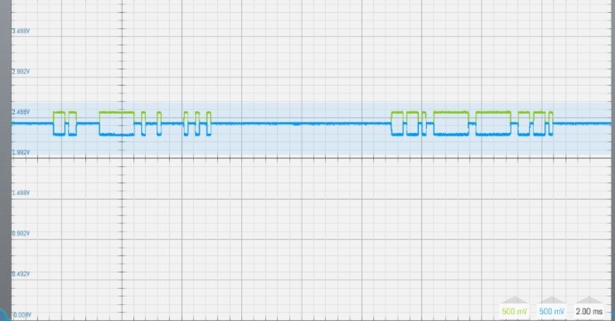

Below I found some waveforms of the CCD data bus signal, but we'll get to that later.

I had it disconnected so I will need to re-test. This is the farthest I have ever ventured into the world of electricity, so I am learning as we go. Those symptoms sound pretty much identical, I took the bulb out of the dash for the CEL and switched it with Cruise bulb and now neither work so running to AutoZone to get new bulbs, it's cooler today so I've gotten it to start a few times and now the ABS light and Brake lights are on?

Okay, maybe it's the ABS module faulting the network, if you can get to it easy enough, you could try unplugging it, make sure the key is off first, unplug it and then see if the ABS out of the loop makes any difference. If this is in fact a network fault, we would try unplugging some modules to restore the network, and this vehicle only has a few modules. So, give that a try, either the ABS module is the fault, or that's another symptom of a network fault.

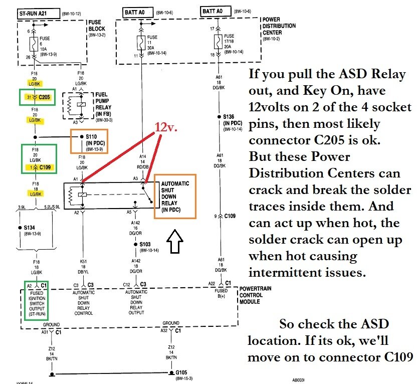

Technically though, even without PCM C1 plugged in, it looks like you should still have power on A2. Since that comes from the ignition switch I wonder if Fuse 6 is blown.

Put new fuse 6 interior panel no difference. There appear to be two harnesses on top of the ABS, should I unplug both?
Mar 16, 2024 at 9:09 AM
AL514
  • 5,610 POSTS

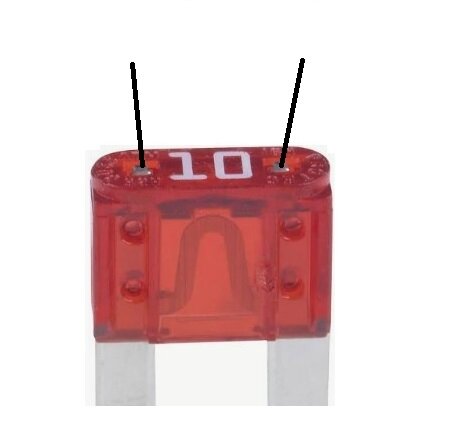

Is there power at Fuse 6? And the ABS module has a 4 wire (C2) connector and a 14 wire (C1). You can just unplug the 14-wire connector, the 4 wire is just for the two front wheel speed sensors, it has nothing to do with the network. We just need to see if it's messing with the network, the ABS and Brake lamps probably came on because the PCM connector was disconnected. There is probably a code set in the ABS module for loss of communications with the PCM or the vehicle speed sensor, but make sure to be easy on these connectors, they are old and haven't been disconnected in a long time and the wiring can be brittle.

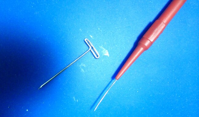

If you don't have any back probing pins, you can use a T pin as well. This red pin will fit right onto a meter or scope lead, but both of these are small enough to carefully back probe connectors so the connector pins don't become spread apart and will not make good contact after. So, if you take the cover off the back of the PCM connector the wires will be visible, and you can access them that way.

With key on Fuse 6 reads 12.25 top 1.31 bottom.

Removed 14 wire harness from ABS, no difference there. Checked connector at Crankshaft Position sensor, it read 5v, not sure how to test Crank pos sensor itself but removing made no difference.

What do you mean about the fuse? Are you reading 2 different voltages on either pin? You can plug the ABS back in.
Mar 16, 2024 at 10:07 AM
CAPTAIN KURTZ
  • 42 POSTS
I pulled fuse 6 and checked the ports that the fuse plugs into, that's where those readings come from. 12 was top 1.3 was bottom.

Okay, if you have battery voltage at Fuse 6 and not at A2, we need to figure out why, there's 2 connectors in series to the PCM, connector C205 pin 31, then a Splice S110 that is inside the Power Distribution Center (PDC) which branches off to the ASD Relay, then connector C109 pin 1. It's a light green/black wire the entire way. I will find these connectors.
