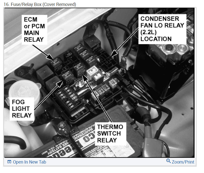

Engine is a NPR diesel . After removing and installing injector pump to access oil cooler my truck will not start. I removed and installed pump following timing mark instructions. Marks are spot on. I was unable to prime using the hand pump so I filled the fuel filter up and let it bleed the line to the pump by gravity. I verified the fuel cutoff solenoid is working correctly by removing the back pump cover and applying 12 volts DC. I have no fuel at the injectors and no voltage at the glow plugs. When removing the line from fuel filter to pump I can see there is fuel in the pump. The injector pump has a one wire connector to the solenoid on top and a 4-6 wire connector going to the bottom of the pump. the pump model # is Zexel107492-1080T. Any suggestions appreciated and also where is the EFI relay located please?

Here is a guide to help test the EFI main relay and the location in the diagrams below:
