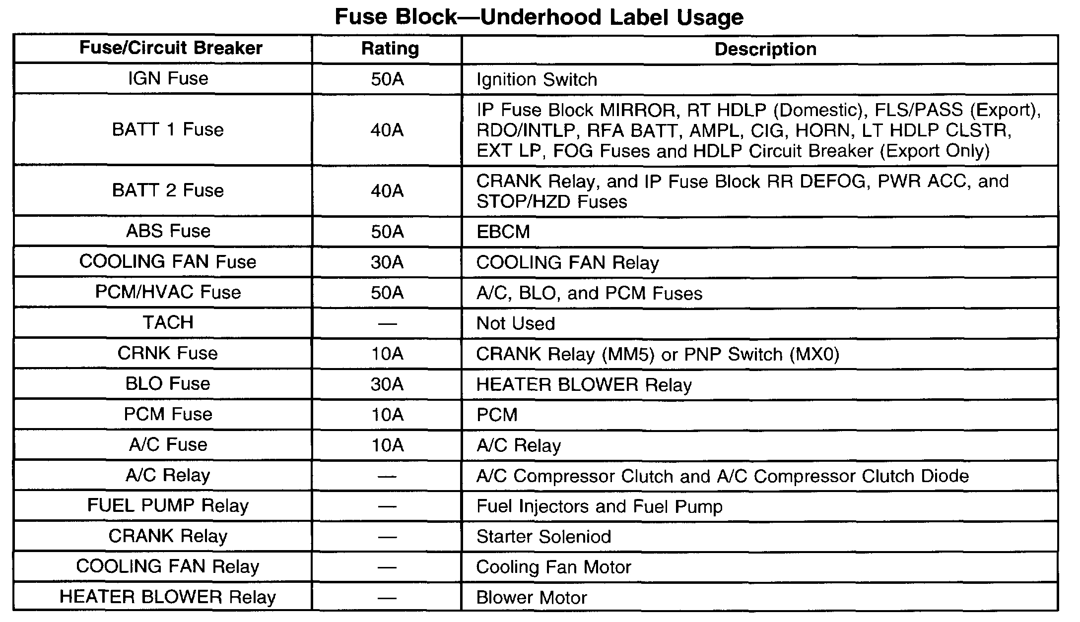

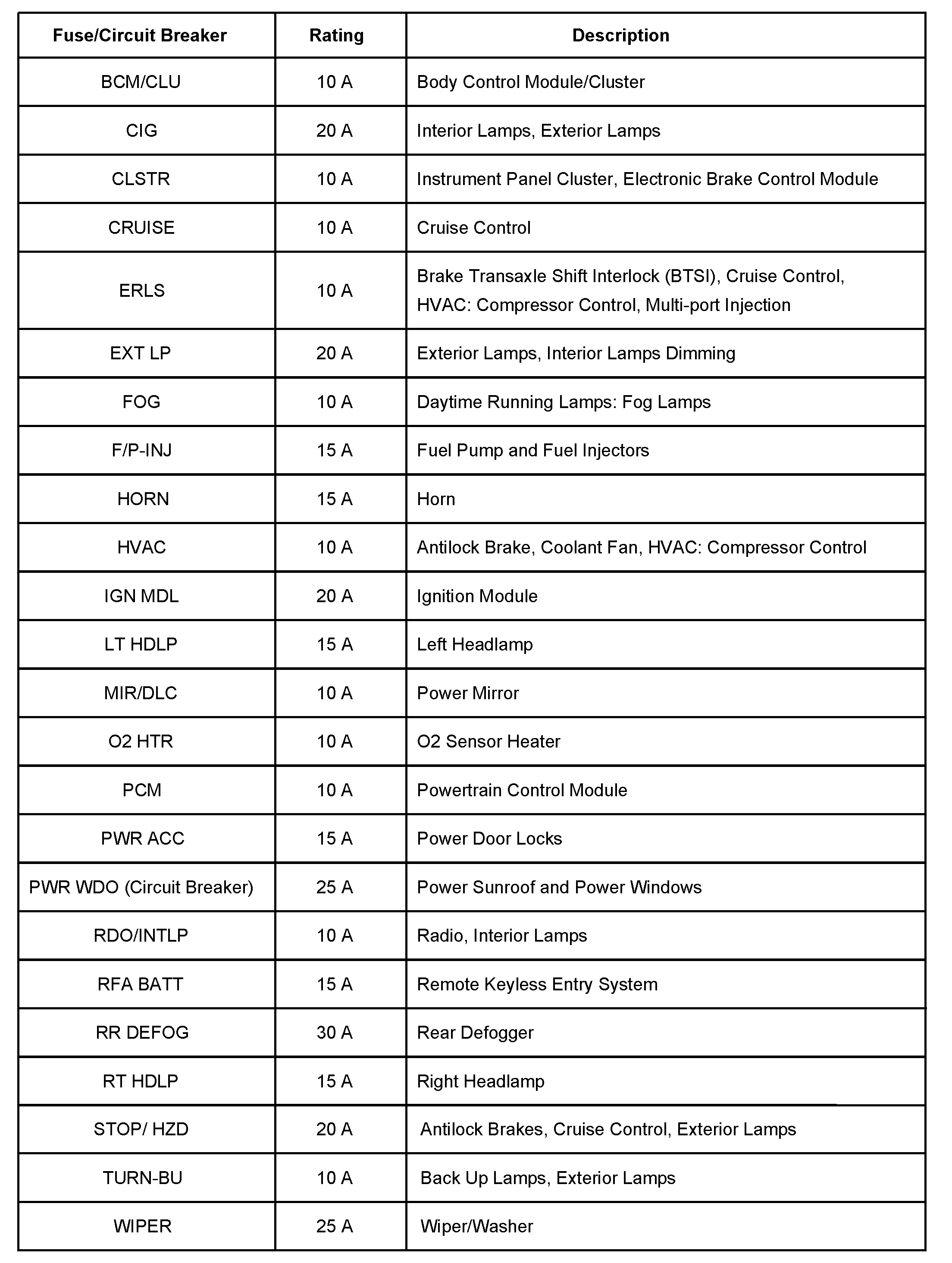

Spray fluid in starts. Pump is good no codes show up no codes stored. This is ecotec. I have tried to go through theft sequence not getting anywhere. Also have read three versions of this key on and off for ten minute intervals. Should I be looking at something else and if you think is vat? Please tell me right way. Thanks
Aug 13, 2018 at 7:52 AM
  • 110,248 POSTS

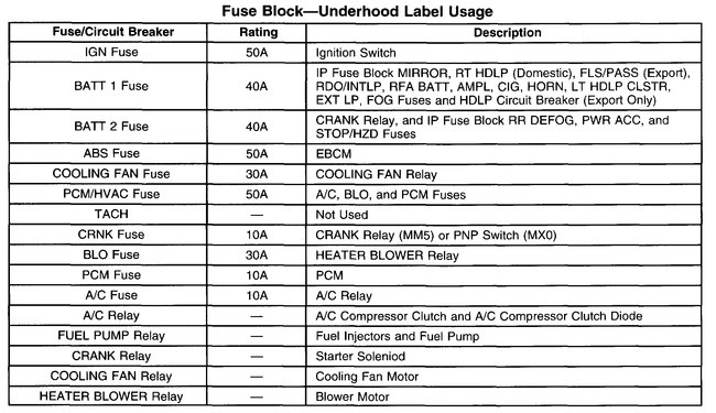

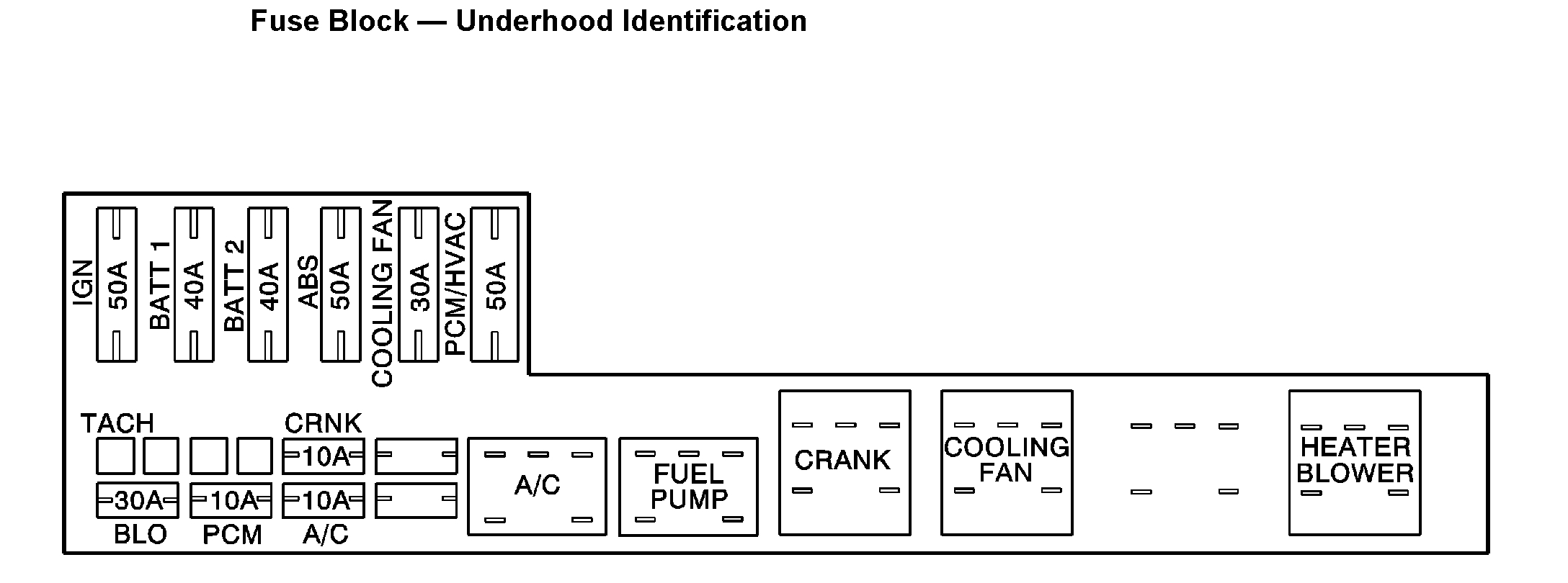

If you tried the sequence of allowing the key on for ten minutes and the anti-theft light is not flashing, then I think you have a different problem. Since it is fuel related, I will assume that the pump is producing pressure within the manufacturer's specs. However, I want you to check something. There is a relay in the under hood relay box which is for both the pump and the injectors. I want you to switch that relay with a different one from the box that has the same part number. I have attached pictures of the relays, locations, legends for you to see.
Next, if you did not actually check fuel pump pressure, I would recommend doing if even of you hear the pump engage. It may be too low. And finally, I want to know if the injectors are getting power. Here are two links which show how to check pressure and the injectors:
https://www.2carpros.com/articles/how-to-test-a-fuel-injector
The manufacturer's specs for pump pressure:
Fuel Pressure (Key On, Engine Off) 345-414 kPa (50-60 psi).
Jun 16, 2021 at 8:35 AM
BILL STRATHERN
  • 8 POSTS
The injectors and pump are not working. Tested the pump which is new it works. There for no pressure to front rail. Theft light is out I put new relays in pump spot and crank spot. Did not check regulator with no pressure.
  • 110,248 POSTS

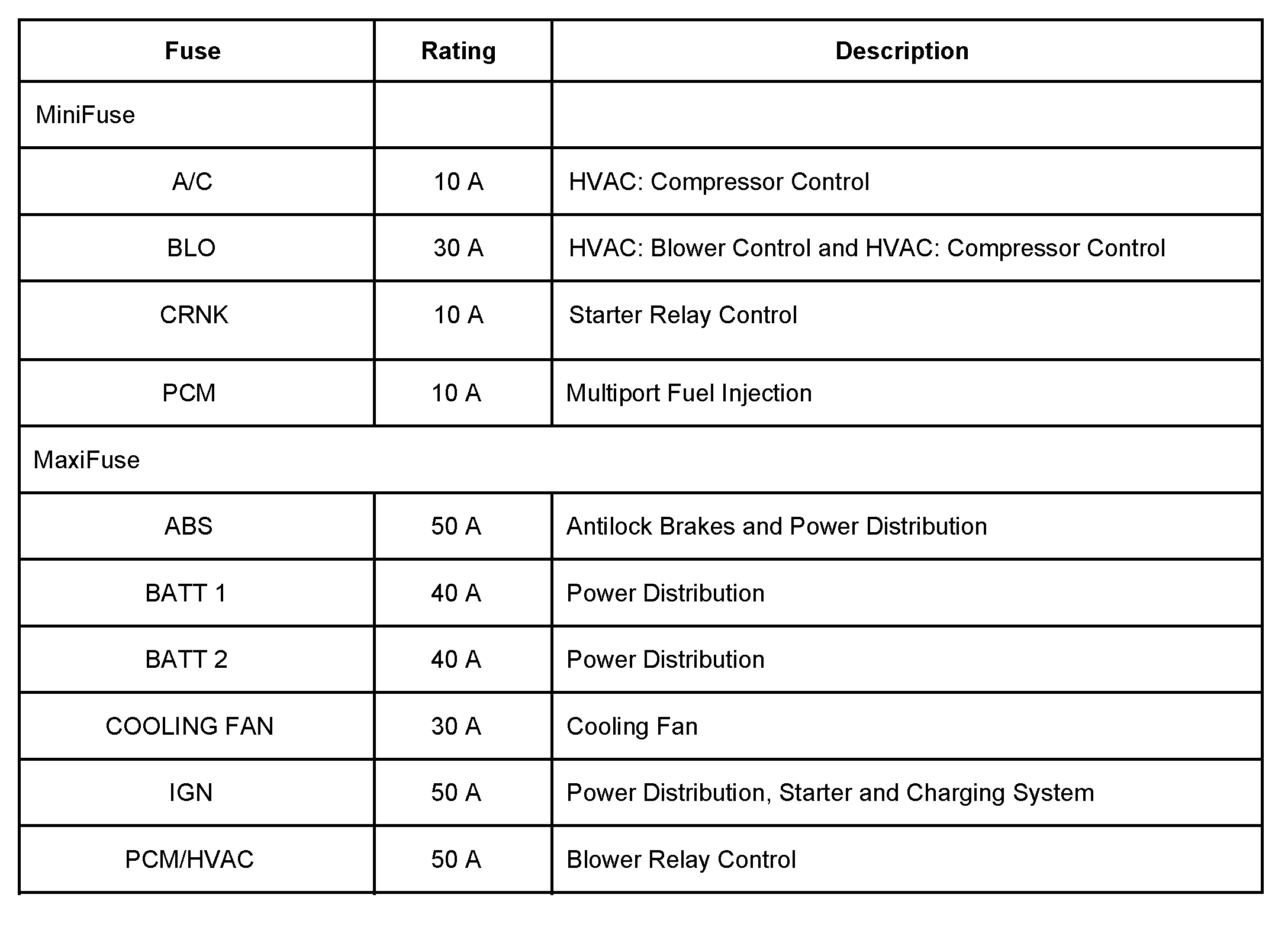

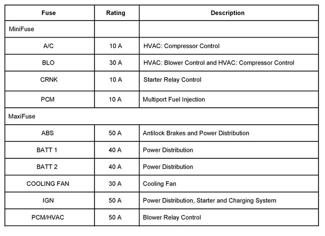

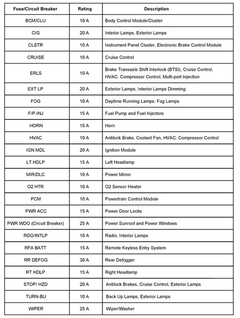

Have you confirmed fuses are good? There is a fuse designated for the injectors / fuel pump. If the fuse is good (check for continuity to confirm) make sure there is power to the fuse. See attached.
BILL STRATHERN
  • 8 POSTS
Fuse was bad I replaced it. Now it runs thank you.
