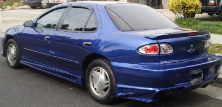

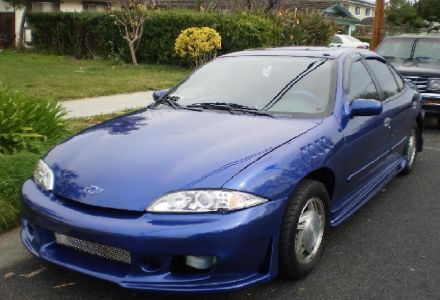

And Cavalier's were hardly ever considered bottom of the line cars, they last great when properly maintained and taken care of and are very popular for fixing up and racing or using as show cars. They can also be quite powerful if you were lucky enough to get one with the Z24 sport engine and know how to tune it up.
http://www.2carpros.com/forum/automotive_pictures/510743_P2280019__s_1.jpg
http://www.2carpros.com/forum/automotive_pictures/510743_P2280021__s_1.jpg
http://www.2carpros.com/forum/automotive_pictures/510743_PC030027__s_1.jpg
