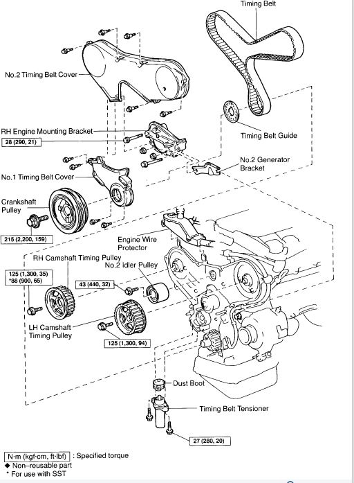

The car cranks, there is enough sparks on the plug and coil, there is current on the nozzle i have clean up the throttle mouth but the car wont start it comes to crank.

Yes it did prompted cam and crank sensor which we have replaced. we have also set the timing severally, the fuel system has be inspected too. but still it keep cranking without starting.

If you have Cam and Crank sensor correlation codes then most likely the car is out of time, meaning the timing belt could have broken.
This can be bad for the engine because the valves will then contact the pistons and can bend all the intake and exhaust valves causing internal engine damage.
Can you check the timing belt? Remove the belt cover to see if the belt turns when the car is cranked over?
I attached the printout showing the upper timing cover. You should be able to remove this easily.
Can you take a compression reading on the cylinders? If the compression is low, you would then have to check the timing.
