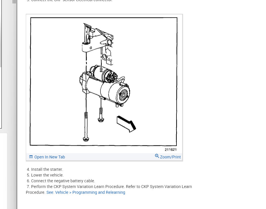

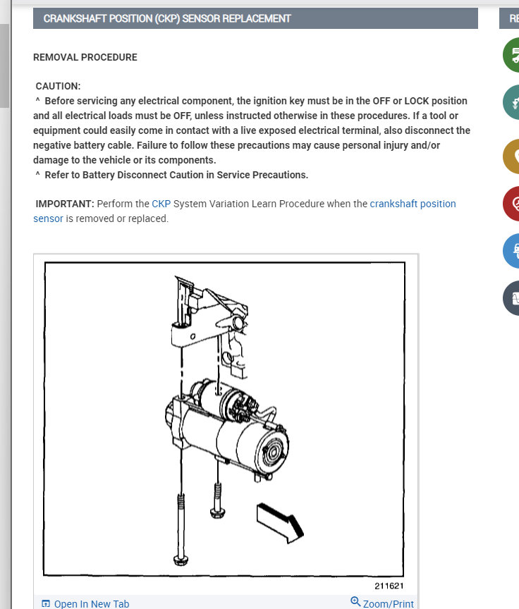

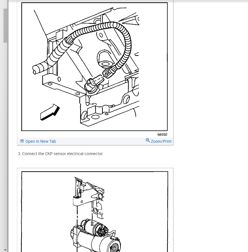

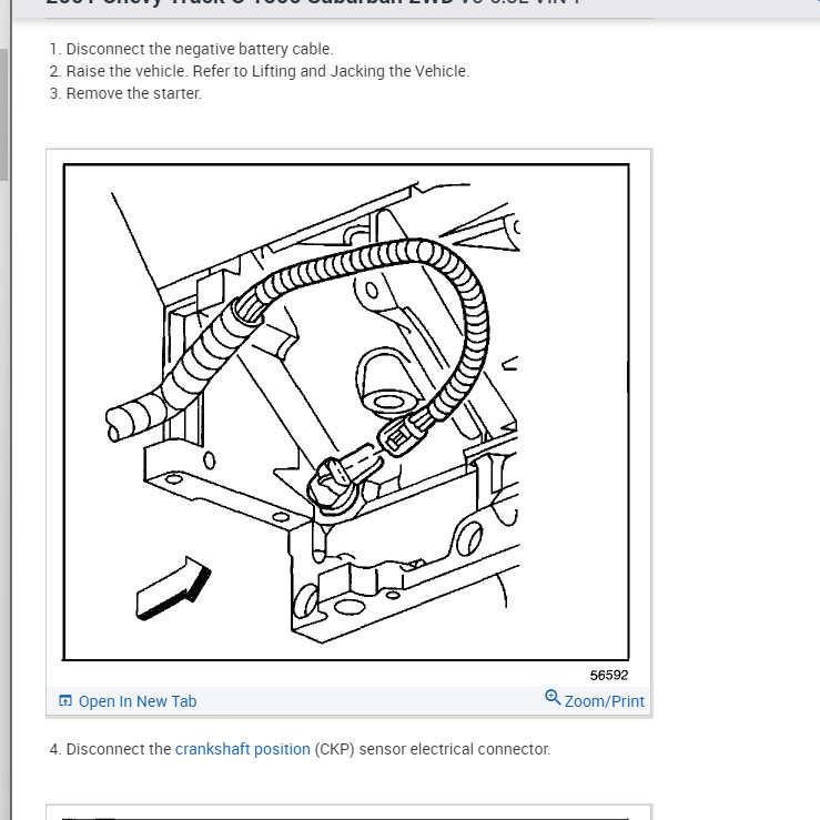

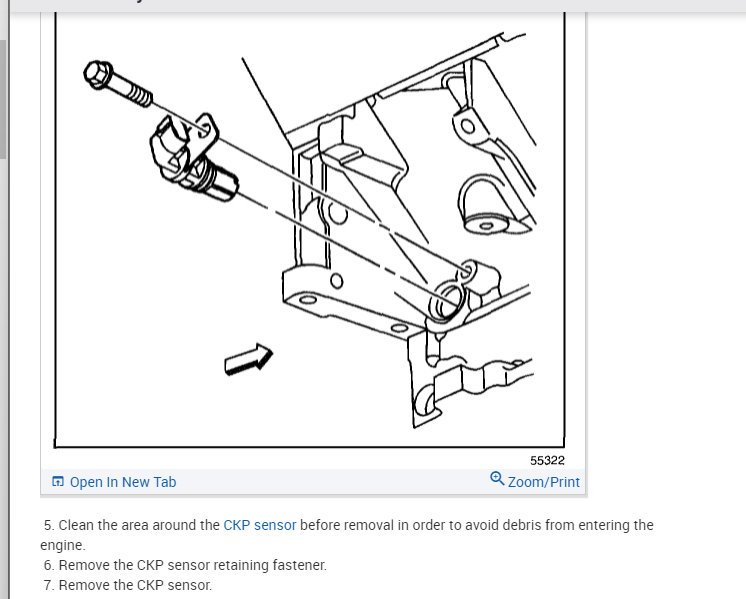

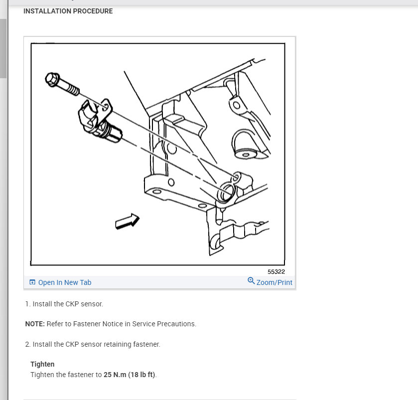

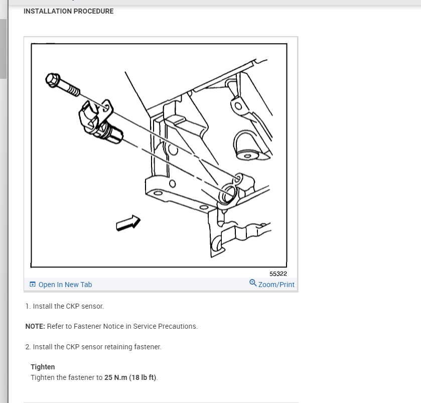

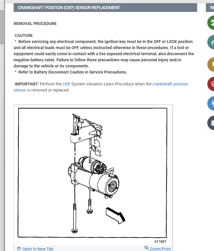

I have a 2001 Chevy Surburban LS 4WD 5.3L VORTEX Engine. I am looking for the Crankshaft Sensor to replace. Apparently, some people think it's below engine, others above engine behind intake manifold. Does any body truly know where it is please help
Wednesday, March 27th, 2019 AT 12:34 PM (Merged)
  • 52,797 POSTS
It is behind the starter.
I am attaching the process from the manual that will help with this.
