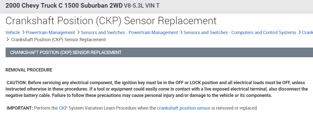

About a week ago my truck died, and will restart and run for approx 5 min before throwing a P0336 Crank Position sensor code and dying again. I have since replaced the sensor with a GM AC Delco crank sensor, and now I have a no start issue. I have read that the PCM needs to go through a relearn process, but would that actually keep it from starting at all? PCM is still showing the P0336 code even after resetting the PCM. Any advice would be greatly appreciated.
May 12, 2014 at 1:30 AM
  • 110,241 POSTS
Sometimes the crankshaft sensor must be relearned here is a video of the job being done and instructions on how to do the job below.
https://youtu.be/sKo7xRWVNqY
IMPORTANT: While the learn procedure is in progress, release the throttle immediately when the engine starts to decelerate. The engine control is returned to the operator and the engine responds to throttle position after the learn procedure is complete.
1. Connect the scan tool.
2. Apply the vehicles parking brake.
3. Block the drive wheels.
4. Close the vehicles hood.
5. Place the vehicles transmission in Park (A/T) or Neutral (M/T).
6. Idle the engine until the engine coolant temperature reaches 65°C (150°F).
7. Turn OFF all the accessories.
8. Apply the brakes for the duration of the procedure.
IMPORTANT: If the CKP System Variation Learn Procedure cannot be completed successfully, refer to DTC P1336 Crankshaft Position (CKP) System Variation Not Learned for additional diagnostic information.
9. Use the scan tool in order to enable the Crankshaft Position System Variation Learn Procedure.
10. Slowly accelerate the engine speed to 4,000 RPM.
11. Immediately release the throttle when the engine speed decreases.
12. Turn OFF the ignition for 15 seconds after the learn procedure is completed successfully.

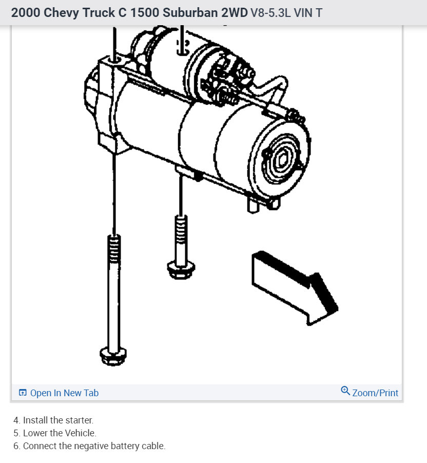

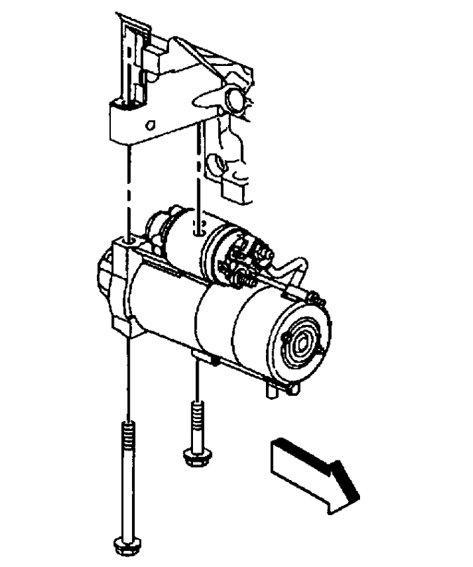

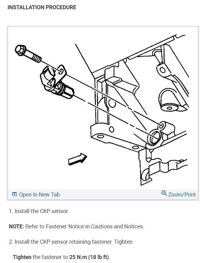

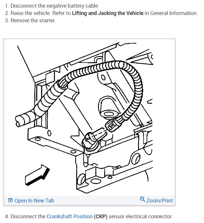

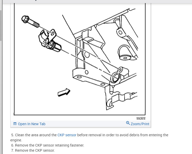

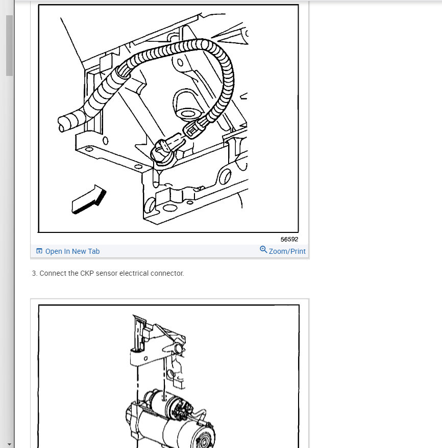

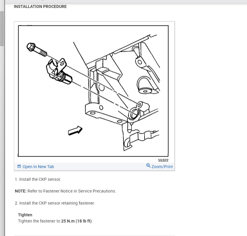

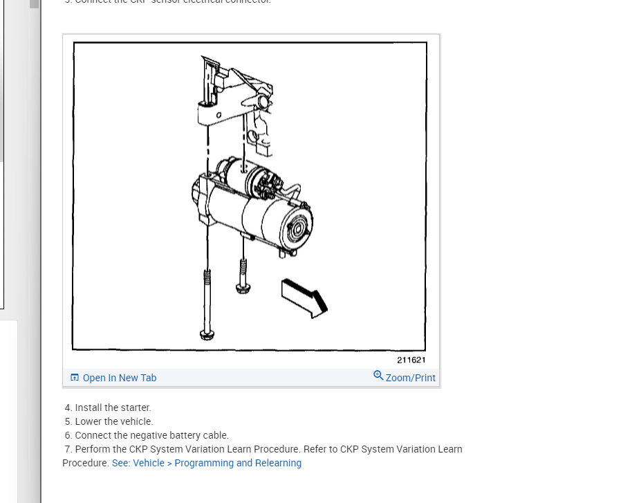

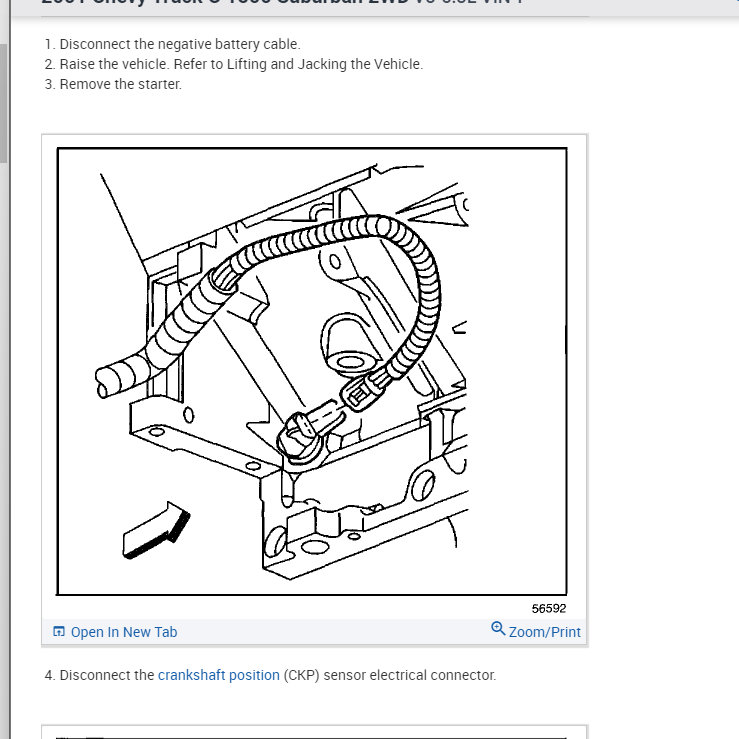

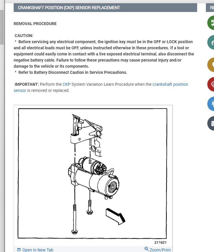

I have a 2001 Chevy Surburban LS 4WD 5.3L VORTEX Engine. I am looking for the Crankshaft Sensor to replace. Apparently, some people think it's below engine, others above engine behind intake manifold. does any body truly know where it is please help
Mar 27, 2019 at 5:34 AM (Merged)
It is behind the starter.
I am attaching the process from the manual that will help with this.
