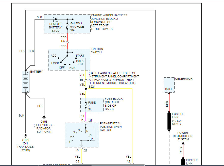

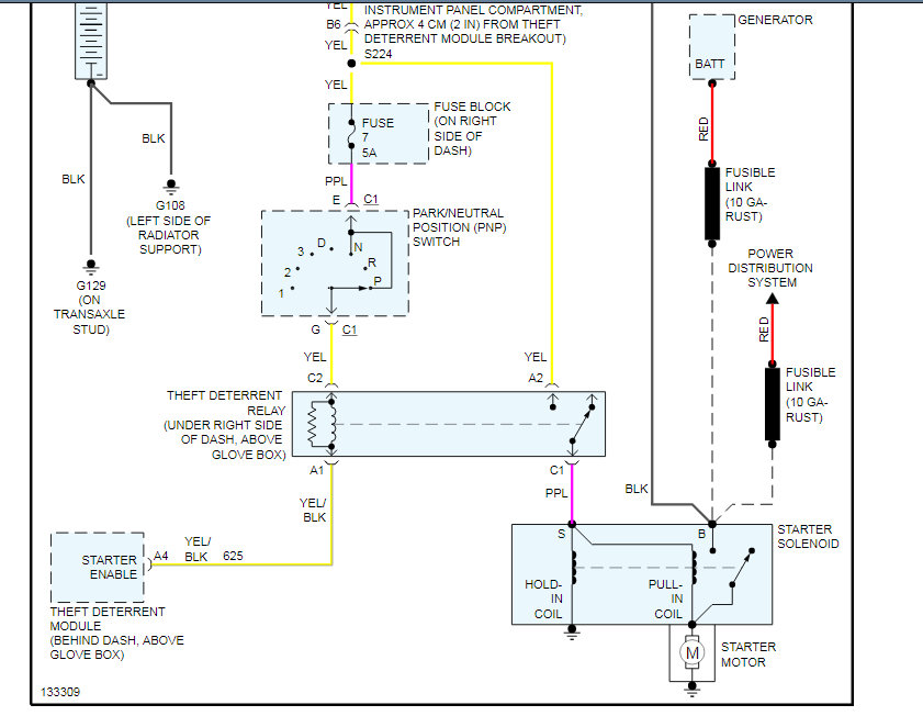

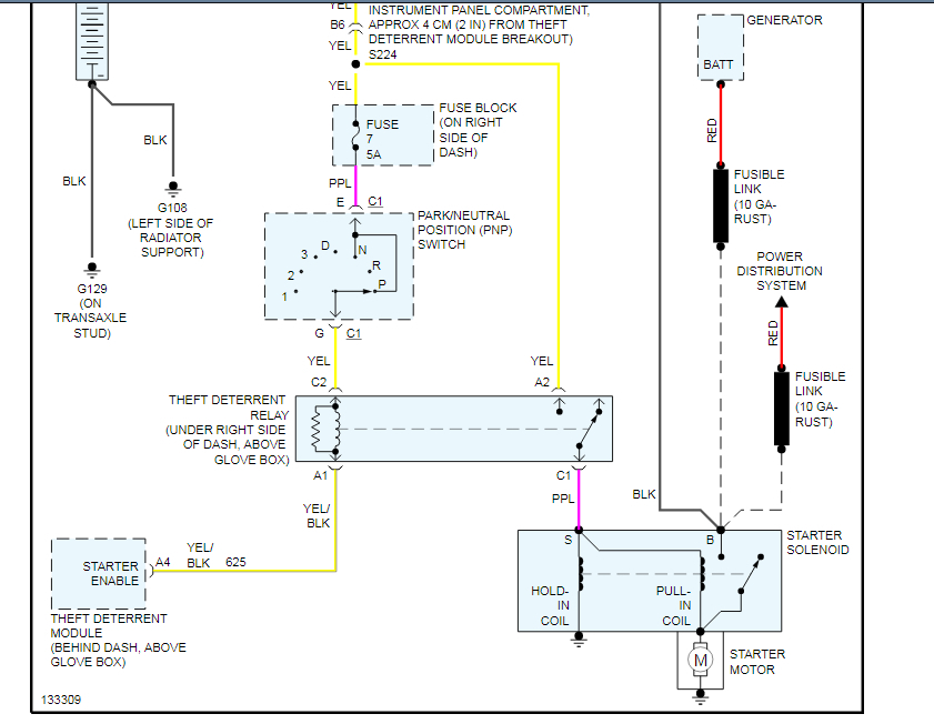

The battery and starter are both new. It began acting up, cranking most of the time and then not. Turn it to the on position and everything comes on. Go to crank it, no sound except for the fuel pump doing its thing and nothing else. At first it was a security problem, which was easily remedied with another key from a nearby dealership. Now, it's doing the same thing, but the security light no longer flashes. Any ideas?
Oct 22, 2019 at 1:12 AM
SCGRANTURISMO
  • 4,897 POSTS

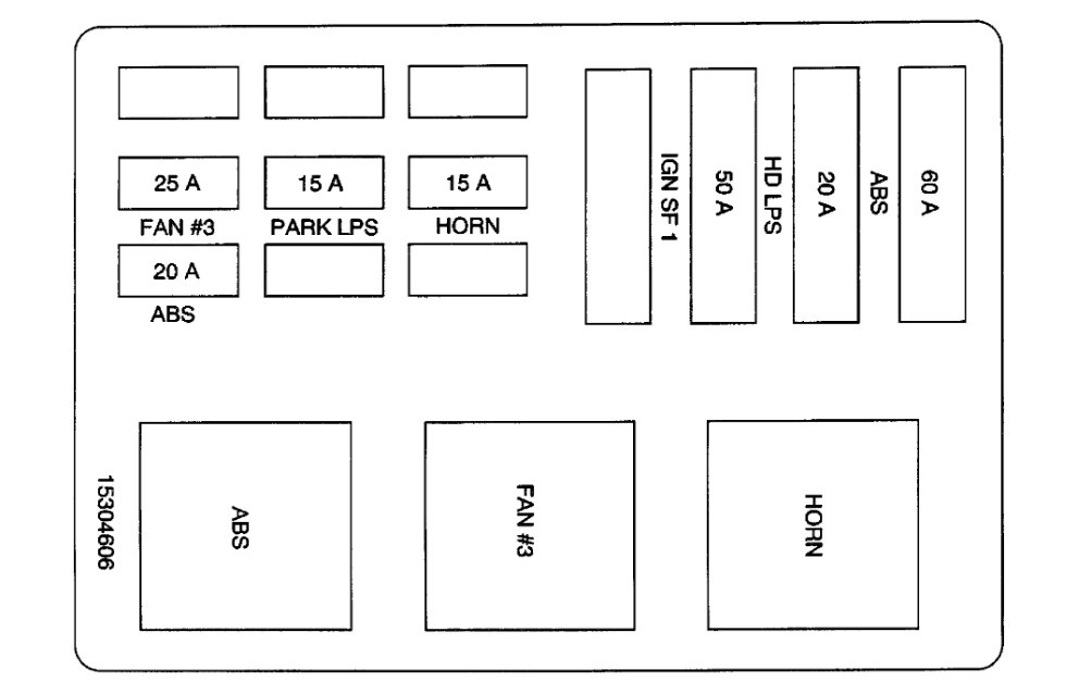

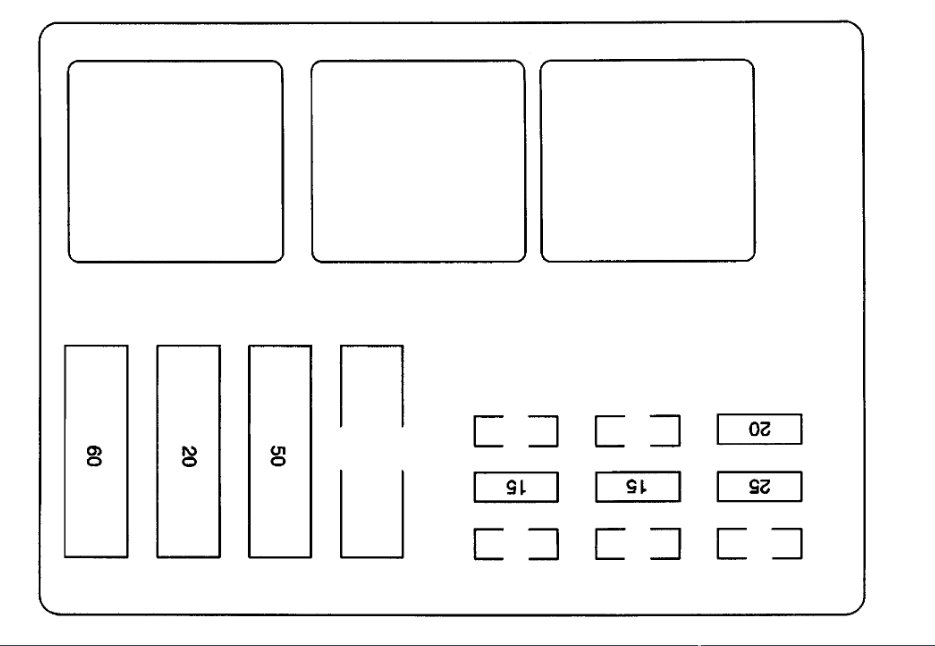

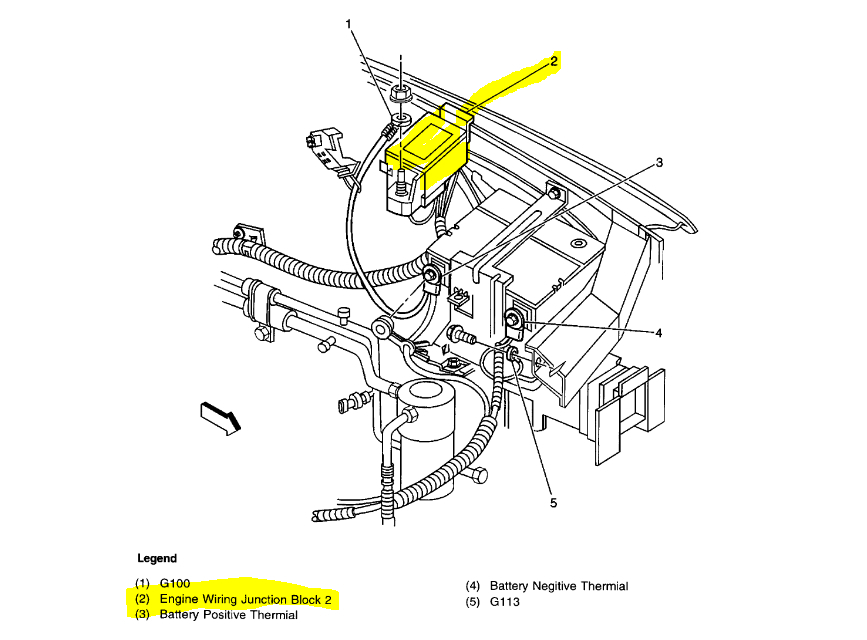

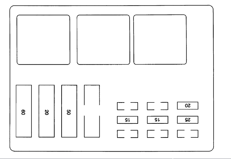

Okay, in the diagrams down below I have included a wiring diagram of your vehicle's starting circuit and the location, diagram, and callout of your vehicle's Engine Compartment Junction Box 2. Please check the IG SW Fuse 1[50A]. Here is a link describing how to do this, if needed below:
Please check this fuse and get back to us with what you find out and we will go from there.
