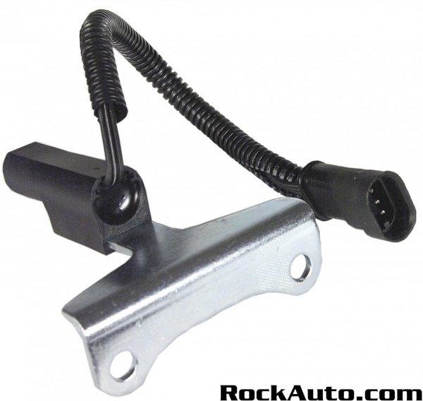

No power to coil. negative side has good ground.

No code shows up, apparently relay works. how do i find crank and cam sensor connectors to check them and how do i replace them? sorry i have been retired for 20+ years. i love your web site!

The better approach is to use a scanner to view live data and see if both sensors are developing their signals. Each one will be listed with a "Yes" or "No", or something like that to show if their signal is showing up during cranking.
The crankshaft position sensor is in the transmission's bell housing, right behind the right cylinder head. It looks like the one in the first photo. No spacer or other special procedures are needed for setting the critical air gap. That is handled by the mounting bracket design.
The camshaft position sensor is a disc under the rotor in the distributor. It is also called the "distributor pick-up". That one probably has a slightly higher failure rate than the crank sensor.
Do I assume you mean the ASD relay is working because you saw the test light turn on for that initial one second, but not again during cranking?
