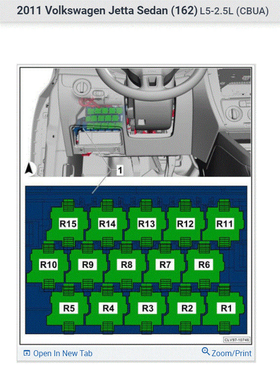

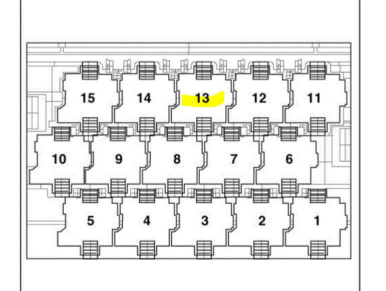

As far as the relay, it is referred to as the power supply relay on this vehicle. It is located in the vehicle. See pics 3 and 4 below. It is relay 13. If there is a different relay with the same part number, switch them to see if it changes. If there isn't, here is a link that shows how to test a relay:

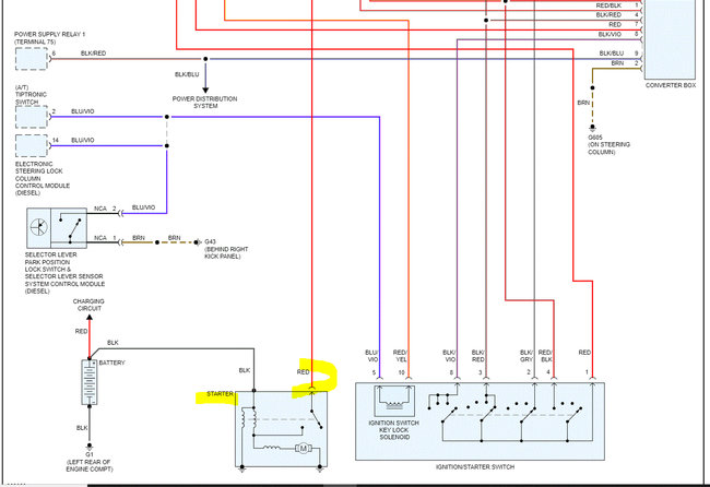

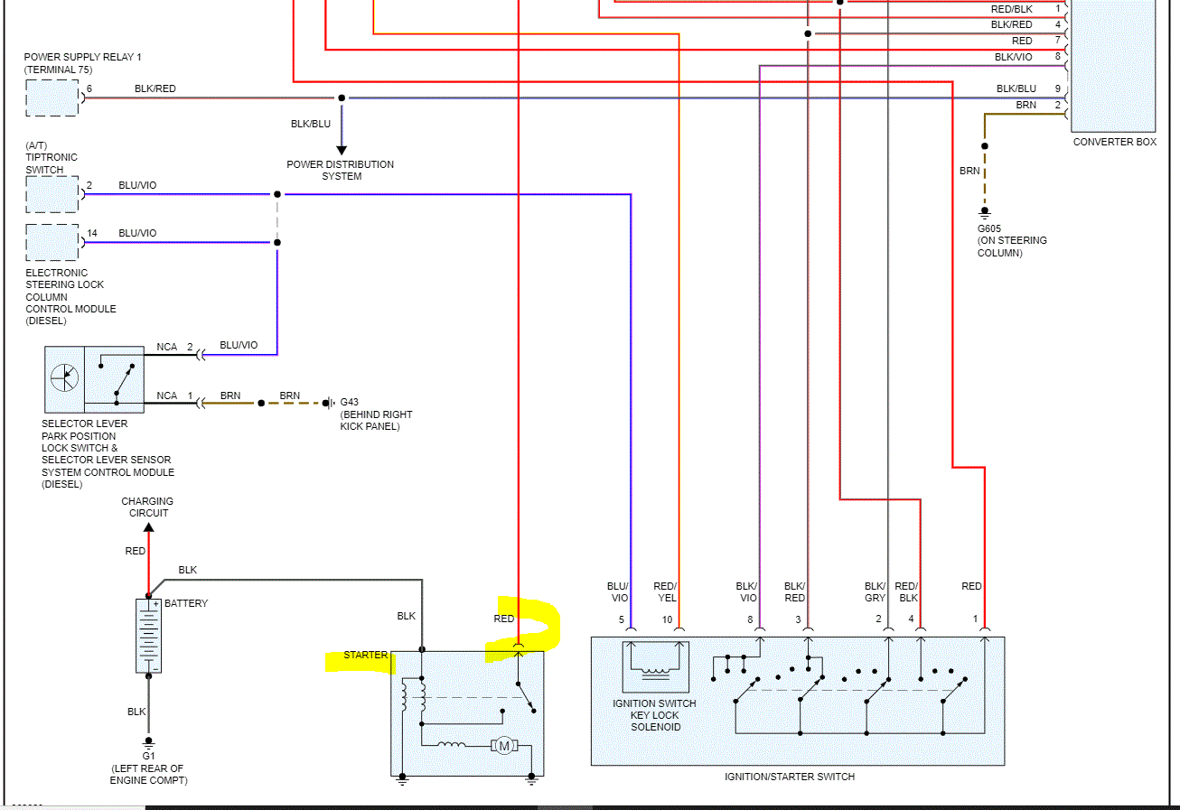

If the relay is good, here is what I need you to try. Locate the starter motor. Have a helper in the vehicle try starting the engine while you watch for power at the smaller red wire at the starter motor. I attached the schematic below. (Pics 1 and 2)
