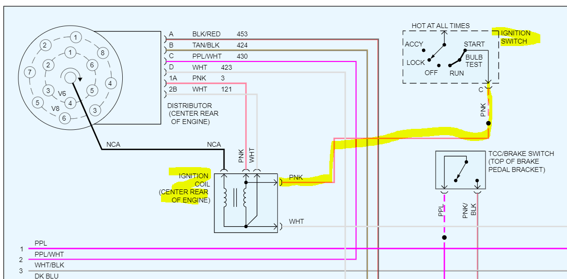

If there is no change when you use starting fluid, then I need you to locate the red wire at the ignition coil. See pic below. With the key in the run position, check that wire for power.
Let me know what you find.
See pic below.

It does have power, the red wire.
Dec 26, 2022 at 5:10 AM
  • 110,240 POSTS
Joel,
I reread my post. If there is low voltage to the pump, that will likely cause a no-start. You indicated there is power to the red wire. That is a good thing. That tells me that the ignition coil is getting power, so there is a good chance we have spark to the plugs. If you want to confirm that for me, it may help.

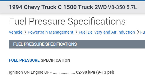

So, low voltage to the fuel pump will cause low fuel pressure. There may not be enough pressure for the injectors to actuate. So, we need to check the fuel pressure or access the fuel pump and check the voltage being sent. Checking pressure is much easier. LOL
Here is a link that explains how it's done:
I attached the manufacturer's fuel pressure specs below.
