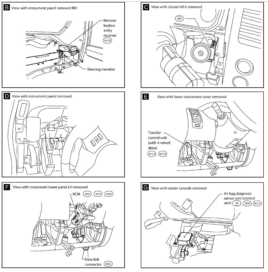

no start, battery, fuses, relays, start and alternator all seem to be fine even the connectors are clean.
will a computer scan diagnose the no start issue?

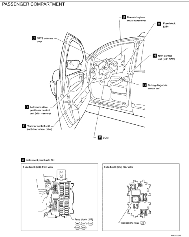

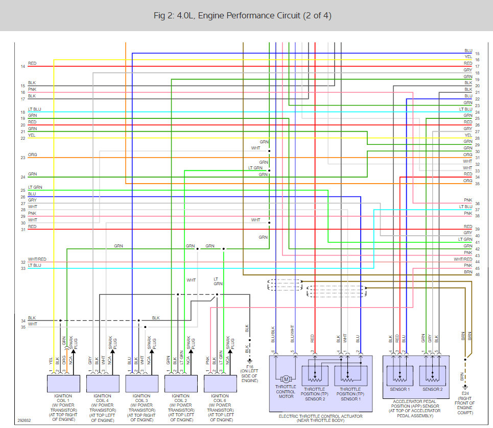

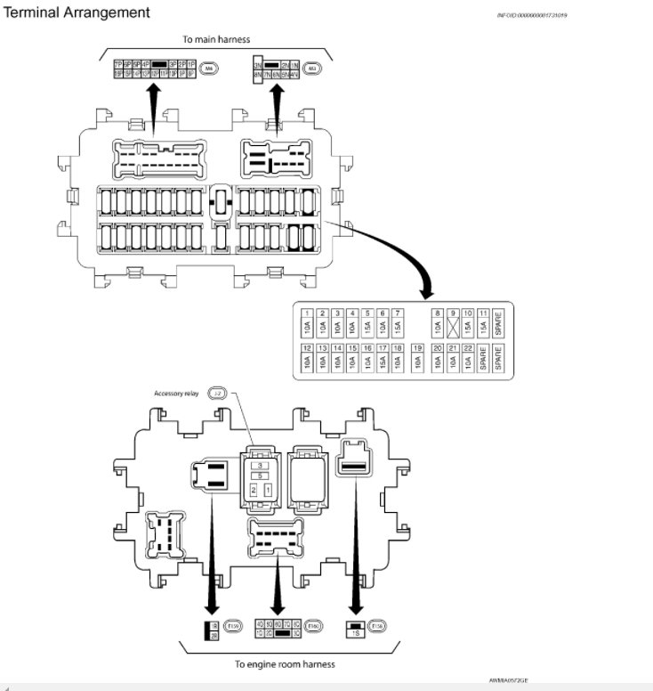

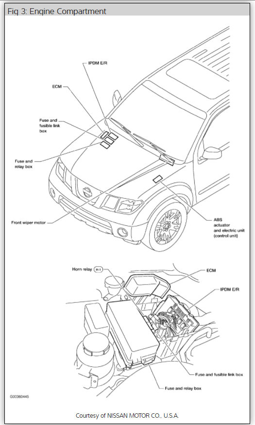

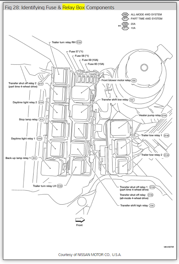

did a scan and came up with code u1000 communications troubles.
Sep 6, 2017 at 6:51 AM
  • 55,604 POSTS

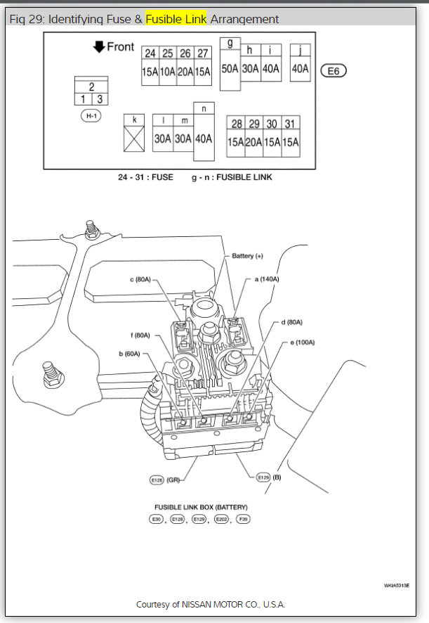

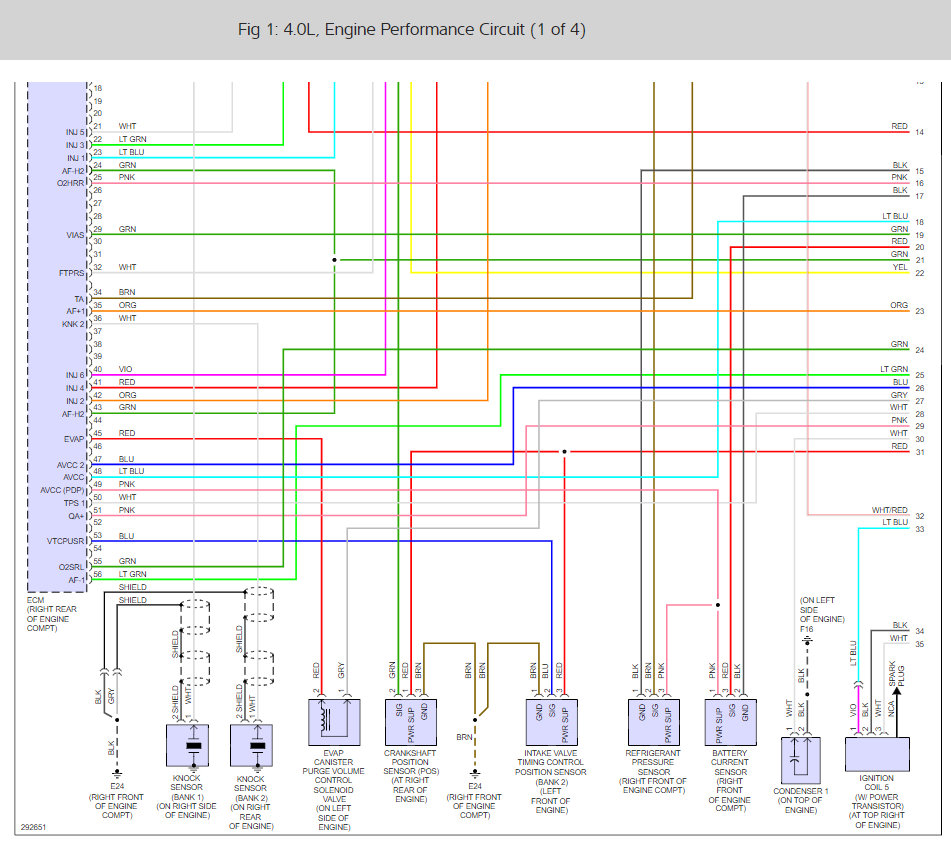

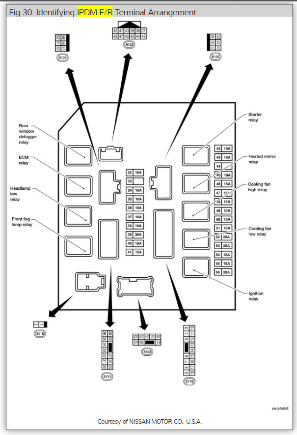

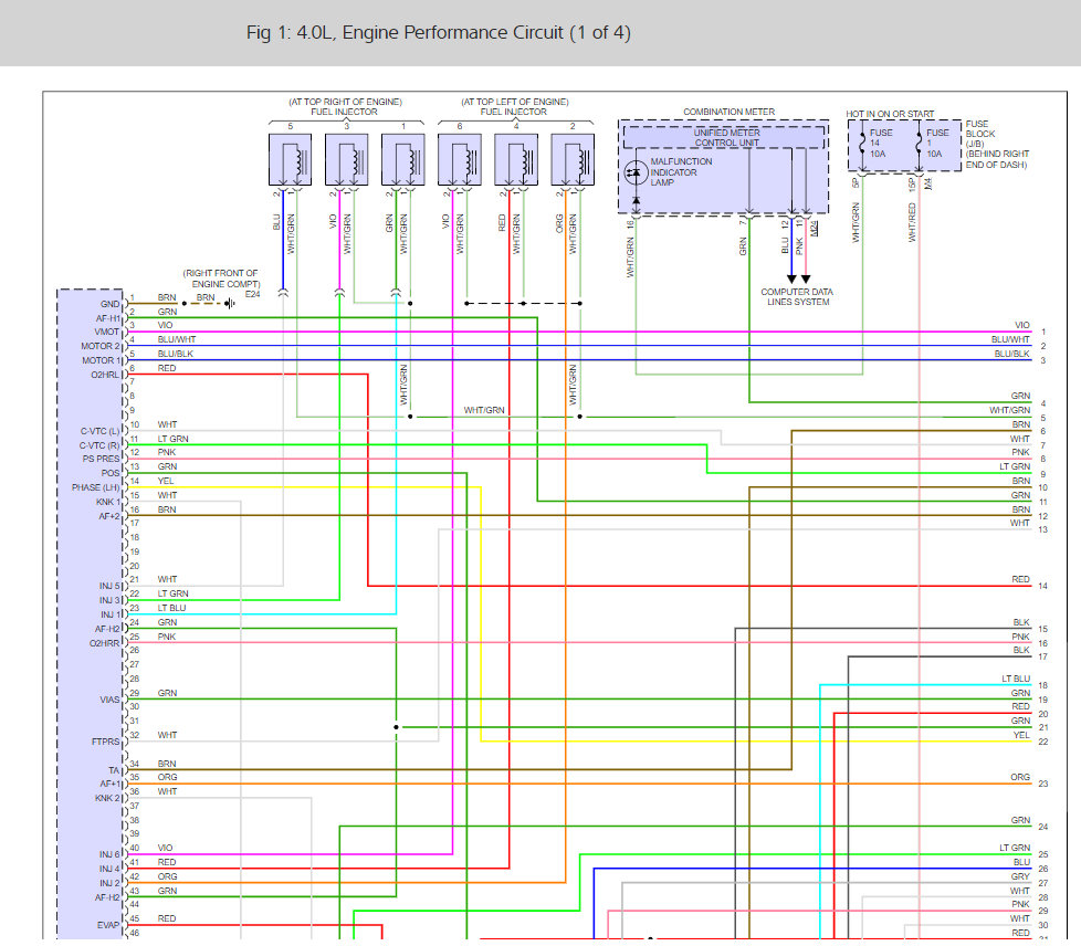

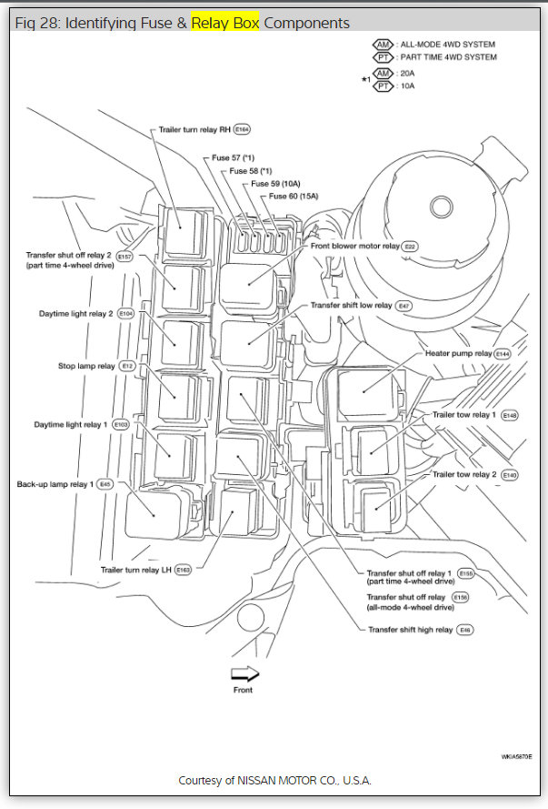

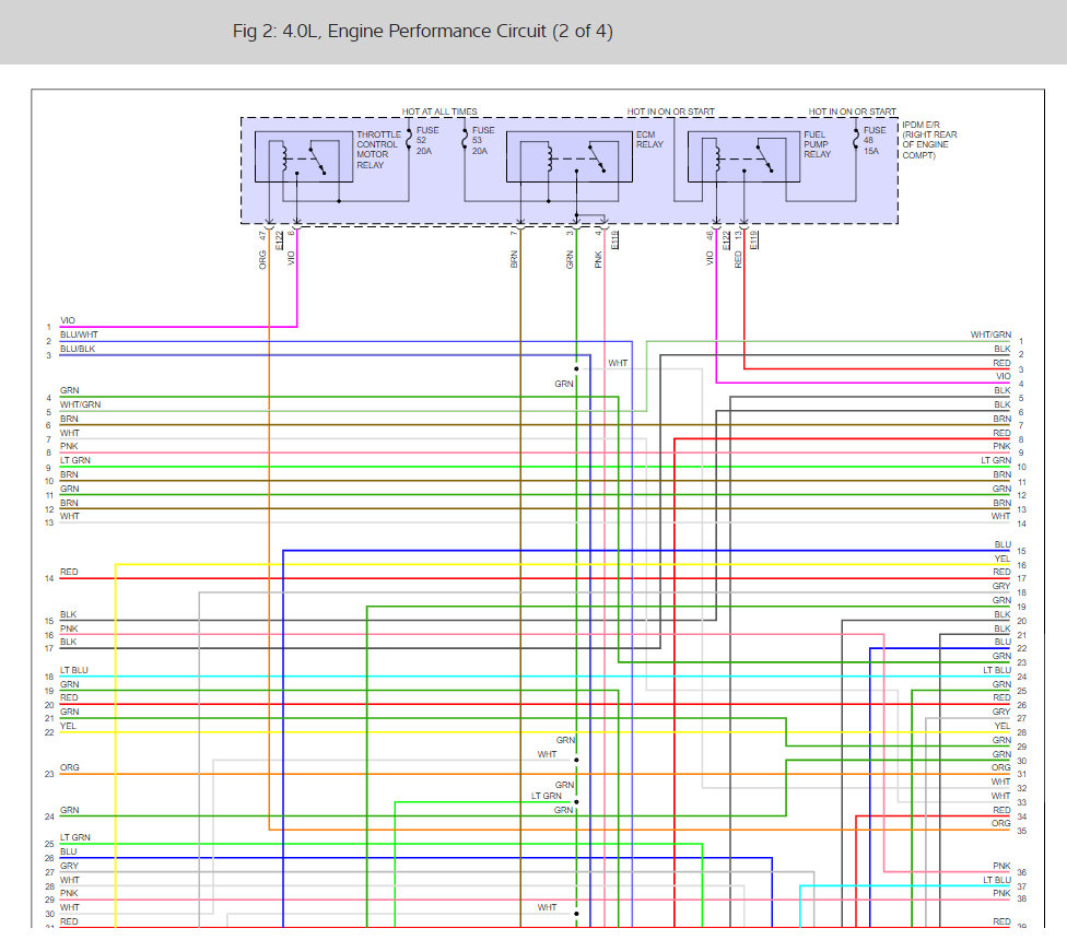

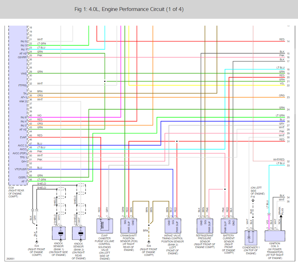

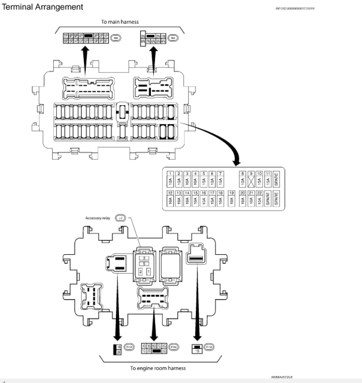

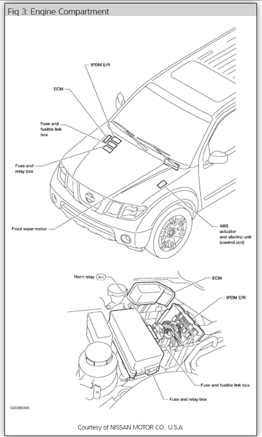

This sound like it can be one of two troubles first lets check the fuses and relays that run the system.
Here are two guides and some diagrams (below) to help us get started:
Start with fuse # 1 and 14 and the ECM relay
and
Please let us know what happens so it will help others.
