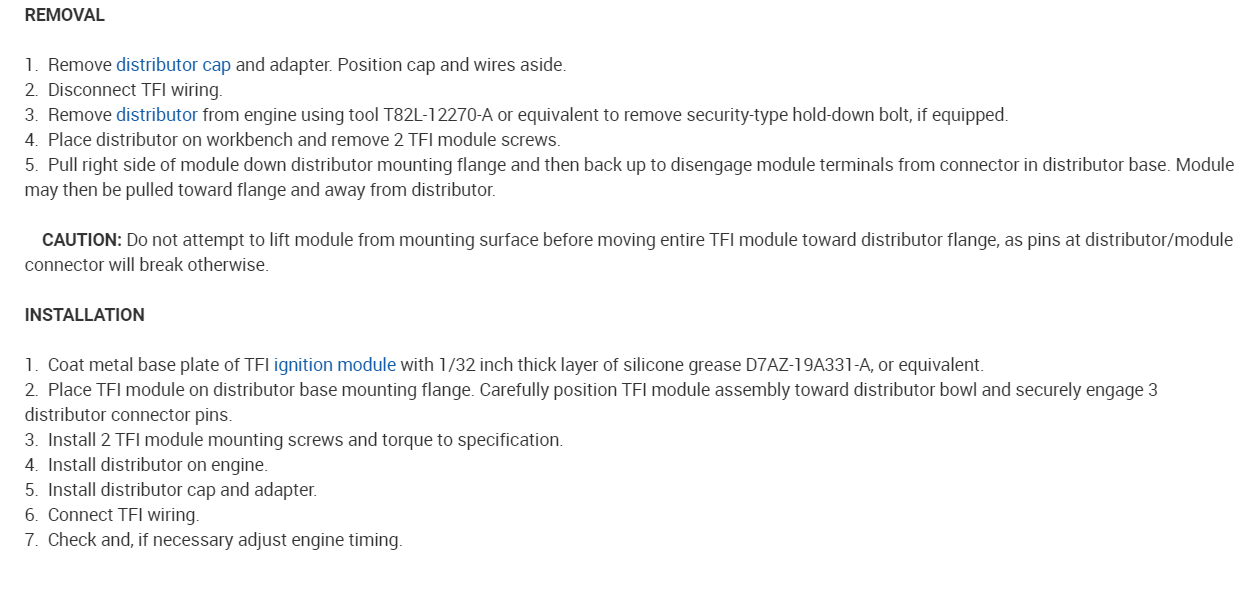

My engine just stopped one day and hasn't started since. I got a code reader and the first time it gave codes 67-10-11. I tested it again the next day and now reads 67-10-96. I know very little about cars but I found out that 67 is the nuteral/drive safety switch. If the truck hasn't moved or even started how and why is code 96 coming up and what can I do now?

I have replaced the spark plugs, distributor cap and rotor, plug wires, ignition coil. The starter does try to start but there is no spark from the ignition coil to the distributor.

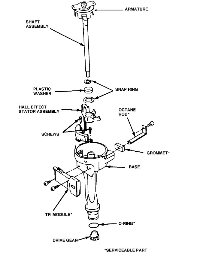

Could it be the secondary ignition coil inside the distributor?

These have the soft film ignition module that goes out. here is the instructions on how to change it out in the diagrams below. Check out the diagrams (below). Please let us know what happens.
