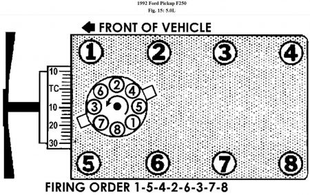

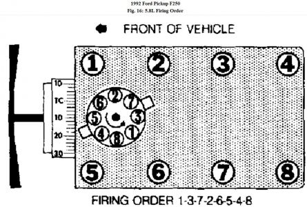

my truck has been fouling its plugs and so i checked the firing order and it was wrong so i corrected it now it wont start and it back fires when i try what should i do or do you know what is wrong?
May 13, 2010 at 7:27 PM
MERLIN2021
  • 17,250 POSTS
Two were used, 5.0 is on top and 5.8 7.5 on bottom. It helps if we know the engine size!
