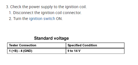

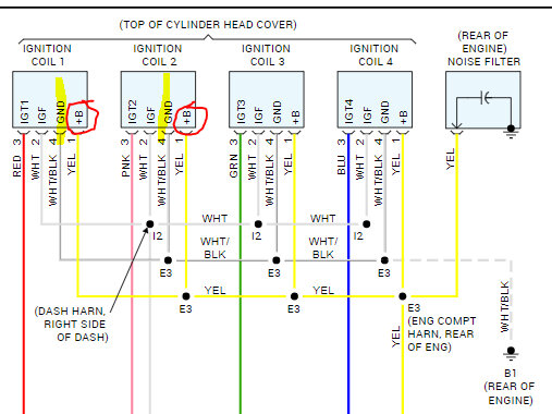

I attached a pic below showing the wiring to the coils. First, with the key on, check if there is power present at the yellow wires on cylinders 1 and 2. If there is, then confirm there is continuity to ground via the white wire with a black tracer.
Note that each of the coils has these color wires. Since you have spark on cylinders 3 and 4, I know both are present. However, there are a few different splices that may have failed for cylinders 1 and 2.
See pic below.
Jan 31, 2024 at 10:41 AM

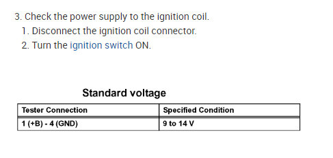

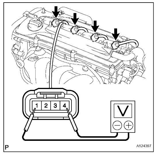

If you look below, the yellow wires should have power with the key on. Take a test light and place the alligator clip on the battery neg to check.
Then, remove the test light alligator clip from neg and place it on the positive battery terminal. Probe the IGT 1 and IGT 2 terminals while a helper cranks the engine. Those wires should cause the test light to strobe.
See pic below.

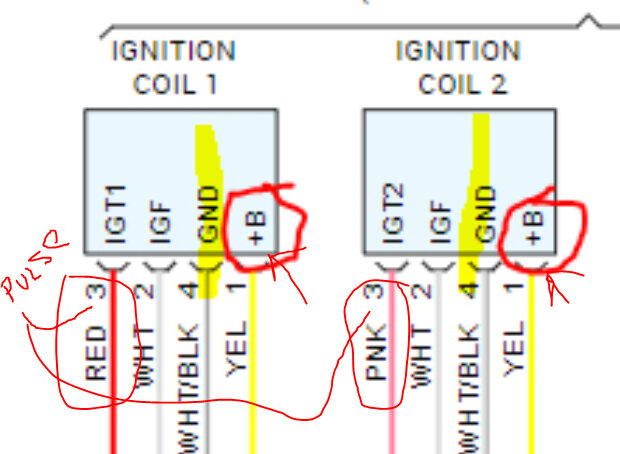

I just realized something. You are describing the connector and not the schematic. If you look at the wire colors I provided, do they indicate the correct things? If so, just to confirm, perform the test below. If that tests good, the coil pack itself is the likely problem. I say that because you should be getting a strobe from the IGT wire (pink or red). The IGF is the ignition feedback, and you should see that unless the coil is doing its job. If you look at pic 1 below, the numbers of the pins are identified in the schematic I provided. They are just in a different order.
You can also switch the coils between cylinders 1 and 3 to see if then you get a spark. Try this and let me know.
Sorry about the confusion. LOL Nothing was making sense to me. Also, remember that the IGT pins won't power anything. They are what provide a ground patch to complete the circuit and cause the coil to fire at the right time.

The ECM supplies a 5V reference voltage on the IGF circuit shared by all coils. Each time a coil fires, its igniter pulls the 5V reference voltage to ground. Check to see if that is present.

The voltage is lower, so the brightness doesn't surprise me. Since you are getting that signal, the computer thinks it is working. The only thing I can think of is a faulty ground.
