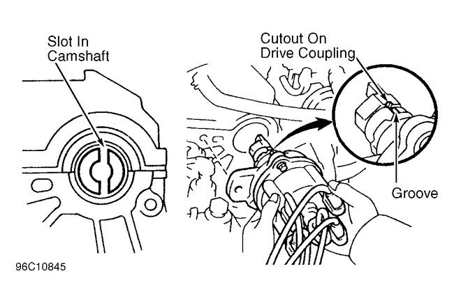

I am replacing the distributor in my daughter's car. Once the timing marks are lined up on the distributor shaft it will not line up with the back of the cam. The part of the distributor that bolts the distributor to the head does not line up with the hole on the head when the shaft of distributor lines up with the cam. The bolt flange is so low in fact, it bumps into the sensor housing on the coolant line.
So I figure the timing belt has jump a couple of teeth and the cam is out of sync with the crank. After doing all the work of taking the time covers off, I find that is not the case. The cam and crank are in fact in time with each other.
This is a non adjustable distributor, so there is no installing it and readjusting it later.
I am at a loss on this and I have never come across this problem before.

The first thing I do is compare new and old parts. So they do match. I also tried to put the old distributor back in, same result.
I noticed when I did the plugs and wire on this car two years ago the time was off. But you cannot adjust the timing and the engine was running fine, so I did not pursue trying to correct it.
There is a hole in the cam timing pulley that lines up with a hole in the cam assembly. So it is dead on. The crankshaft pulley alignment is odd on this engine. There is no mark on the pulley and oil pump housing. The shop manual states to have the key way on the top of the pulley at 12. The harmonic balancer was placed with the timing mark at 0 -top dead center. Who ever replaced the timing belt the last time put white marks on the pulley and the oil pump housing, which lined up as well (for what that is worth).
There are no shims with this distributor.
The alignment of the hole is off about an 1 1/4"-1 1/2", so in other words, it might as well be a mile.

That is a ton of space to be off. It must be missing the cam by a tooth at least if not more. Did you line up the timing marks before you pulled the distributor out? The cam teeth are definitely not lining up. that is for sure. I think I see the problem on this diagram, The distributor is going in backwards. on the diagram you can see the line up is offset to one side. There is a groove on the end of the distributor that needs to line up with the shaft itself. see if this might be the issue.

What I notice with your diagram is that the slot in the cam is not going straight up and down. It is at an angle. Say about ten or eleven o'clock.

I just meant that off set of the shaft might have been going in opposite of what it is suppose to. So even lined up at the number one it wont fit in right? something must be misaligned if you cannot even get the old distributor to go in.
Did you notice the groove on the distributor and its shaft? They need to be lined up as well
