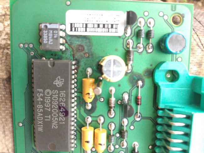

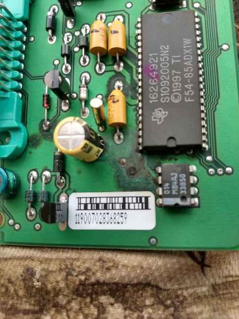

I have no spark at all but will turn over. Found burnt mark on theft deterrent module. Want second opinion that this is the problem and a bad module.

KENNETH1083
This is the module. We have gone over everything and replace about everything. To my understanding. This could be the problem with no fire at all. Because if this board is bad it's not communicating with the computer to tell it. That this truck is not being stolen and go ahead and function normally to start.

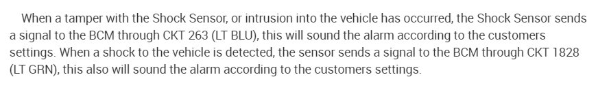

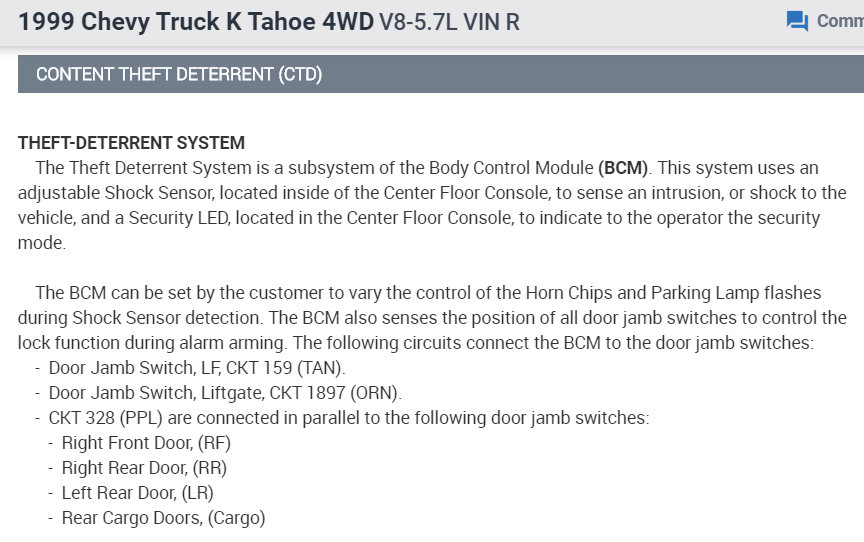

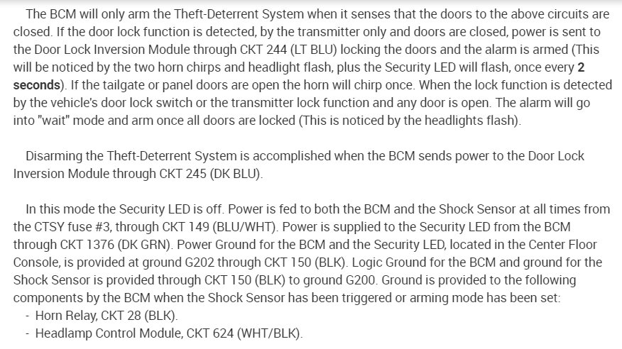

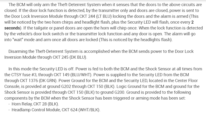

DANNY L
  • 5,648 POSTS
Hello again.
The theft deterrent system is a sub system of the BCM (body control module)
I've attached a few pictures below.Have you tested the BCM for this?
Also, here is an an anti-theft reset tutorial:
https://www.2carpros.com/articles/how-to-reset-a-security-system
Scroll the page after reading to find Chevrolet.Hope this helps and thanks again for using 2CarPros.
