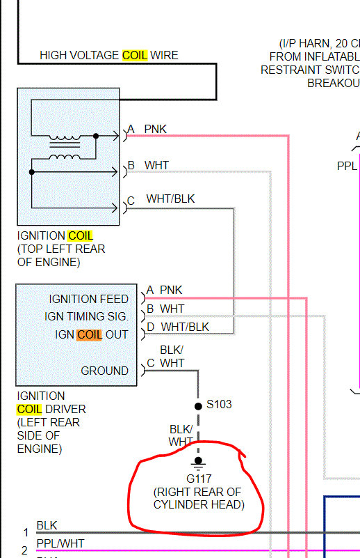

New engine install; no spark from coil. all coils test out well, crank sensor test out well. everything works on car was driven into the garage. nothing worse with new engine.

The first thing that comes to mind when you say the engine is new, is a ground for the coil. Take a look at pic 1. The ground for the coil driver is on the right rear cylinder head. Check that and see if you have a good ground. Here is a link you may find helpful:

that got it. thanks guys, you're awesome.

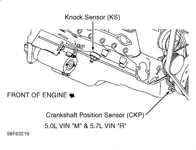

Let's try an experiment on a non rain day truck starting good spray water on the Cranksensor see diagram
https://images.2carpros.com/forum/automotive_pictures/198357_Graphic_399.jpg
. if good spray around DIST and coil see if you can make it fail then we'll no what to fix.

This sounds like a classic crankshaft angle sensor here is a guide to help you get back on the road.

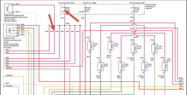

Checked all the fuses and relays. Have power to the coil but none going to the distributer. Checked the Cam sensor and it tested ok. Has new cap, rotor, plugs and wires.

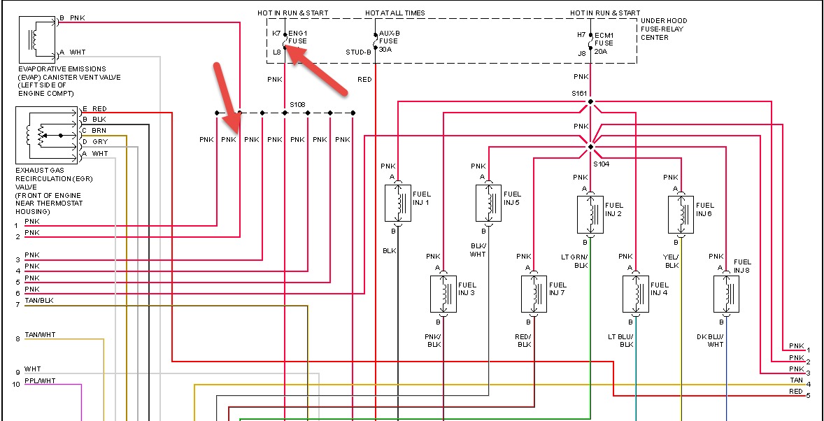

check where I've pointed to in pic see if pink wire leading to dist has power. if not check fuse 1 in underhood box and then see if it has power coming out of box it may be a poor connection in fuse box that powers the cam sensor in dist so car wold not run with no power to it. no codes I take it?.

I checked the wiring going to the coil and I have power going to the coil but none coming out. I bought a CP9125 OBD2 pocket scanner and it gave no codes. I checked the cam position sensor with the ohm setting on my voltage tester and it tested ok.

I checked the pink wire going to the cam positioning sensor and I have 11.5 volts

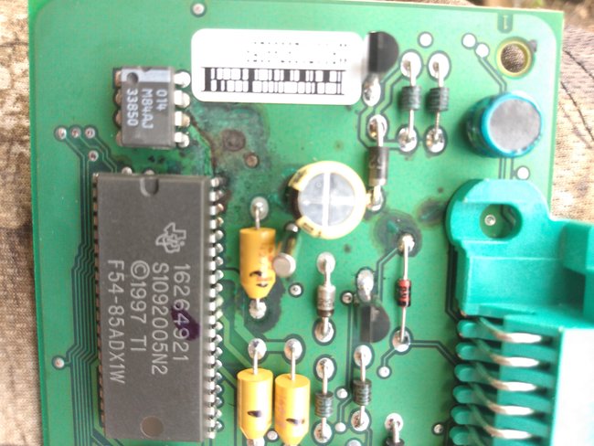

KENNETH1083

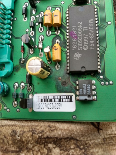

I have no spark at all but will turn over. Found burnt mark on theft deterrent module. Want second opinion that this is the problem and a bad module.
Mar 8, 2021 at 10:12 AM (Merged)
DANNY L
  • 5,648 POSTS
Hello, I'm Danny.
Can you use your cell phone and take a picture of the damage and upload here? That will give us a better understanding.Thanks for using 2CarPros.

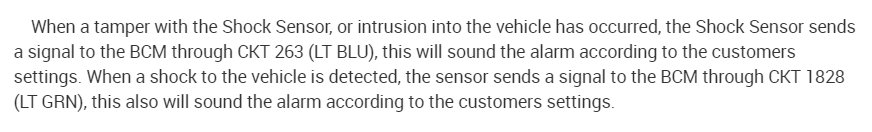

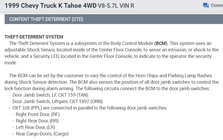

KENNETH1083

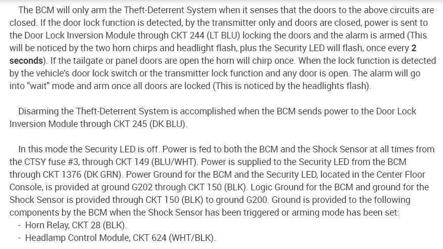

This is the module. We have gone over everything and replace about everything. To my understanding. This could be the problem with no fire at all. Because if this board is bad it's not communicating with the computer to tell it . That this truck is not being stolen and go ahead and function normally to start.
DANNY L
  • 5,648 POSTS
Hello again.
The theft deterrent system is a sub system of the BCM (body control module)
I've attached a few pictures below.Have you tested the BCM for this?
Also, here is an an anti-theft reset tutorial:
https://www.2carpros.com/articles/how-to-reset-a-security-system
Scroll the page after reading to find Chevrolet.Hope this helps and thanks again for using 2CarPros.

This is how the crankshaft position sensor commonly fails. It becomes heat-sensitive, fails, leading to engine stalling, then it works again when it cools down for an hour.
