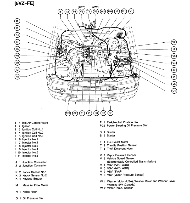

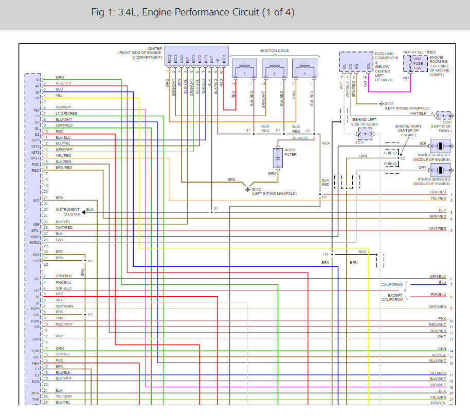

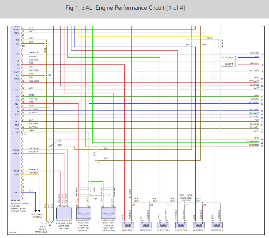

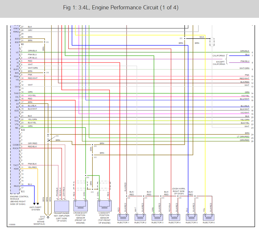

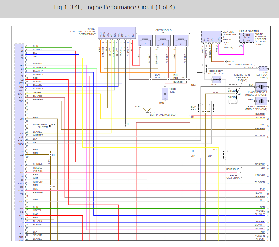

Replaced RCU with an ECU that has been flashed so that the transponder is disabled and the center ECU plug is not plugged in. I have replaced coils, wires, plugs, igniter and crankshaft positioning sensor still no spark. Checked with test light and everything gets power but no spark past coil.
Sep 26, 2018 at 10:27 PM
  • 55,224 POSTS

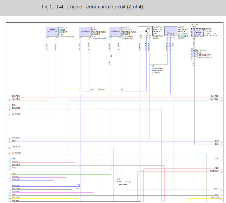

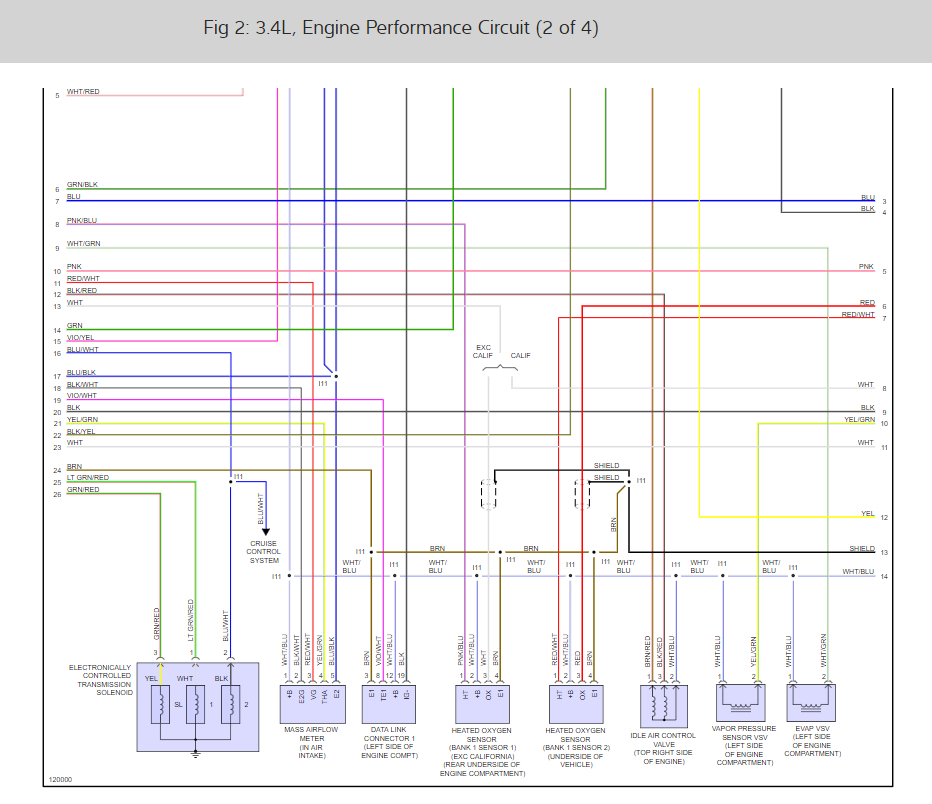

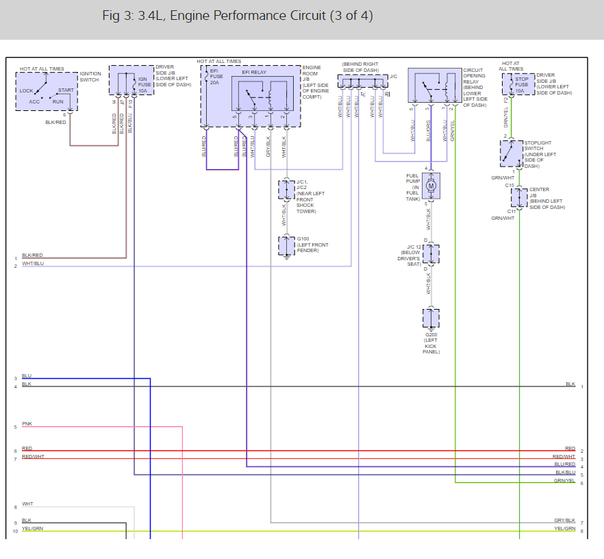

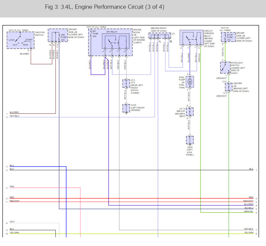

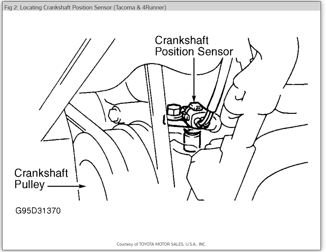

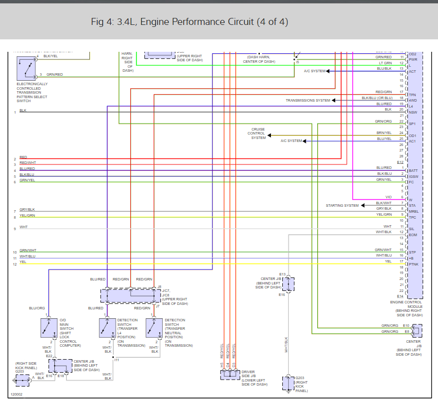

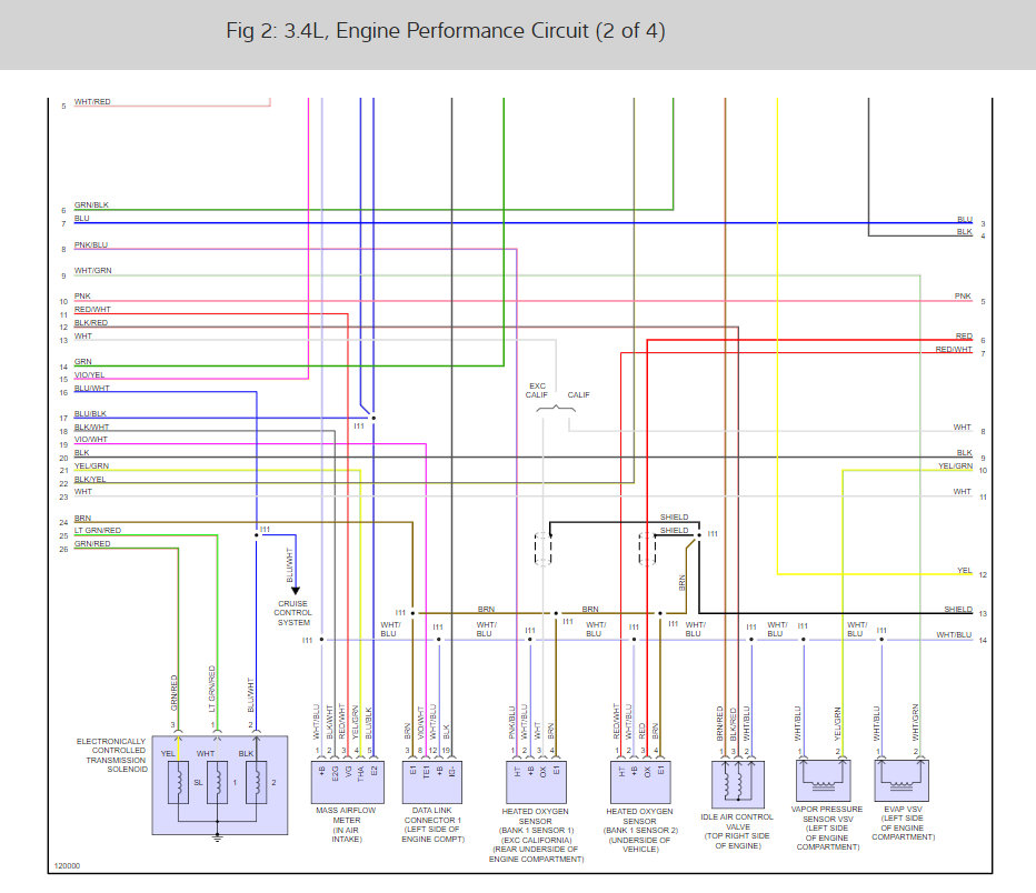

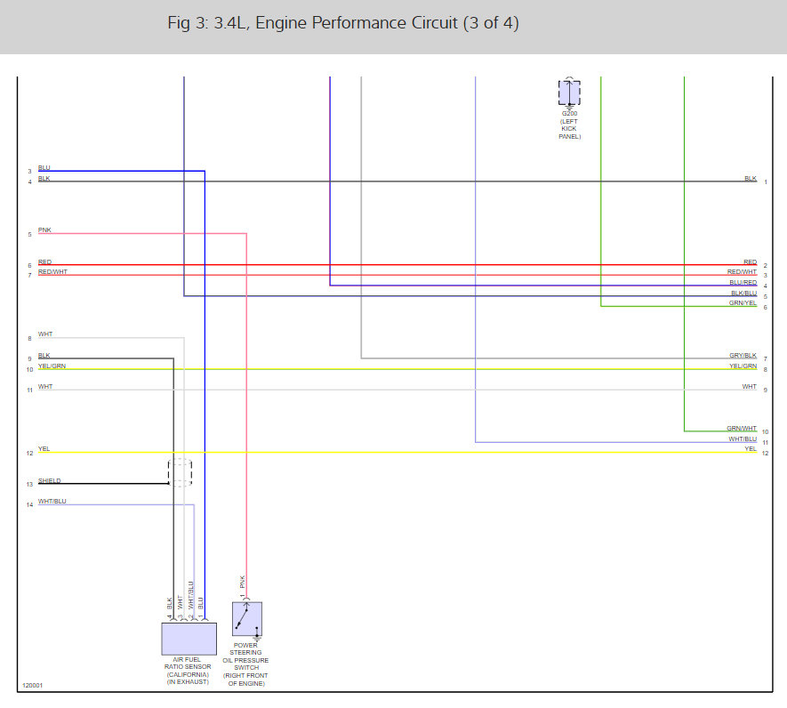

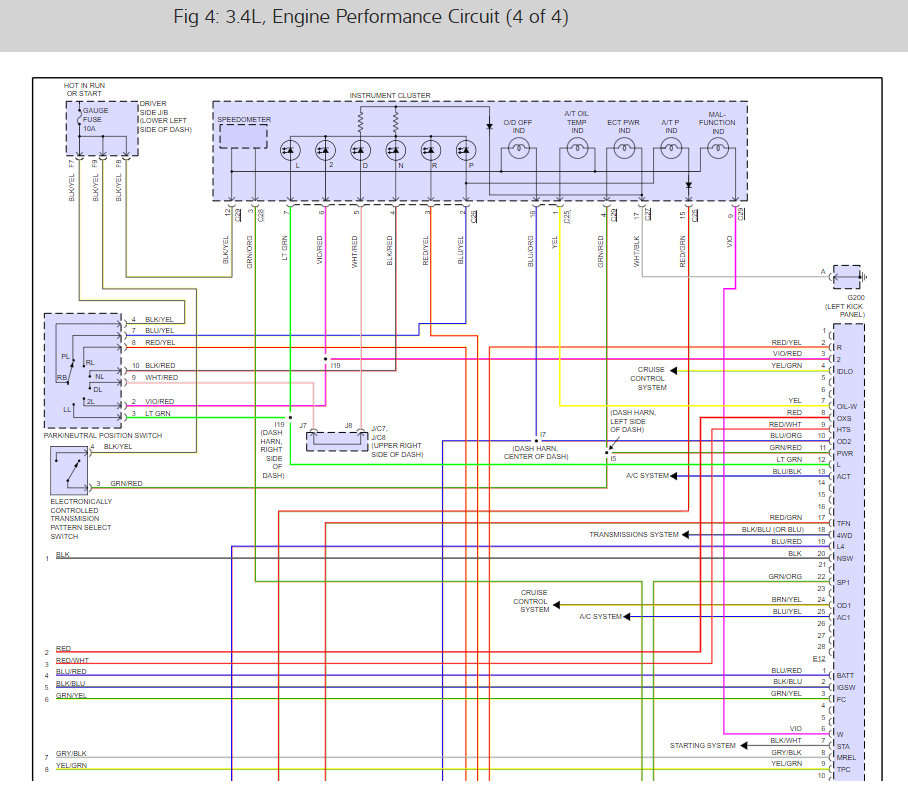

These cars had a problem with the ignition ignitor but to be sure lets check for power and ground for the PCM. Here is a guide to help you confirm the issue and the engine wiring diagrams so you can see how the system works:
If everything looks good I would replace the igniter.
