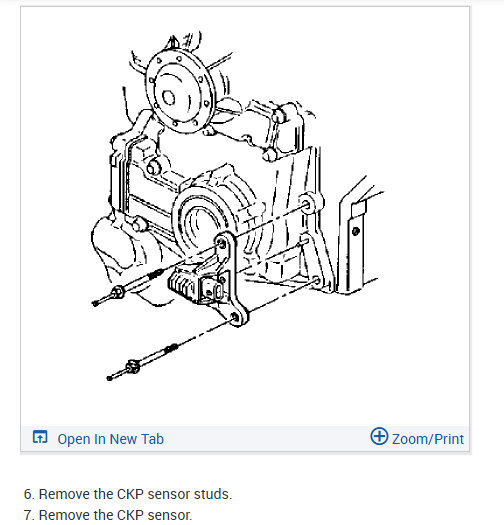

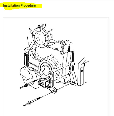

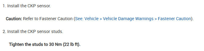

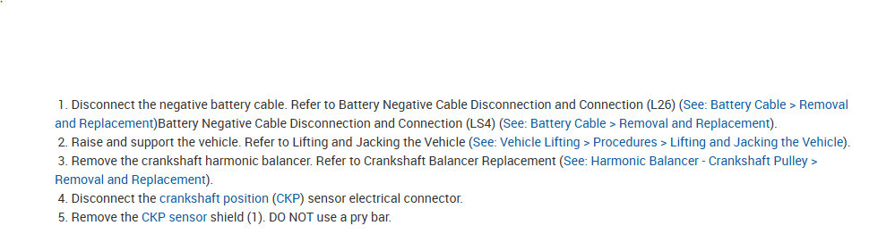

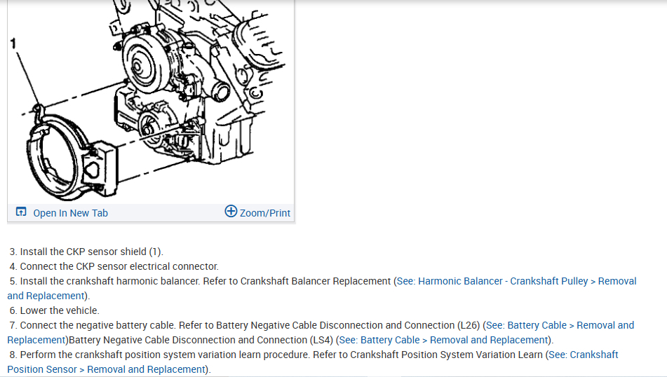

Have you checked the crankshaft position sensor? If it has failed, it will prevent spark to the plugs.
First, if you have a live data scan tool, check for an RPM signal when cranking the engine. If you don't have a scanner, see if the tachometer moves a little when cranking.
If there is no signal, replace the crankshaft position sensor. I attached the directions below specific to your vehicle.
Check for a signal and let me know what you find.

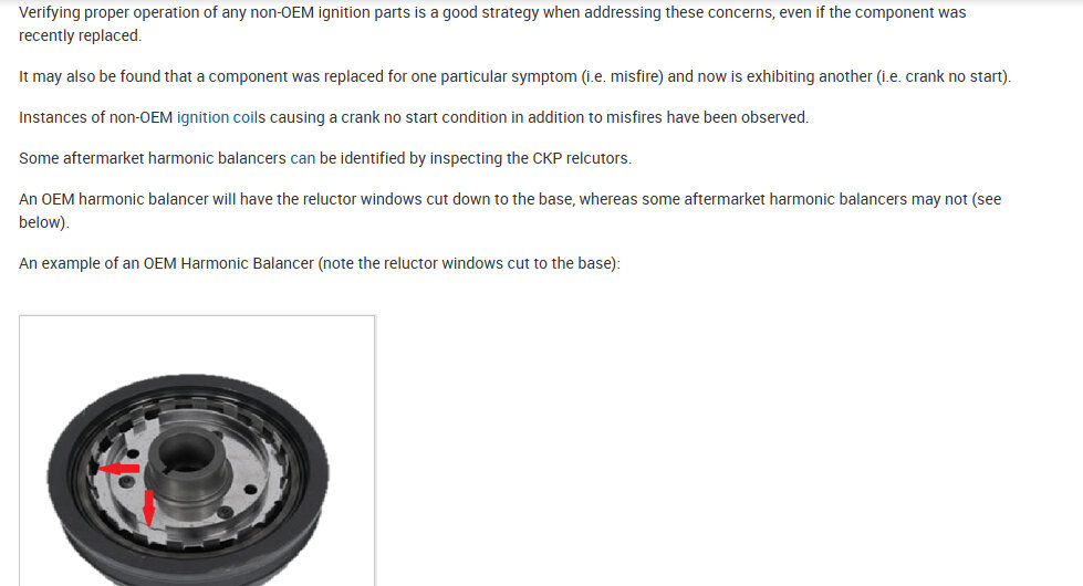

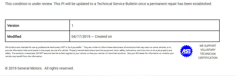

I'm not familiar with an issue with the ignition switch. Anything is possible.

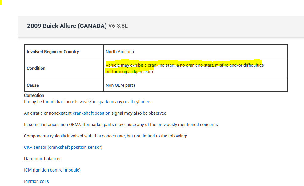

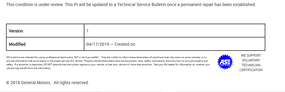

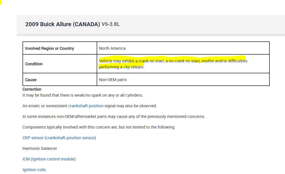

I attached a technical service bulletin (TSB) below for your review. It is related to the use of non-OEM ignition parts.

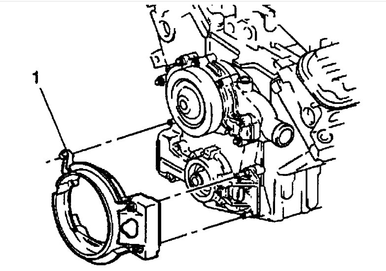

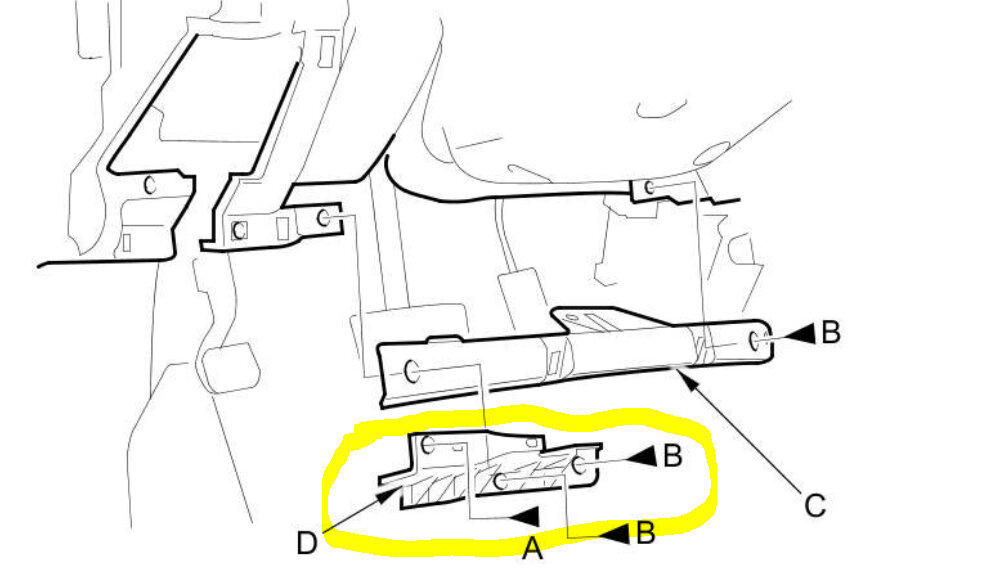

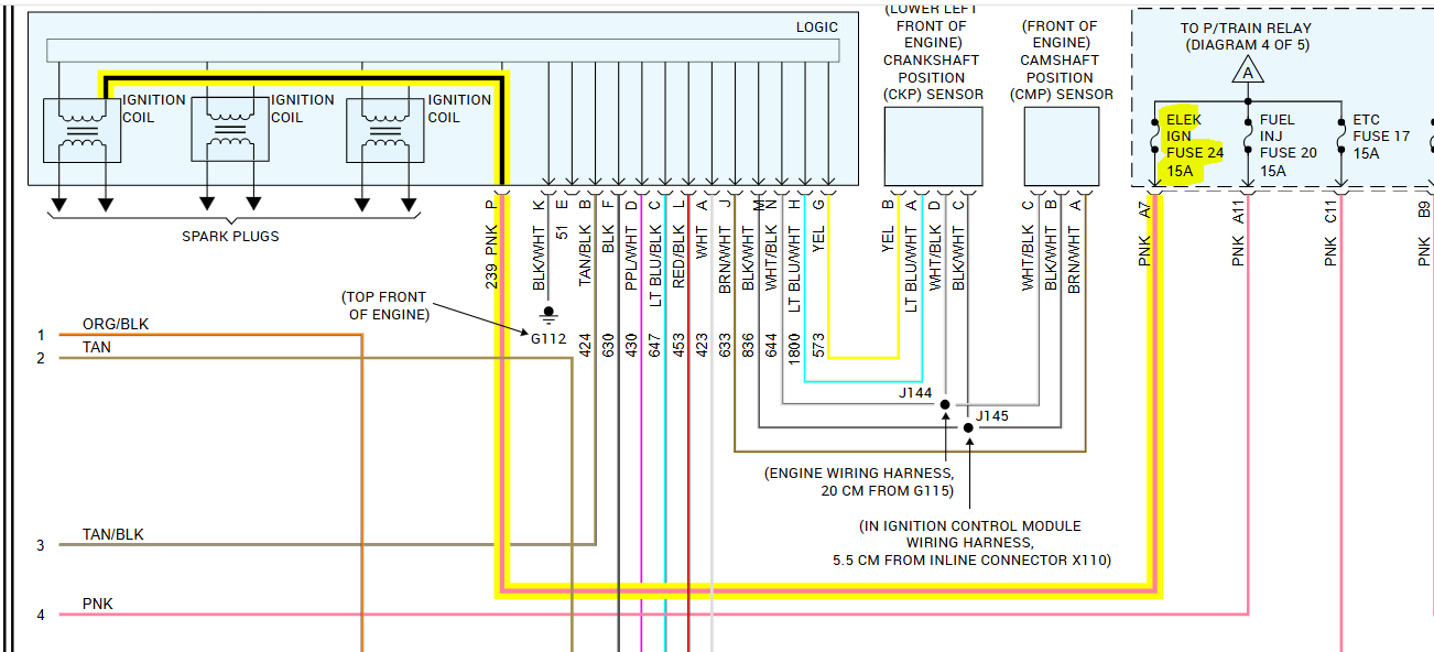

Last, I need confirmation that there is power to the coils. See the last pic below. Check the fuse with the ignition key in the run position. If it has power, go to the module and check if power is present at the pink wire.
Jan 5, 2025 at 1:52 PM
NIHAL
  • 15 POSTS
Hi Joe, I checked the fuse, and it is good and there is power going to the pink wire. I used a test pen to check it. But when I put the test pen on the module there is no power. Thanks for your help.
Jan 5, 2025 at 1:58 PM
  • 110,241 POSTS

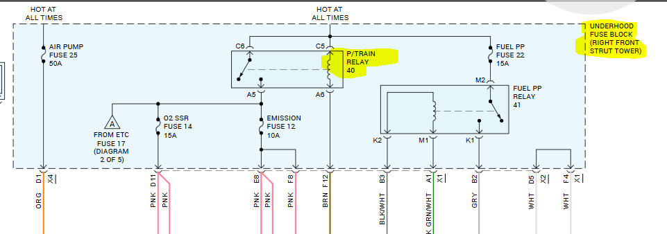

If you have power at the fuse, the wire must be broken between the fuse and the module. Power comes from the powertrain relay in the under-hood fuse box and to the fuse you checked. If that has power, then the relay is working.
If you have power out from the fuse, it goes directly to the control module. If you can, disconnect both sides of that power supply and check it for continuity. We must be missing something simple.
See pic below (ignore the first pic. I can't delete it)

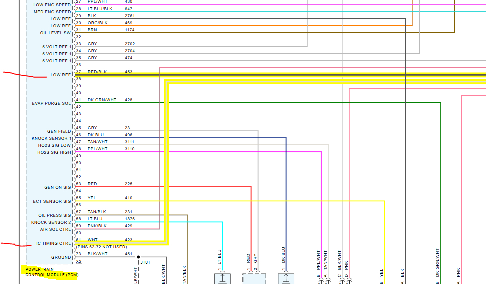

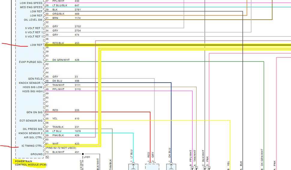

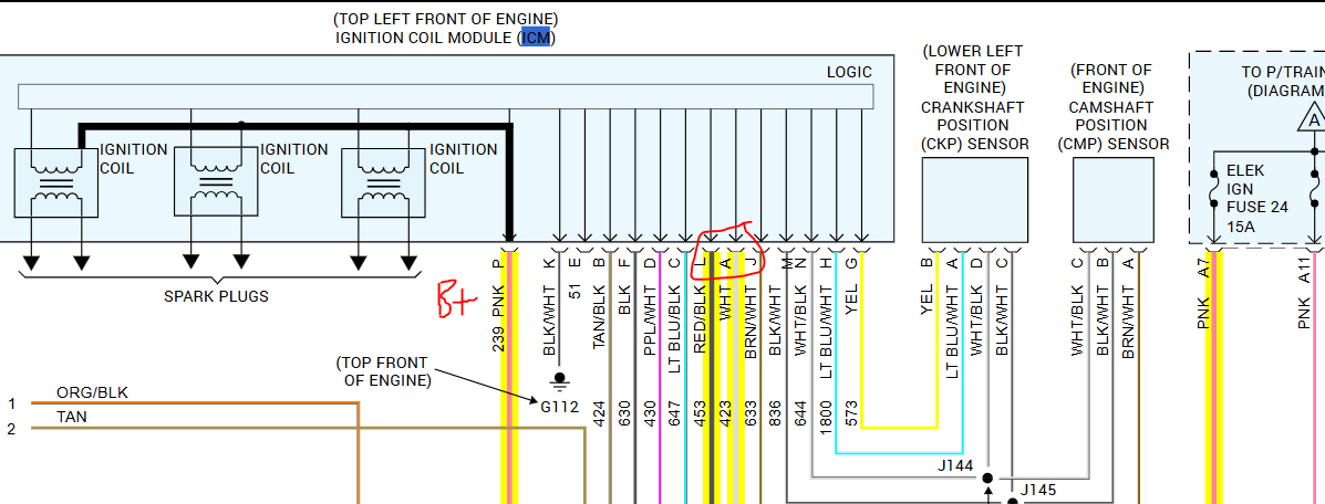

Make sure the ICM is grounded. At the connector, there is a black wire with a white tracer. That grounds to the front top of the engine. Make sure it is a solid chassis ground.
Next, there will be a red wire with a black tracer. That is a signal ground from the PCM. Confirm that is producing ground. when cranking.
The white wire is from the PCM. It is the ignition timing control signal. That should be producing a signal as well.
If these things are not present, I have a feeling the PCM is faulty.

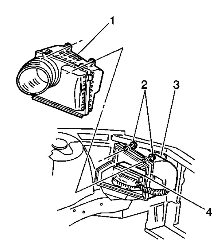

I just checked and the ground from the black wire is solid but the ground and power from the pcm was not producing anything when I was cranking the engine. This has to mean that the PCM is faulty. I checked this by using a test pen light and stripping the wires from the middle to where the test pen could fit and there was no light.
Jan 31, 2025 at 3:50 AM
  • 55,399 POSTS

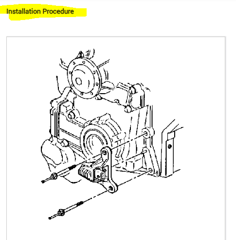

Yep, I have seen the PCM cause this issue, you can get a preprogrammed unit by searching Google or Ebay. But, I have also seen a shorted coil shut down the PCM ignition coil drivers as well. I know you replaced the module but did that include the coils as well? Here is how to change out the PCM. Check out the images (below). Please let us know what happens.
