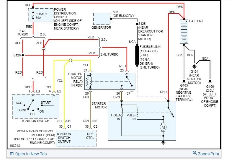

I have the car listed above SXT model. When I turn the key the starter doesn't engage, no click from starter. I popped the cap off the relay so I could get to the armature and manually press it to engage the starter, when I do this I get no spark to the spark plug. But here's the thing: I can push start it and it will start and run just fine. Not from the key however.let me add that I do have the gray key and key fob for this car that work and no theft light on the dash is activated.

I attached a wire diagram for you to view. If you have a test light or volt meter, we can do some checks to find the failure.

Can you verify power to the relay?
With the key on, 1 terminal should have power. Then have someone turn the key to start. You should have a second wire have power as well.

Yes, thanks for your reply to the last question. So yes I have power at number 30 terminal with key in on position and none of the other three terminals have power not even in the start position.
Jun 14, 2020 at 1:51 PM
Okay, that power for the relay for start, the yellow wire, comes directly from the ignition switch. You need to test that wire to see if it has power in the start position.
Jun 14, 2020 at 1:54 PM

Hi Roy and answer to that know that yellow wire does not have power in the start position. but I'm starting to get the feeling that maybe the ignition isn't turning all the way to the start position. it's turning but maybe not turning far enough so.

You can try that but the ECM is what grounds the control side of the relay based on the input from the neutral safety switch.

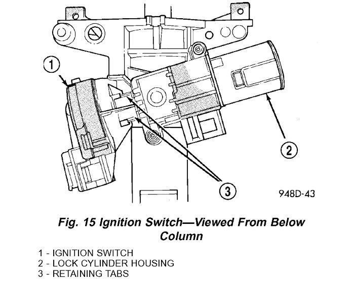

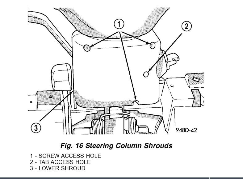

Okay, sounds like you need an ignition switch.
REMOVAL - IGNITION SWITCH
The ignition switch attaches to the lock cylinder housing on the end opposite the lock cylinder (Fig. 15). For ignition switch terminal and circuit identification, refer to the Wiring Diagrams.
1. Disconnect negative cable from battery.
2. Place key cylinder in RUN position. Through the hole in the lower shroud, depress lock cylinder retaining tab and remove key cylinder (Fig. 16).
3. Remove upper and lower shrouds from steering column.
4. Disconnect electrical connectors from ignition switch.

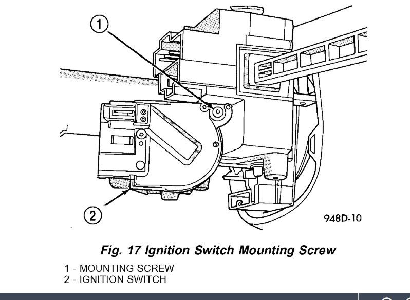

5. Remove ignition switch mounting screw (Fig. 17) with a #10 Torx bit.

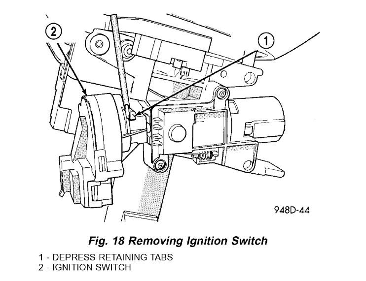

6. Depress retaining tabs (Fig. 18) and pull ignition switch from steering column.
INSTALLATION
1. Ensure the ignition switch is in the RUN position and the actuator shaft in the lock housing is in the RUN position.
2. Carefully install the ignition switch. The switch will snap over the retaining tabs (Fig. 19). Install mounting screw (Fig. 17).

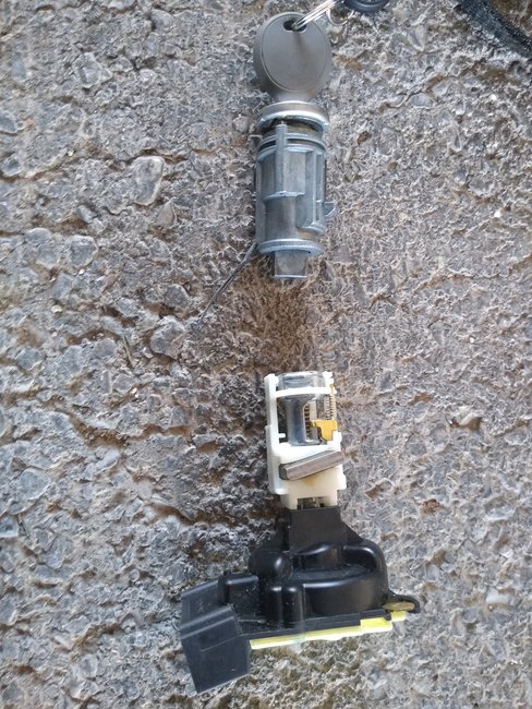

Hi Roy, I made it back from the Pick-A-Part with a different ignition switch. And you were right the ignition switch was the problem. Finally this is awesome thanks so much. Would you be able to tell me how to separate the ignition switch from the mechanism in between it and the key mechanism? if you look at the picture I sent I need to separate the middle piece from the black piece on the right.

GWVANALLEN
  • 32 POSTS
I don't know how you're viewing the picture but it's showing me the picture as in vertical as opposed to horizontal. so what I need to do is separate the white piece from the black piece. thanks again.

GWVANALLEN
  • 32 POSTS
I know I need to be careful in this process because while I was at the Pick-A-Part I broke the exact same mechanism down there by barely pulling on it.

Okay, look at the pictures I posted. There are 2 tabs you depress to release it from the switch.
