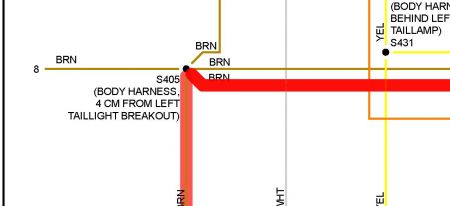

DONABK
Did you ever get an answer or figure your light problem out? We are having almost identical problems with our 2000 Montana!
I'd love to know how you fixed it!

Our tail lights do not come on with the head lights. The brake lights and blinkers work fine. At about the same time, the dash lights quit and a warning bell continues to ring when the door is open even when the lights are turned off and the key is out of the ignition.
We think there are fuse issues but don't know which ones belong to the problems areas (we know where the boxes are)
HELP! This is our last vehicle. The other died a transmission death last week and we are behind the eight ball!
Thanks for any help or direction you can give!
+1
Wednesday, July 29th, 2020 AT 9:56 AM (Merged)
  • 75,992 POSTS
Check splice connection G-405
https://www.2carpros.com/forum/automotive_pictures/12900_splice_3.jpg
DONABK
Thanks for the recommendation. I have no clue what and where that is, but I'm thinking my husband will find it! We really appreciate your help and will let you know if it fixes the problem!
