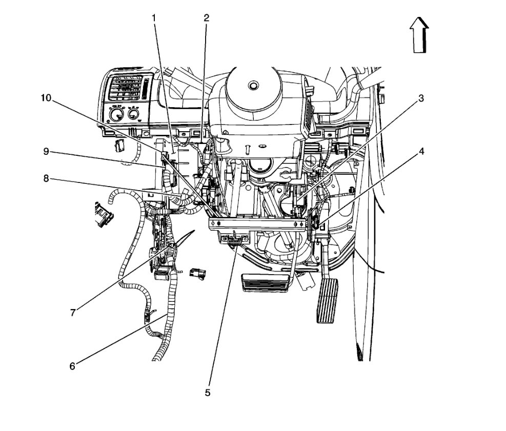

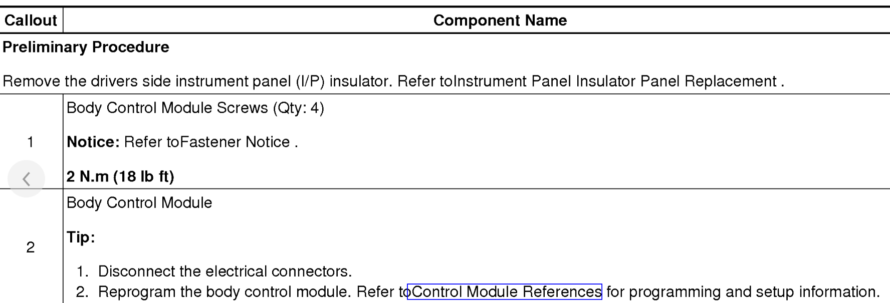

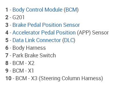

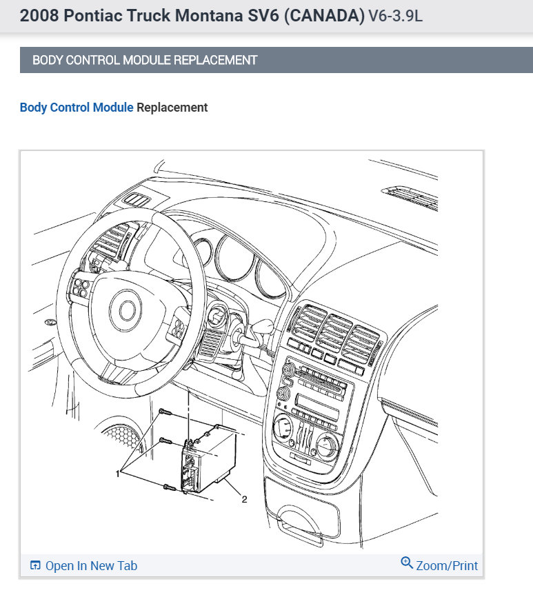

It sounds like the BCM is out and needs to be replaced here are the instructions on how to do so in the diagrams below.
Body Control Module Programming and Setup
A new body control module (BCM) must be programmed with the proper RPO configurations. The BCM stores the information regarding the vehicle options and if the BCM is not properly configured with the correct RPO codes, the BCM will not control all of the features properly. The Tech 2 software will automatically prompt you with the possible RPO's available for the vehicle. Ensure that the following conditions exist and are met in order to prepare for BCM programming:
1. Understand this entire procedure.
2. The battery is fully charged.
3. The ignition switch is in the ON position.
4. The data link connector (DLC) is accessible.
5. All disconnected modules and devices are reconnected before programming.
6. Follow all Scan Tool on screen directions.
7. Take time to verify the VIN on the Scan Tool is correct, failure to do this could result in the service part being made unprogrammable.
BCM Setup
1. To setup a new BCM, navigate to the Module Setup menu in Computer Integrating Systems on the scan tool, select Body Control Module.
2. Run the BCM Setup, BPP Calibration and Program Key Fobs procedures.
3. If the BCM fails to accept the program, perform the following steps:
* Inspect all BCM connections.
* Verify that the scan tool has the latest software version.
Remote Start Programming
The Remote Start option can only be programmed with an SPS terminal and a Scan tool configured in the Pass Thru programming arrangement. Use this arrangement and select Remote Start setup on the SPS terminal once the programming options appear. Choose the appropriate settings when prompted for engaging or disengaging the Remote Start option. Refer to Service Programming System (SPS) (See: Vehicle > Programming and Relearning).
BPP Sensor Calibration
Important: If the BCM, electronic brake control module (EBCM) or the brake apply sensor (BAS) is replaced a brake pedal position (BPP) sensor calibration must be preformed.
Perform the BPP Sensor Calibration using a scan tool if the BCM, EBCM or the brake apply sensing system (BASS) sensor has been replaced.
Using a scan tool preform the following:
1. Navigate to the Module Setup menu in Computer Integrating Systems on the scan tool, select Body Control Module.
2. Select BPP Sensor Calibration.
3. Follow the on-screen directions.
Passkey 3 Programming Procedures
Important: If any module or device listed is replaced, programming of the module must be done prior to performing the Passkey 3 Programming procedure.
Perform the Immobilizer System Component Programming (North America except Canada) (See: Vehicle > Programming and Relearning)Immobilizer System Component Programming (Canada) (See: Vehicle > Programming and Relearning) procedure if any of the following components have been replaced:
* The BCM
* The powertrain control module (PCM)
Refer to Immobilizer System Component Programming (North America except Canada) (See: Vehicle > Programming and Relearning)Immobilizer System Component Programming (Canada) (See: Vehicle > Programming and Relearning)
Important: After programming, perform the following to avoid future misdiagnosis:
1. Turn the ignition OFF for 10 seconds.
2. Connect the scan tool to the data link connector.
3. Turn the ignition ON with the engine OFF.
4. Use the scan tool in order to retrieve history DTCs from all modules.
5. Clear all history DTCs.

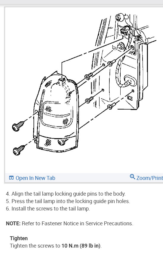

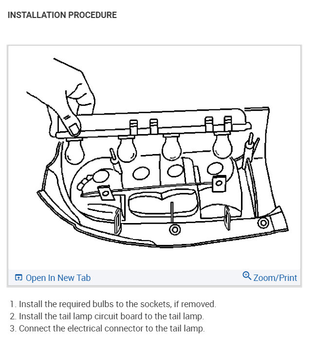

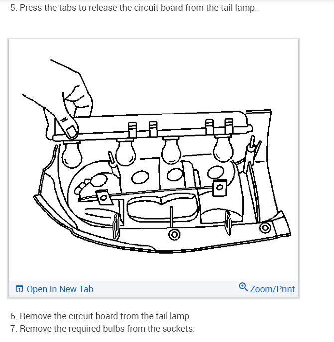

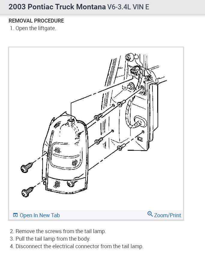

I would start by removing the rear taillight sockets and removing the bulbs while looking for a burned connector. Check out this guide which can help walk you through the problem. I have also included the wiring diagrams so you can see how the system works.
https://www.2carpros.com/articles/no-tail-lights-exterior-running-lights-tail-lights-out

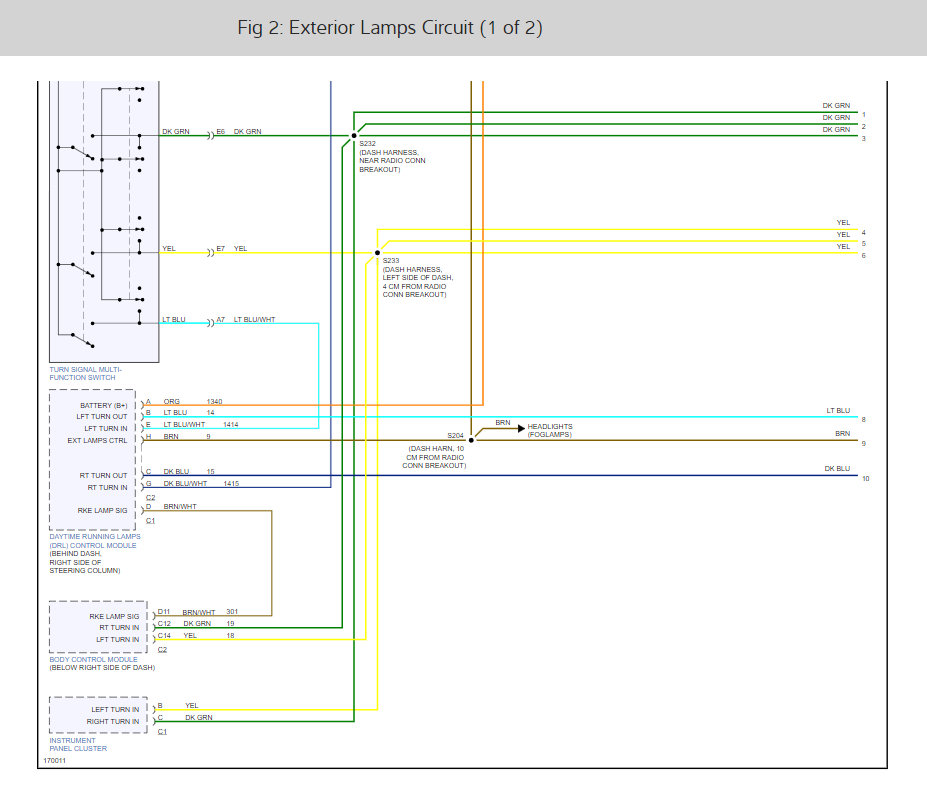

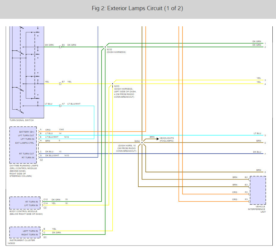

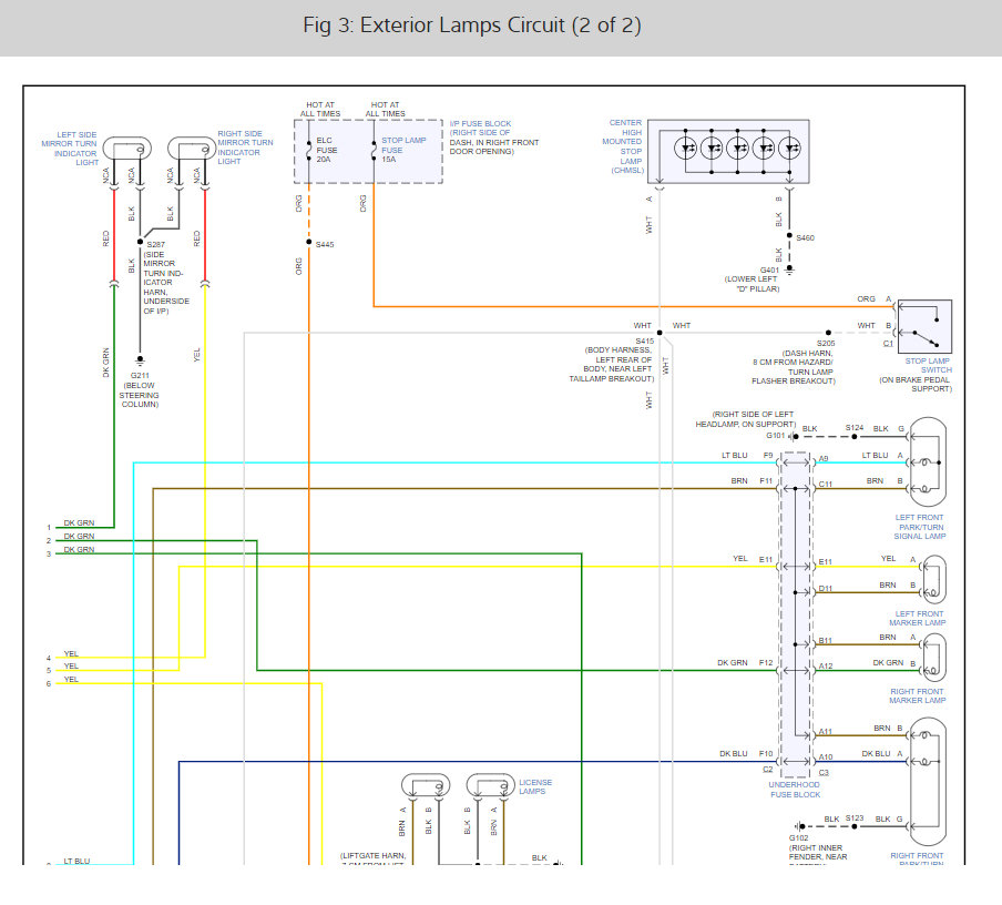

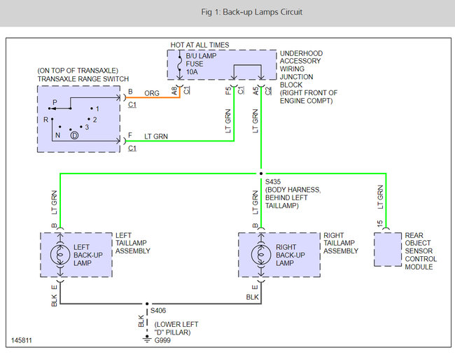

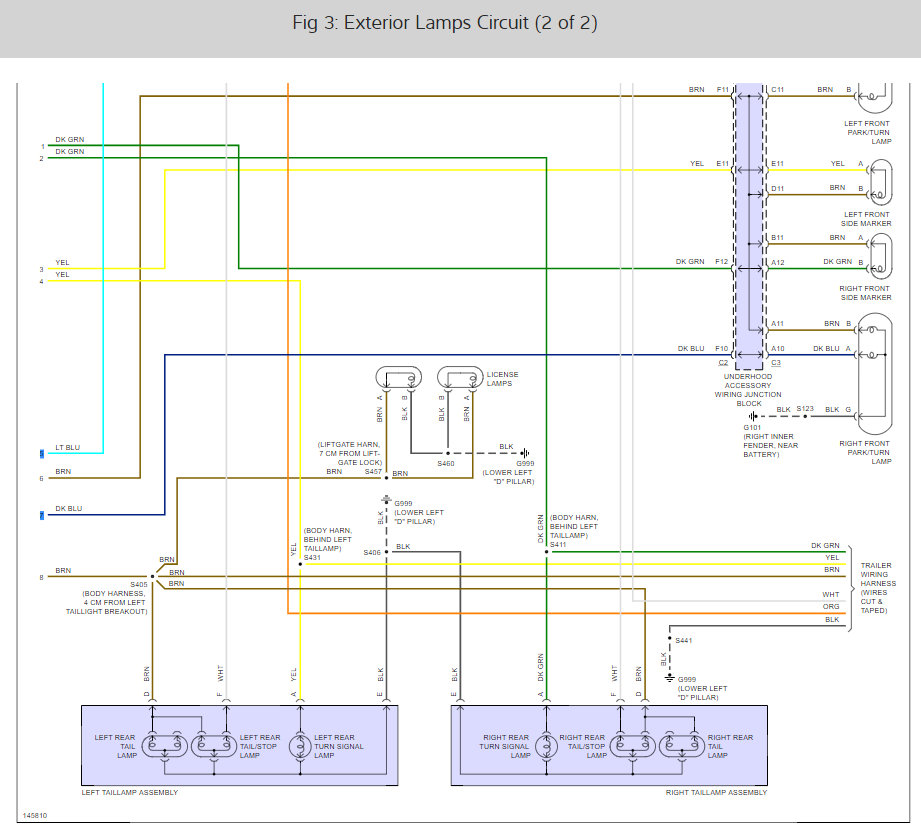

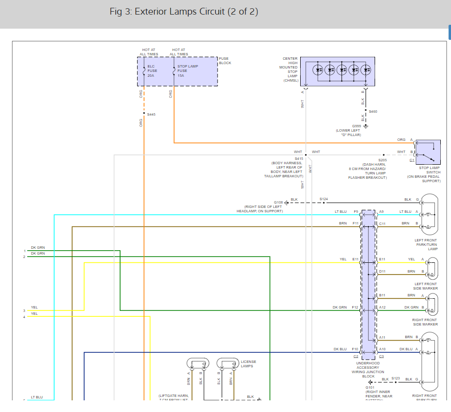

Sorry to hear about your troubles. can I ask did these problems start right after having the new engine put in? and when you say where the fuses plug into not so good why is that can you upload a picture? The reverse lights do not run through the BCM so it cannot be all of it if it was the problem. Has the car had any water problems like in a flood?

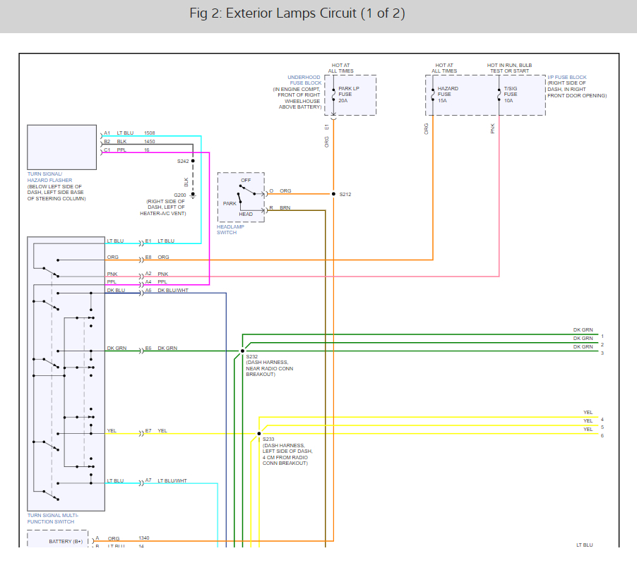

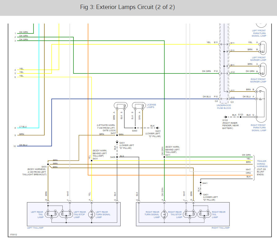

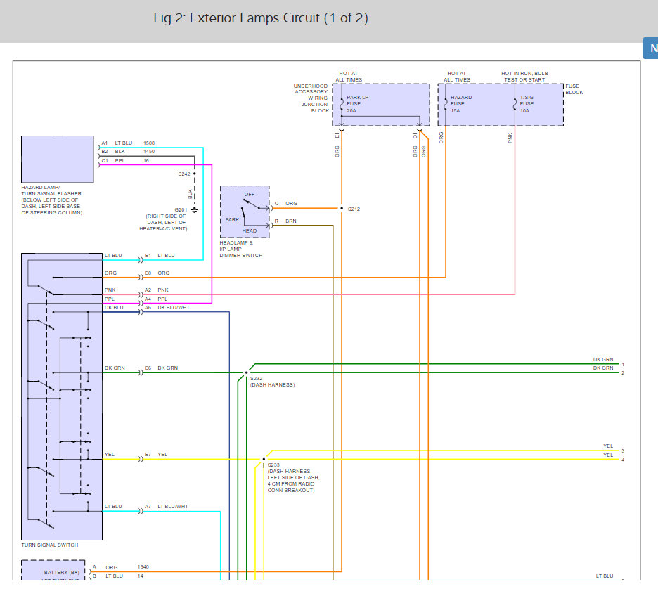

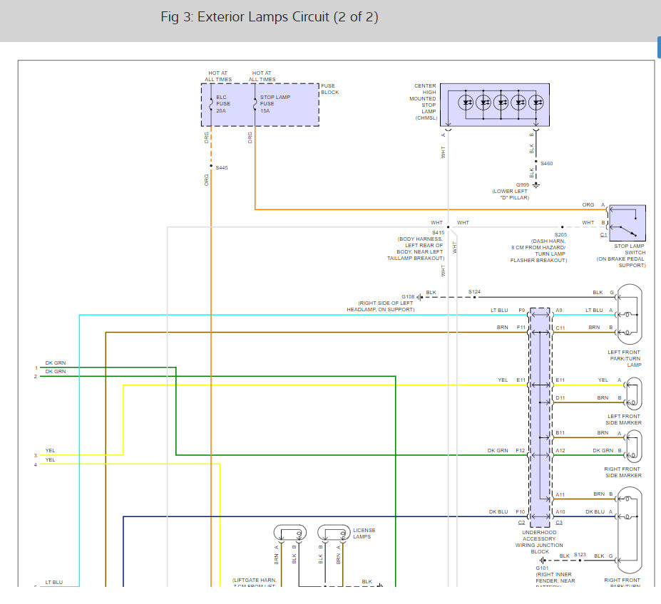

Here are the exterior light wiring diagrams so we can get started and see how the system works. (below)

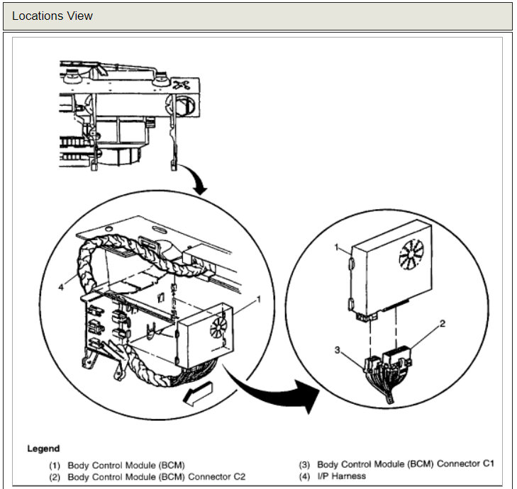

I am leaning toward the BCM causing all of your problems because most of the things you mention are ties to it.
Here is the location you might be able to get a used one without having to program the unit to the car
Here is its location so you can check it out.

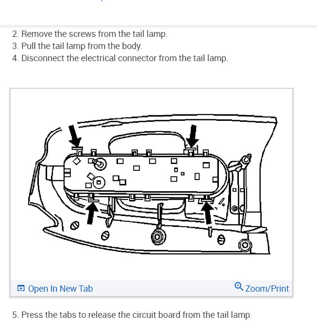

Ok I have some new information to share with you.
I looked at the tail light circuit boards to check if there was any melting or shorting. No evidence. I replaced the drivers side one with a new one (I bought 2 when I replaced the passenger side). I put a new 20amp fuse in. I turned on the lights manually with the **** and BOOM, fuse blows. Any ideas? I'm a novice when it comes to vehicles but I understand most of what I'm told to do. Any other advice would be greatly appreciated.

We tested the hook up to the tail light board and we are getting power for
Brake, Turn, and reverse but no power for a tail light. So we assume the circuit boards are good.

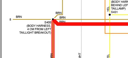

Check splice connection G-405
https://images.2carpros.com/forum/automotive_pictures/12900_splice_3.jpg
