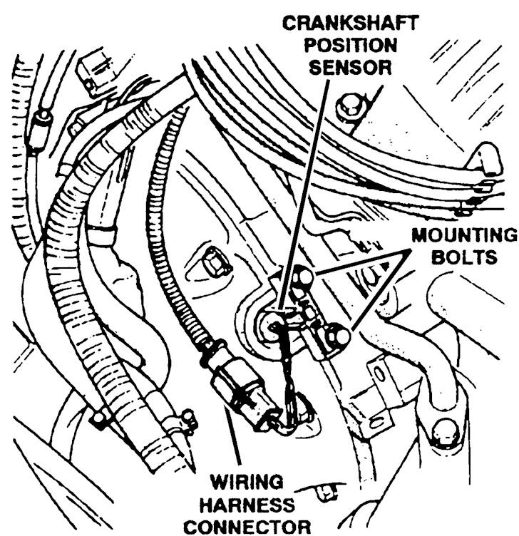

Your crankshaft position sensor is in the transmission bell housing, right behind the right cylinder head, but as I mentioned, it has to be working if you have spark. The first thing you must be aware of is if the battery is disconnected or run dead, the Engine Computer loses its memory. Same is true when you disconnected the computer. Chrysler Engine Computers have an extremely low failure rate, so that should be the last thing on your list of suspects. Fuel trim data will be rebuilt as soon as you start driving, but you have to perform a procedure to relearn "minimum throttle". Until you do that, you may need to hold the accelerator pedal down 1/4" for the engine to start. You will not get the nice 'idle flare-up" to 1500 rpm at start-up, and it will tend to stall at stop signs. To meet the conditions for the relearn to take place, drive at highway speed with the engine warmed up, then coast for at least seven seconds without touching the pedals.

Crank sensor is on the top right side of the bell housing/engine flange area. Simple two wire sensor.

If i loosen hose clamp at throttle body gas will shoot everywhere gas is there under pressure at throttle body. Cannot find crank sensor or two wires going to bell housing area found three sets of wires going to transmission. looked multiple times unless it is on the very top where there is very little clearance. I am thinking when i had volt ohm meter in injector caps seemed like i was getting like one volt. it would barely move the mechanic had his test light in cap while i turned it over i thought he said it was pulsing? All along I have thought broke wire somewhere,or the hidden crank sensor?

Thanks for the image of crank sensor. I will try again. thank you so much i have got to get my truck going it is a utility truck with all my tools. If i do not have it it is hard to work.

no crank sensor found anywhere. there is not a place where i can find two bolts together that would hold one there is a female plug empty beside distributor with two wires. mechanic said no pulse on injectors. when i turn switch off an on it blinks slow then fast do i group number of blinks in two's and count until they stop or does it recycle the blinks? it had 123311312323 and i quit counting did not know if recycling or still giving codes.

finally got it to crank and run will idle but doesn't wont to take throttle finally drove 2 miles down and 2 back backfired multiple times. buddy looked 1 injector not working pull out put back in then other injector quit firing wont do anything again. codes after running 15 minutes were 12 33 24 27 55 when i turn key on have 62 lbs. fuel pressure.fuel leak fixed. my buddy said thought crankshaft positioner was by harmonic balancer there is a bracket there with an empty plug above it.

That's not the crank sensor. That is a holder for a dealer-only timing tool. I worked for a very nice family-owned Chrysler dealership through all of the '90s, and never saw that tool or needed to use it. The one you're referring to at the vibration damper is a GM thing on some of their engines.
