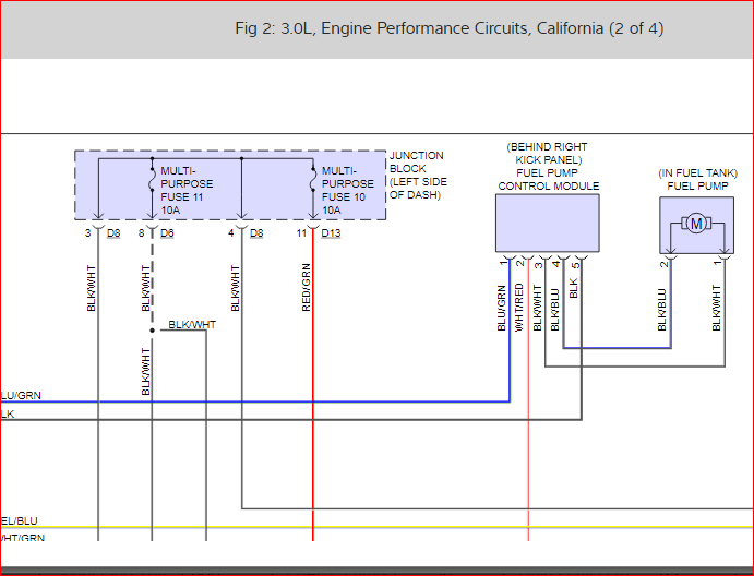

I have the sport model. I got the car and it had a broken timing belt, when it broke it bent all the valves, so I replaced both heads and cam and crank sensor as the belt ripped the wires when it broke, I got the car to start and run, but it developed a very unusual problem, sometimes when I was driving it would just shut off even a cruising speeds, I would coast to the shoulder and it would start right back up, then one day we went out turned it off and did our errands came out and it would not start, so had it towed home, I checked I was getting spark but no fuel, replaced fuel pump, still no fuel, checked no power to fuel pump, so at this point I've replaced, PCM, immobilizer, key switch and key all programmed together, fuel pump replace, MFI replay, fuel pump control module I have no codes at all. I found corrosion on the wiring just above the relays, as the harness comes out from the firewall, took the harness apart and the wires looked corroded and spliced not factory, order a used harness off of eBay installed it, everything fits. But no plug for the fuel pump control module.so I am not sure what to do at this point.

Okay, so do you need the wiring diagrams for the fuel pump system? Are you sure you got the right year/model harness? Hope this helps and thanks for using 2CarPros.

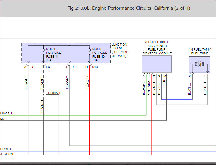

Hello again,

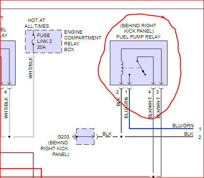

Here are two pages of the wiring diagram for the fuel pump system.I magnified for you to see better.Hope this helps and feel free to ask any other questions.Thanks for using 2CarPros.

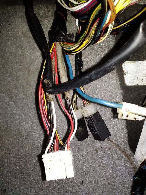

NJOEHOW
  • 19 POSTS
Hi Danny,

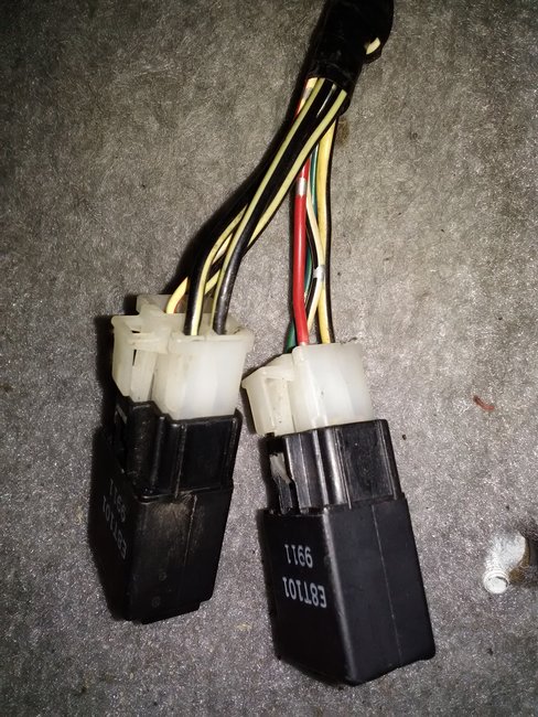

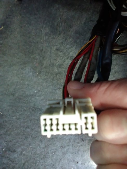

Okay. So I got under the passenger side of the dash and checked out the wires were the MFI and fuel pump relay are so there is no plug for the fuel pump control module only this plug, I unloaded pics of the plug in question, van you identify this plug? Its right there by where the fuel pump control module plug should be, everything else is there and plugs in and fits. thanks for your help.

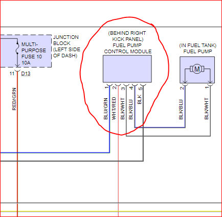

Hi Danny,
Was wondering if you could tell me where does the white/red wire go from the fuel pump control module? Your schematic shows all the other wires but that one. thank you
Dec 19, 2018 at 3:25 PM
DANNY L
  • 5,648 POSTS
Hi Joe.
That wire plugs into pin #21 at the PCM (Powertrain Control Module)

Danny,
Okay, great thank you. any ideas on the electrical connector I sent you pictures of?
Thank you
Dec 20, 2018 at 7:38 AM

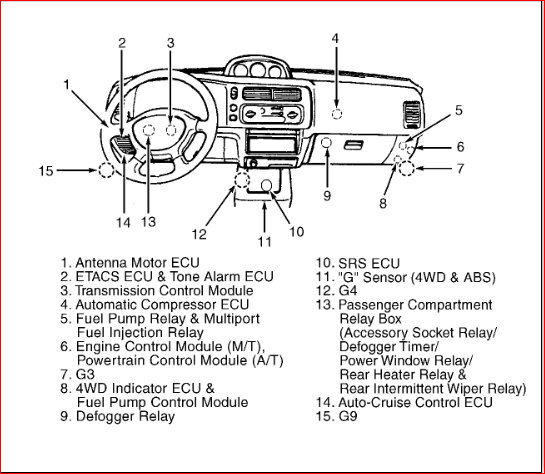

DANNY L
  • 5,648 POSTS
Hello again.
Did you check to see if it might be a harness to connect to the HVAC box or blower motor? I've attached a photo with harness/connector information.Hope this helps and thanks again for using 2CarPros.

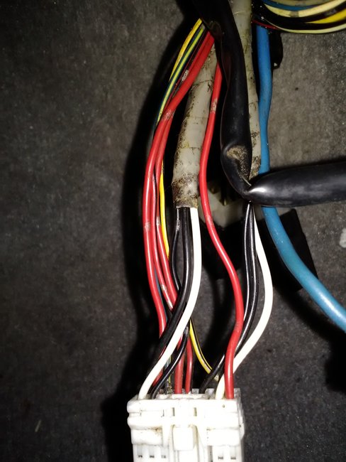

DANNY L
  • 5,648 POSTS
Hello again.

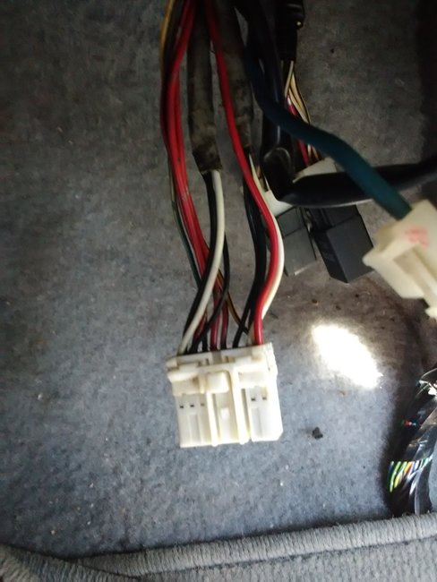

The picture is kind of dark. Can you take another picture showing the wire colors on the undetermined plugs? If you upload another picture I'll trace the colors on a wiring diagram. Hope this helps and thanks again for using 2CarPros.

NJOEHOW
  • 19 POSTS
Danny,
Here are better pictures:

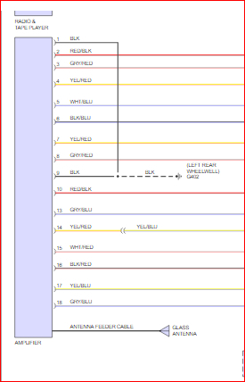

DANNY L
  • 5,648 POSTS
Hello again.

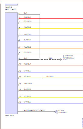

Another question. Does this have an aftermarket or stock radio? After looking at the radio wiring diagram it looks like the factory radio amplifier harness.. I've attached a picture of the diagram. See if the wire colors match.Otherwise I'll keep looking.Hope this helps and thanks again for using 2CarPros.Happy Holidays!

DANNY L
  • 5,648 POSTS
Hello again.
It sort of looks like the factory amplifier connector. Hope this helps and get back to me.Thanks again for using 2CarPros.

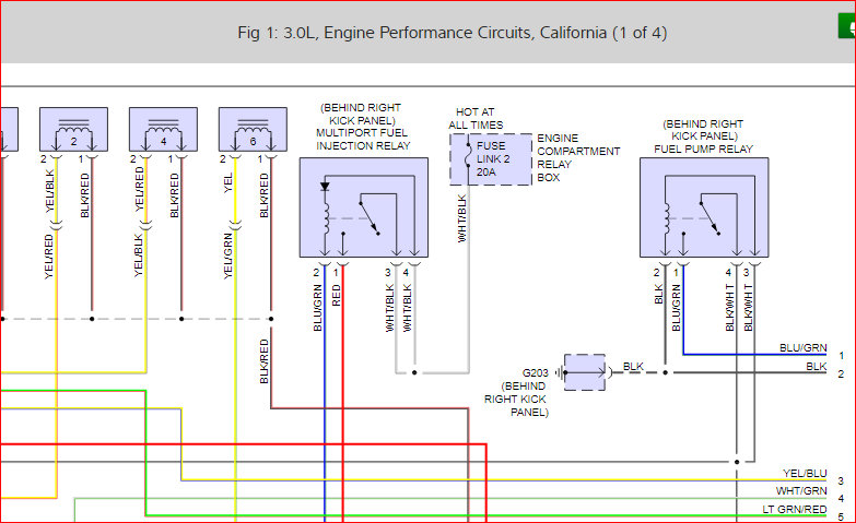

It only shows having both fuel pump relay and fuel pump module. Both behind right kick panel. Pictures with wire colors below.

DANNY L
  • 5,648 POSTS
Hello again.
The thing I've noticed looking through the wiring diagrams on a 3.0L the fuel pump control module only has four wires and on the 3.5L it's five wires.I'm still looking to find where this harness goes.
