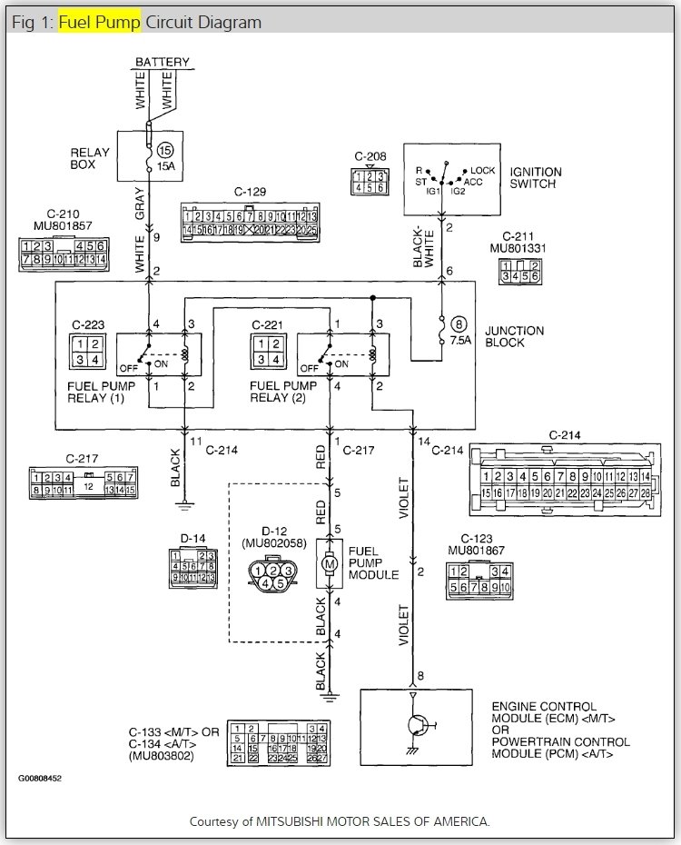

ok so after having someone else in the back that knows what they are doing... .. i do have power to fuel pump with wire ran from pos and neg of the battery to the fuel pump and it starts.. before i said it wouldn't start regardless.. i was wrong it does start with straight power and turn of the ignition.. my question is... is there a fuel pump modular between the battery and the fuse block?
Jan 6, 2019 at 12:03 PM
  • 55,433 POSTS
Hey,
I have this complete wiring diagram for the fuel pump for you. Please check the trigger wires and power sources.
Let us know what you find
Best, Ken
CARADIODOC
  • 34,381 POSTS
They gave it a double whammy. The first relay turns on when the ignition switch is on. The second one turns on when the ignition switch is on AND the Engine Computer turns that relay on. If either relay fails to turn off, the other one will handle that.
What I would do is remove relay number 2, then connect terminal #4 to terminal #1. The fuel pump should run by just turning on the ignition switch. If it does, there's one other test, but the definitive test is to stick a tiny piece of wire into terminal #4, reinstall the relay, turn on the ignition switch, then the pump should run when you ground that wire. If it does, the Engine Computer isn't turning it on during cranking. If the pump DOESN'T run, the circuit can be left like that for troubleshooting.
