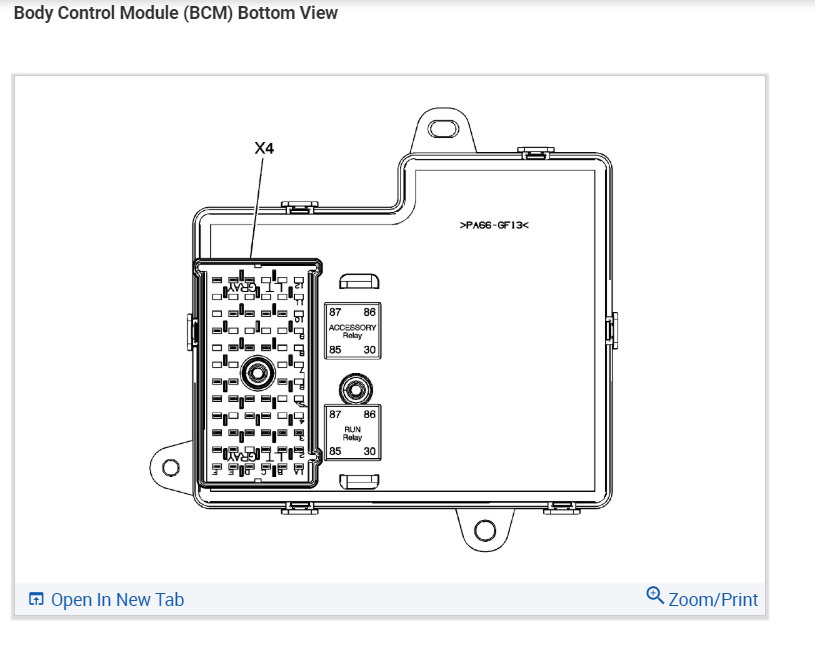

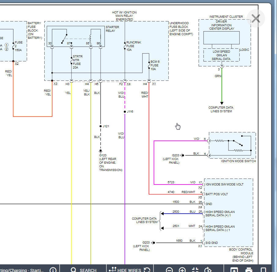

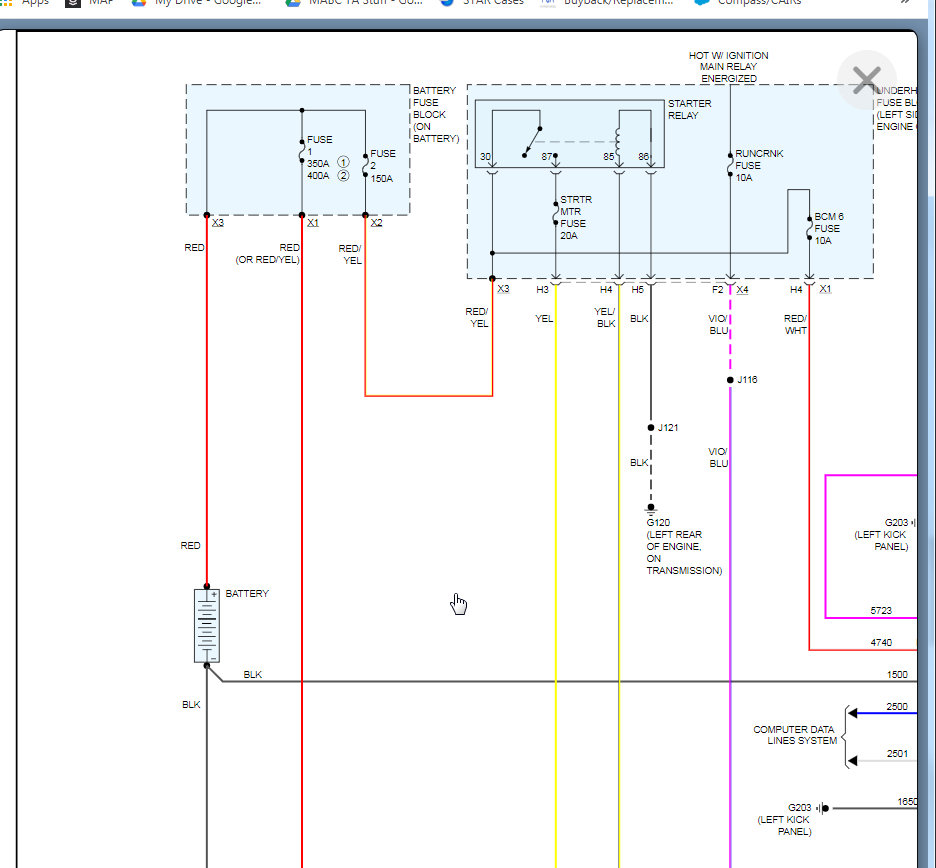

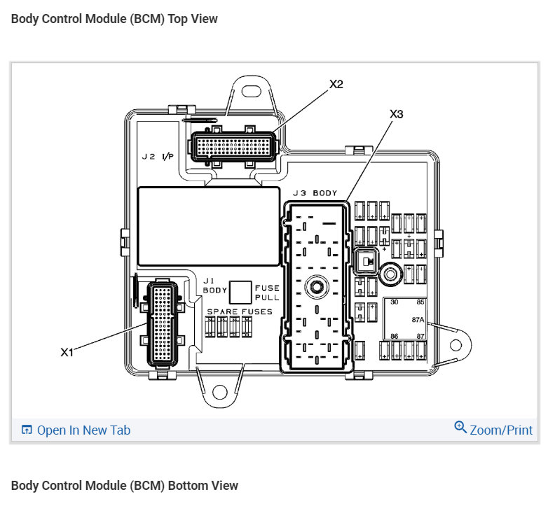

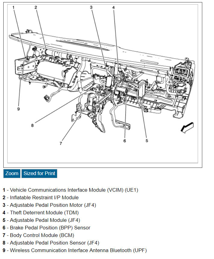

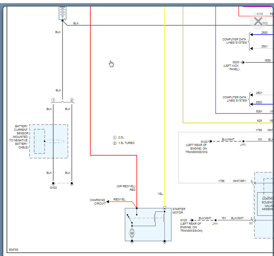

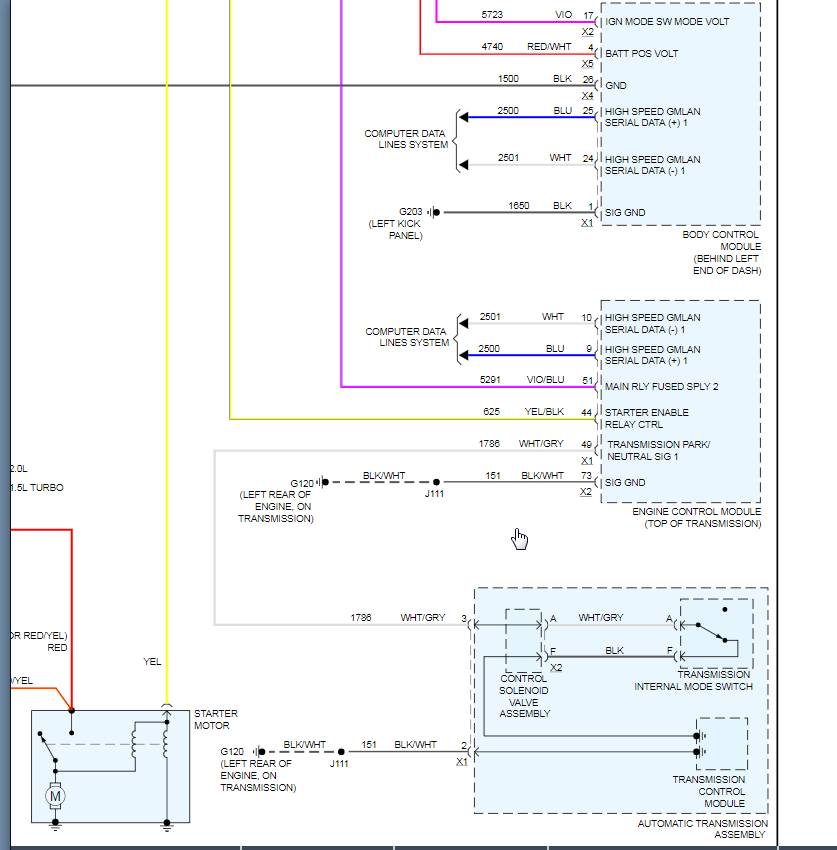

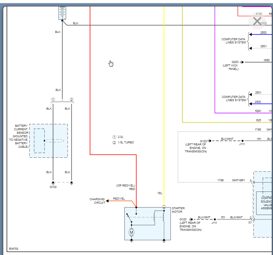

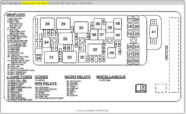

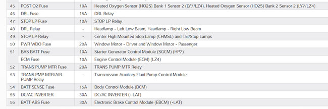

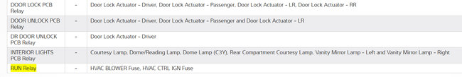

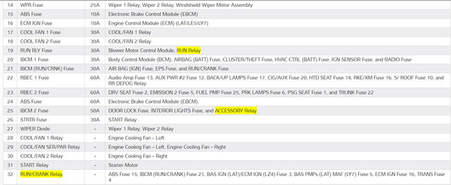

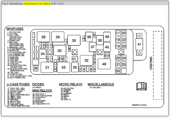

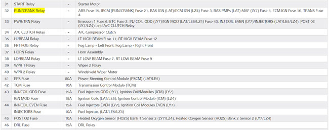

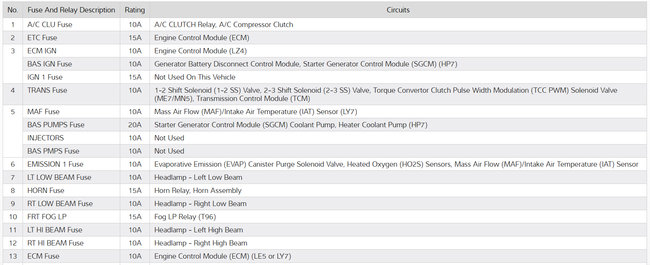

No access to vehicle link to pull codes out due to no power to ignition.fuses not blown but didn't jump any relays.Just wondering if relays power the fuse for ignition or blown fuse box?
Jun 23, 2019 at 7:22 PM

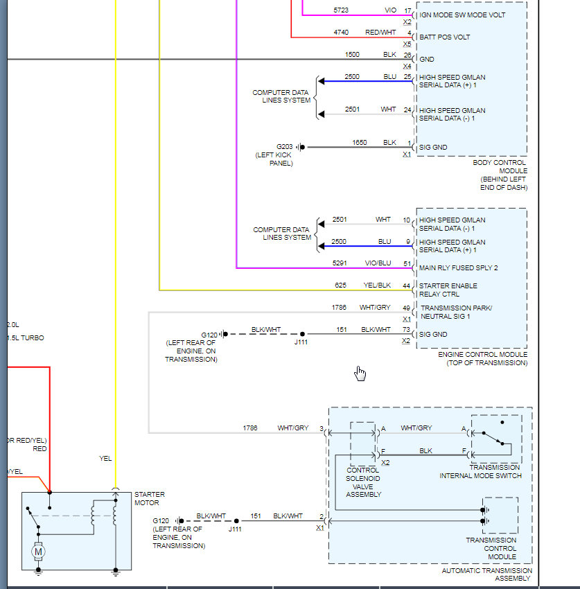

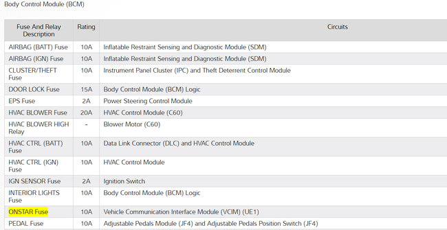

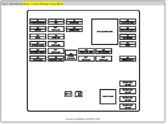

If I understand this issue then you are not able to pull codes because the ignition will not turn on? If that is the case, then we need to check power going to the body controller because the way this works, is the BCM just gets the switch button input and it is literally just an open closed switch. So when it is close, the BCM sees 12 volts on the ignition mode switch input and that tells it that someone just pressed the button.
So this means we need to make sure Fuse BCM 6 is not blown. If it is not, then we need to check for voltage on the BCM connector X2 pin 17. This should have 12 volts when you press the button. If it doesn't then you need to replace the ignition mode switch. If it does then there is an issue with the BCM.
Here are some guides that will help with this:
So when the BCM gets the input signal from the button it sends that info to the PCM and tells it to start the engine.
Let's run through this material and find out what we have and we can go from there. Thanks

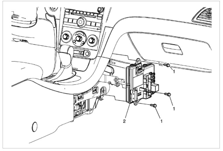

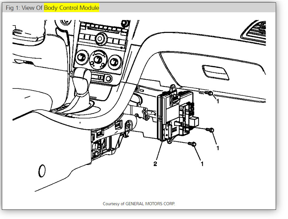

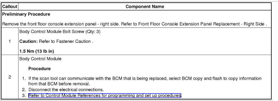

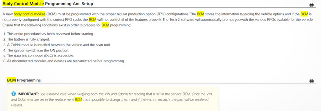

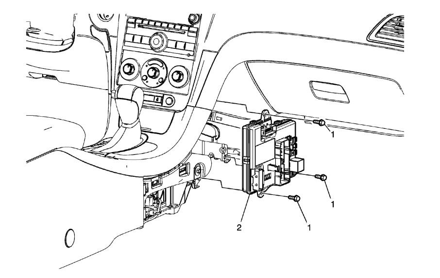

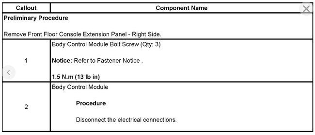

Installing floor mats on front passenger side of vehicle. Accidentally drilled into the wire harness next to console on front passenger side. Cabin partially filled with smoke. Several wires were affected. All four power door locks quit working. Heater blower fan also quit working. Spliced the affected wires and now the blower motor works on three of the four lower settings but not on high. The dome light in center of head liner also does not work. The remote key will not open door locks, the switches on inside panels of doors will not unlock doors either. When lock and unlock are pressed on the remote you can hear a relay click under the dash. There are no fuses blown in any of the three fuse blocks. Help?
Feb 8, 2021 at 2:04 PM (Merged)
  • 54,837 POSTS

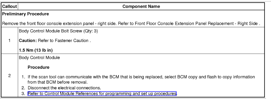

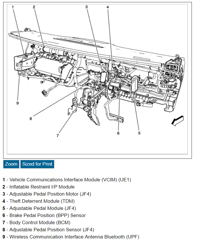

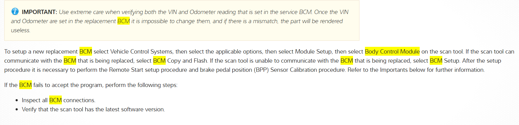

Bummer, I had to hang a picture on the wall put a wood screw right into a water pipe, yep I feel your pain. :) If you fixed the wiring and all fuses are good it sounds like the BCM has blown out here is its location you will need to have it programmed in at a shop it should cost about $130.00 once you have the new one here is the BCM location.

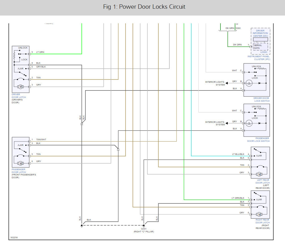

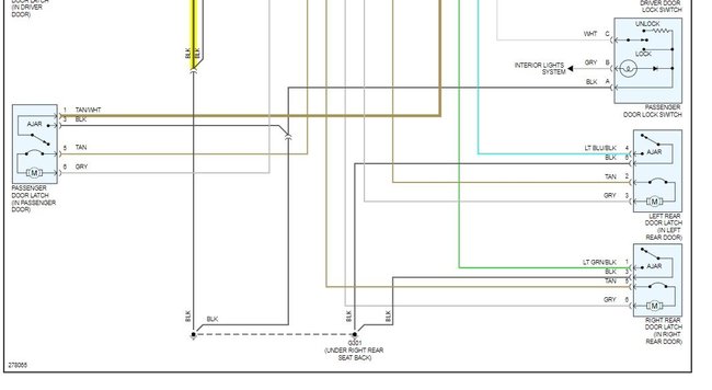

our malibu brought new....the strangest thing happened the car is in park and i...the passenger tried to get out..and the door would not open...the unlock and lock mechanism works ...meaning the door lever goes up and down when the door lock button is pushed but the door will not let you out? this occurs on the driver side as well!! so we had to crawl out the back doors!!! also ...sometimes the doors will not shut tight...they bounce back open??? any suggestions...we are going to the dealership in a few days to have it looked at....i would also like to mention that this problem doesn't always occur everytime ... thanks
BASSTECH
  • 236 POSTS

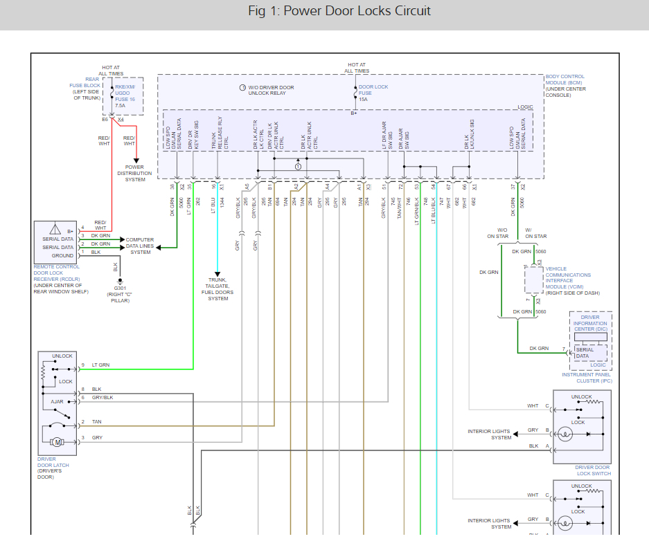

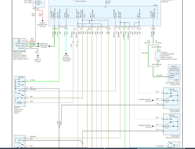

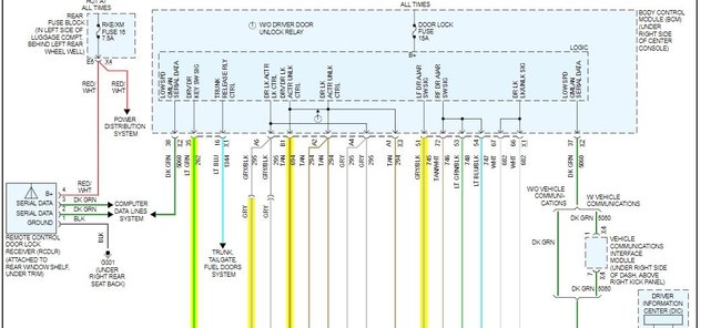

G.M. does have a bulletin discussing that issue with the rear doors, but it could still be the same problem with the front doors. they will most likely need new door latches. Let me know how you make out. Here are the door lock wiring diagrams so you can see how the system works. It could be the BCM causing the issue as well. Here is how you replace it. A CAN scan will help tell for sure.

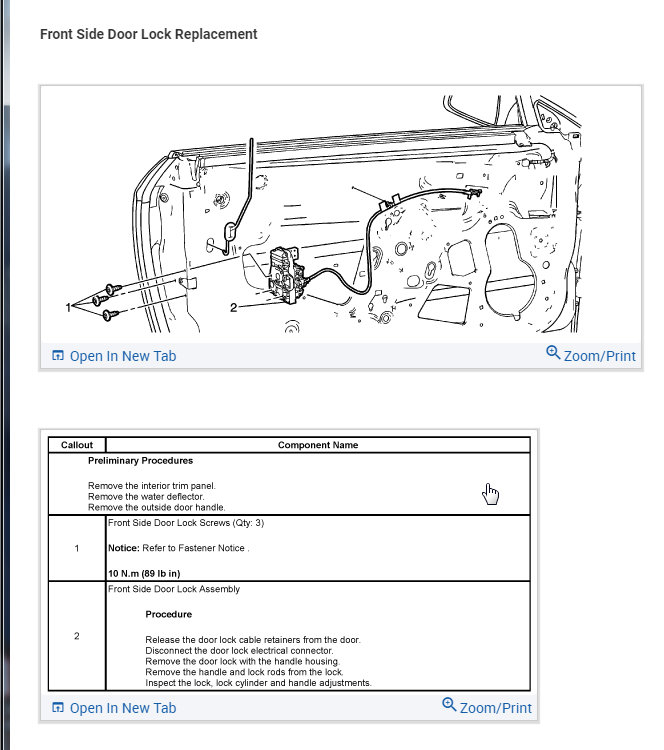

DIYPATTYJ

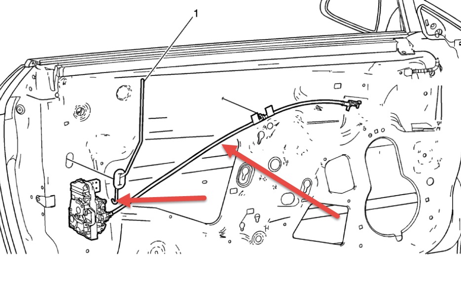

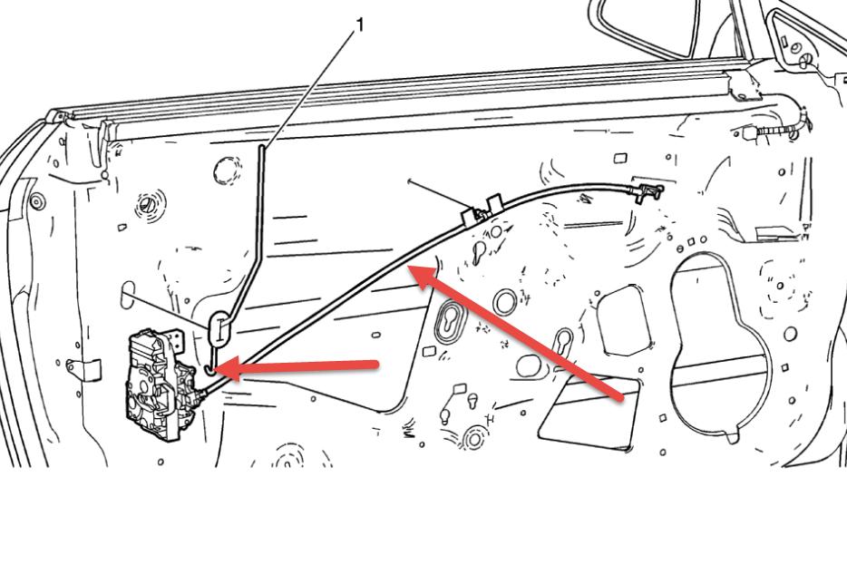

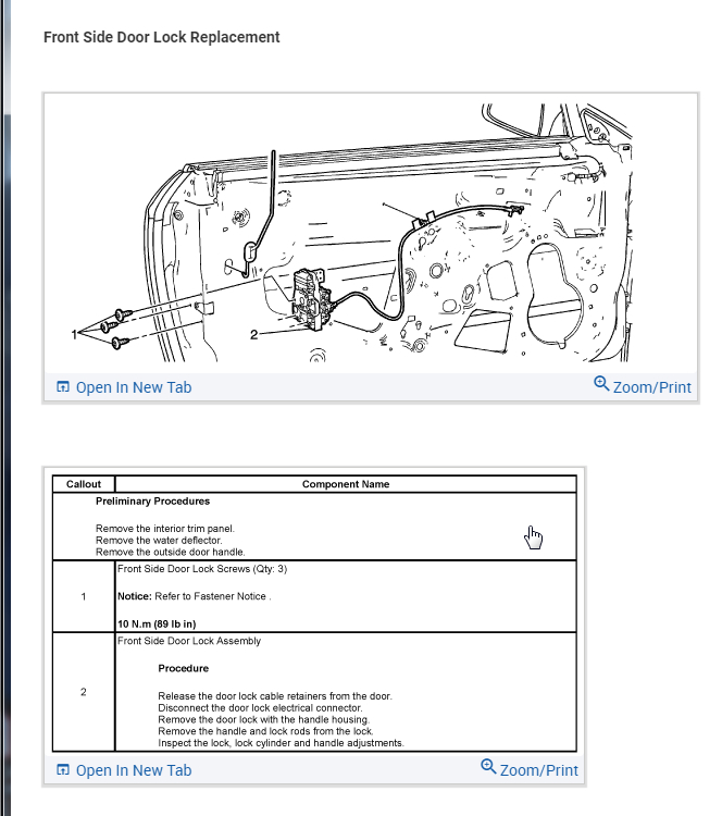

Temporary solution to passenger latch not responding to handles (inside and out) but manual locks responding to lock/unlock button: I have an 2008 Malibu LTZ and my passenger door did this. I did some research and what worked, for now, is slapping the door panel a couple of time right above the handle, lol seriously. Can’t get the panel off To fix the latch if the doors shut, am I right? Before the slapping, a suggestion was that the latch is stuck in between lock/unlock and to just lock/unlock the door a bunch with the manual lock. But that wasn’t doing it for me.
My drivers door lock/unlock button isn’t responding, though also,separate issue, I believe.
These issues are most likely the same issue. If the lock button is not responding but the door doesn't unlock or lock then it is most likely caused by a faulty actuator. The slapping of the door panel was getting it to operate then yes, it is sticking. That is not uncommon for these when they begin to fail.
I attached the process and as you can see, you do need the door open so I would suggest you get the door open and then make the repair. If you cannot get the door open then you may have to cut a hole in the panel to unlock it so we don't want to push it with the door not opening.

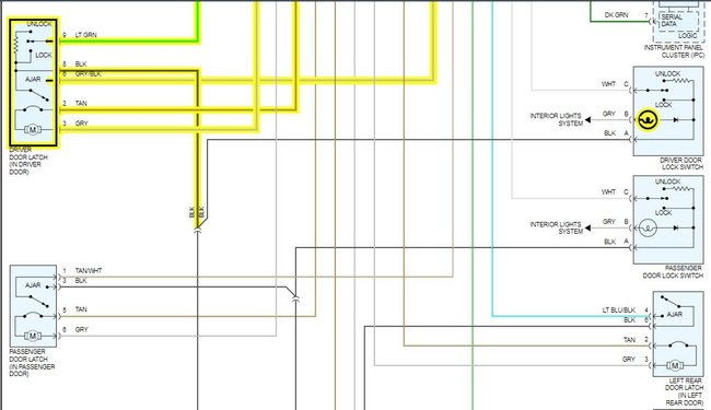

Good afternoon,
The locks are controlled by the body control module. The switches send a signal to the module and then the locks will work from the module.
If you have a scan tool, you could monitor the live data in the BCM to see if there is a signal sent from the switches.
If there is, then the BCM is the issue.
If there is no signal, then it is the switches.

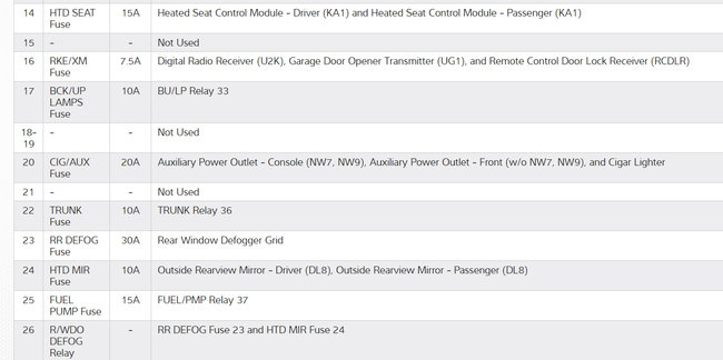

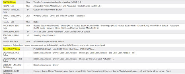

Automatic door locks will not work with key fob.
Feb 8, 2021 at 2:06 PM (Merged)
  • 54,837 POSTS
It sounds like you have a fuse out or the fob has gone out. I would stat with the fuses.
Here is a guide to get you started:
Below are the fuse locations.

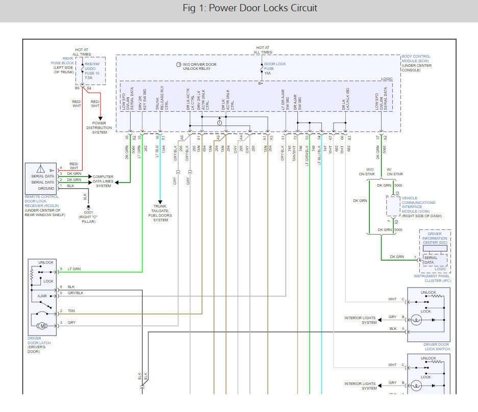

Good morning,
This sounds like the body control module.
When you command lock and unlock, the signal goes to the body control module and then the module commands the locks to work.
When it malfunctions, it does this exact issue.
I would have this checked with a shop to confirm. they need to access the module and watch the commands.
