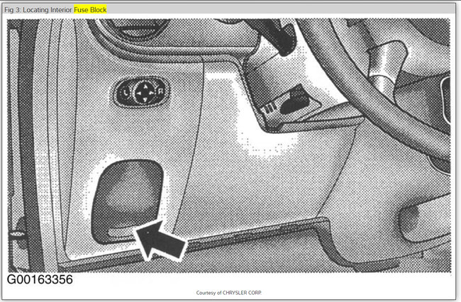

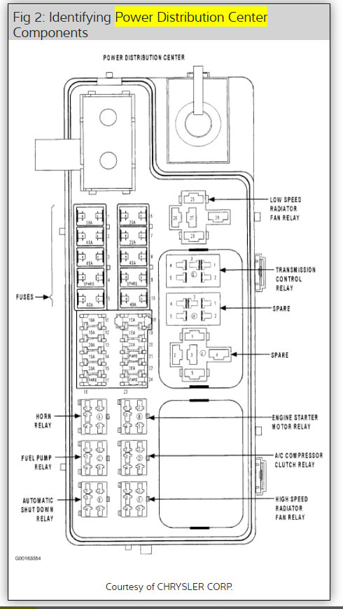

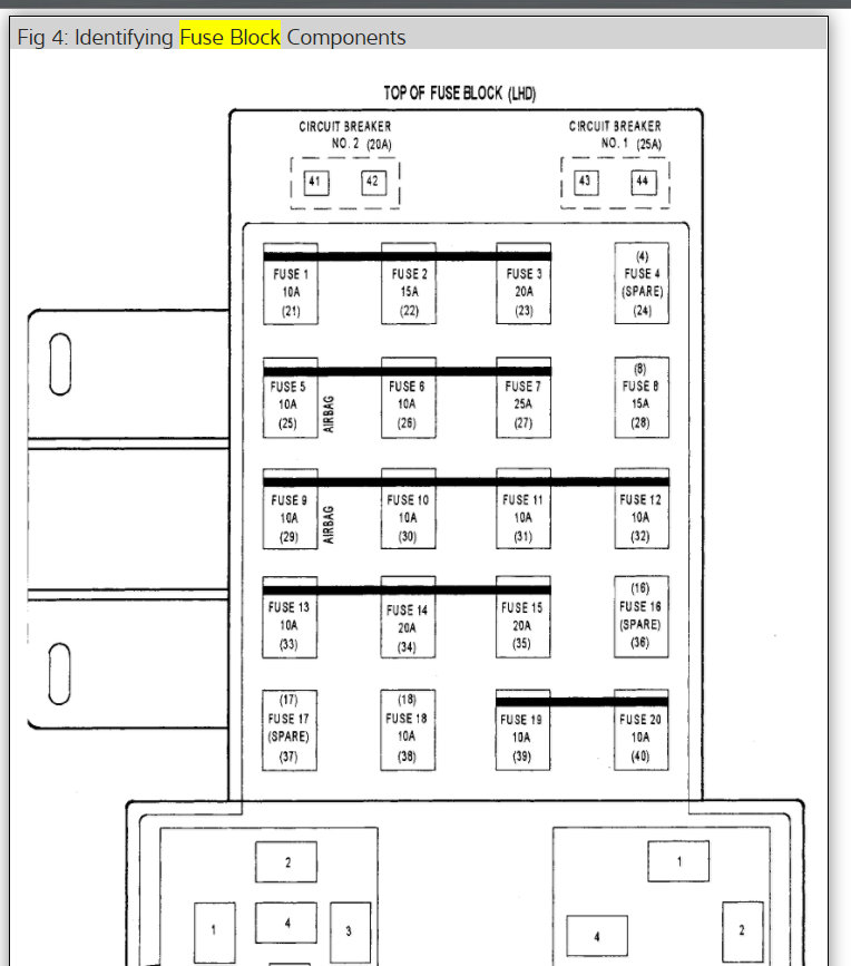

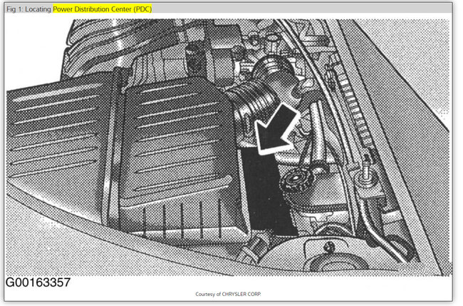

I had lights i cleaned my battery cables. Now there are no lights.
Apr 27, 2022 at 8:37 AM
  • 55,732 POSTS
It sounds like you had a voltage surge when you reconnected the battery cables which happens, let's start by checking all the uses in the under-hood and interior fuse panel. here is a guide to help with the fuse locations in the diagrams below:
