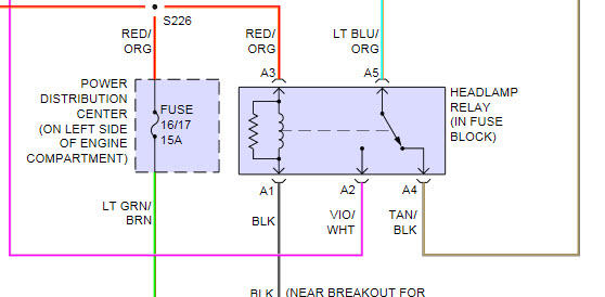

Headlights, power door locks and dash lights do not work. No blown fuses

the headlights(low and high beam), power door locks and dash lights do not work and when using RKE it will not lock the doors or open them. No running lights either

check battery for rke and take to auto parts they can check to see if it works. see pic for items to check for headlights as well as all fuses in car. then have scanned for codes may be a body module a pro has to do it.
