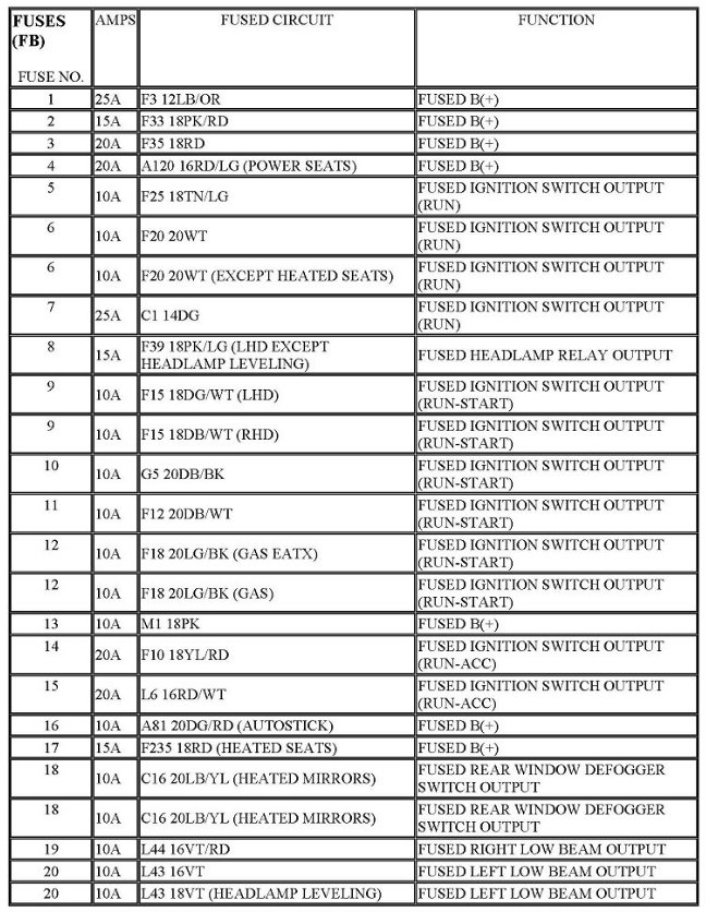

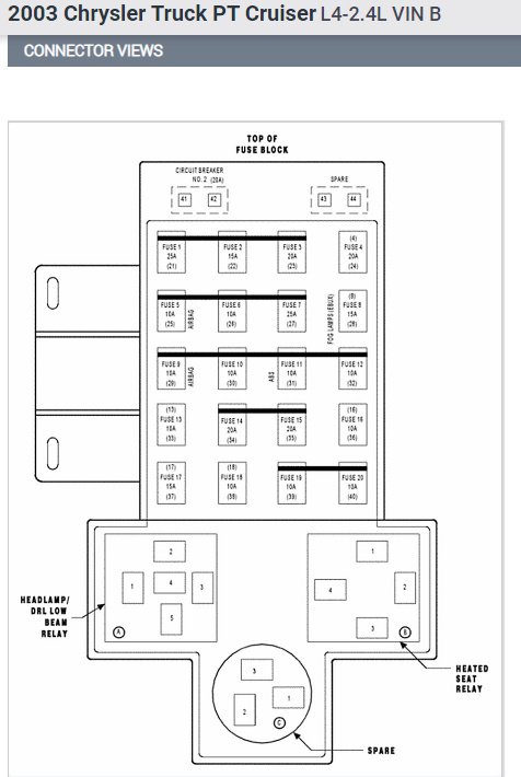

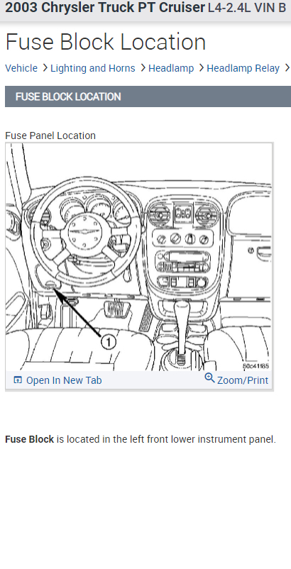

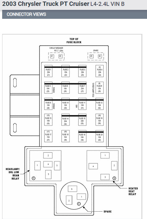

Headlights and door locks not operating. Looking for headlamp relay but unable to find it. Thanks
Oct 19, 2008 at 9:54 AM
SQM
  • 6,383 POSTS
The headlamp relay is located in the fuse block that is under the driver side dash (see picture below). You can test the relay to verify if it is bad.

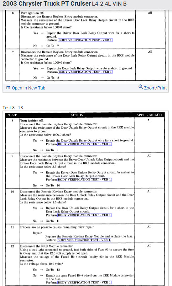

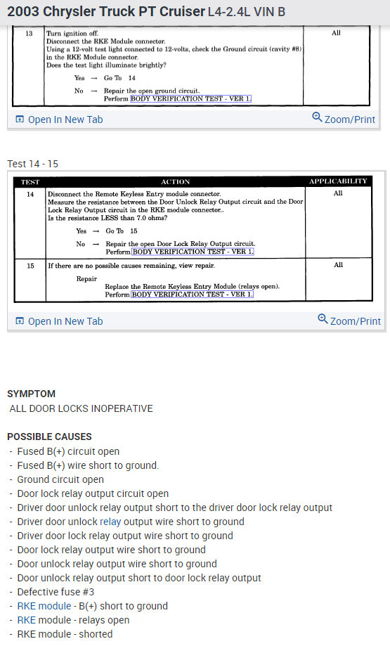

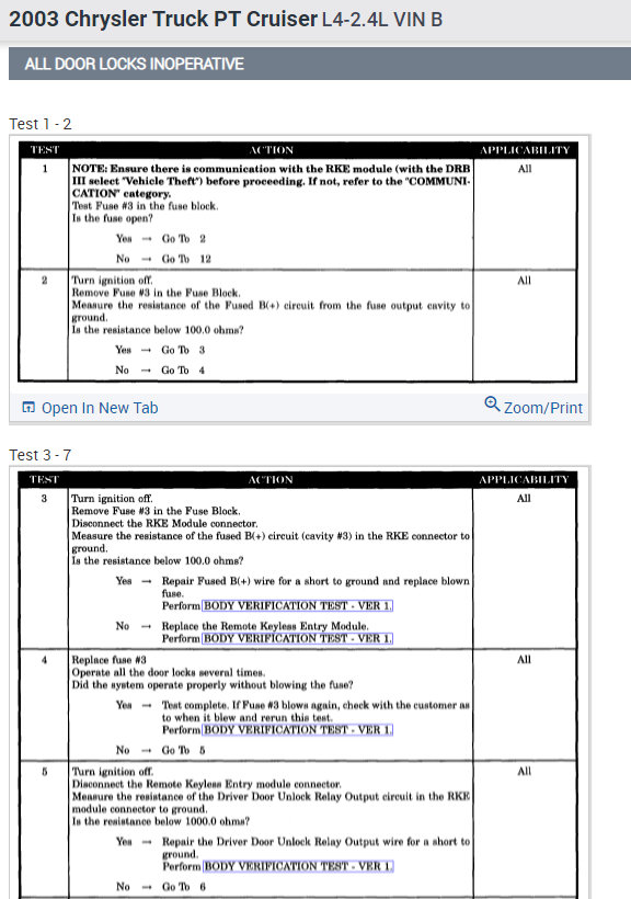

Did both the door lock and headlight stopped working the same time?
Are you able to unlock any of the door or just the driver side?

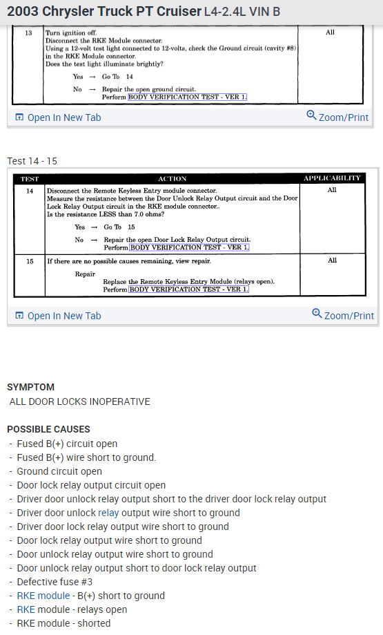

I have attached the fuse block diagram for your reference. Also included the diagnostics procedure for the inoperative door locks.
