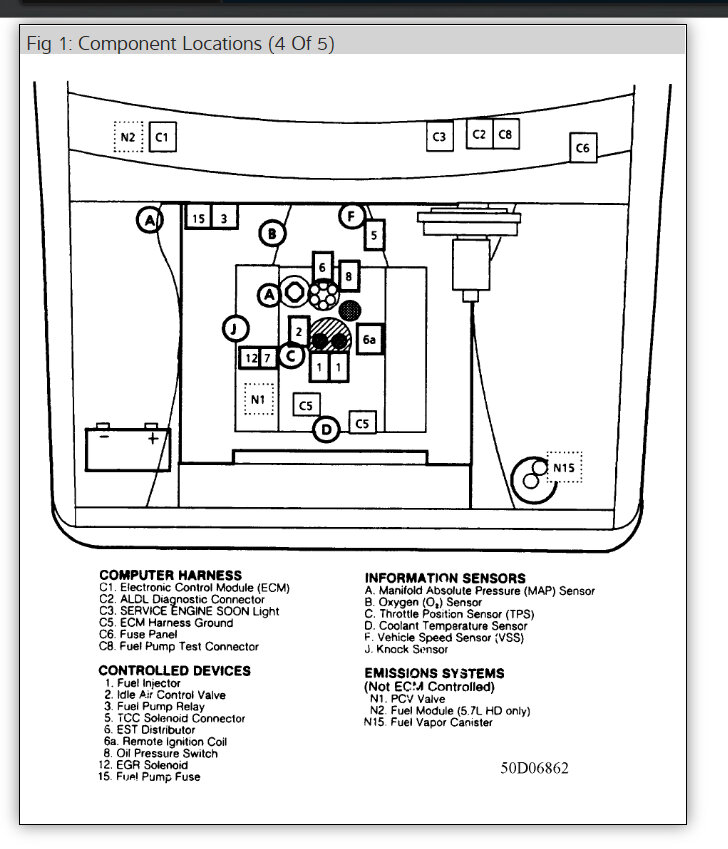

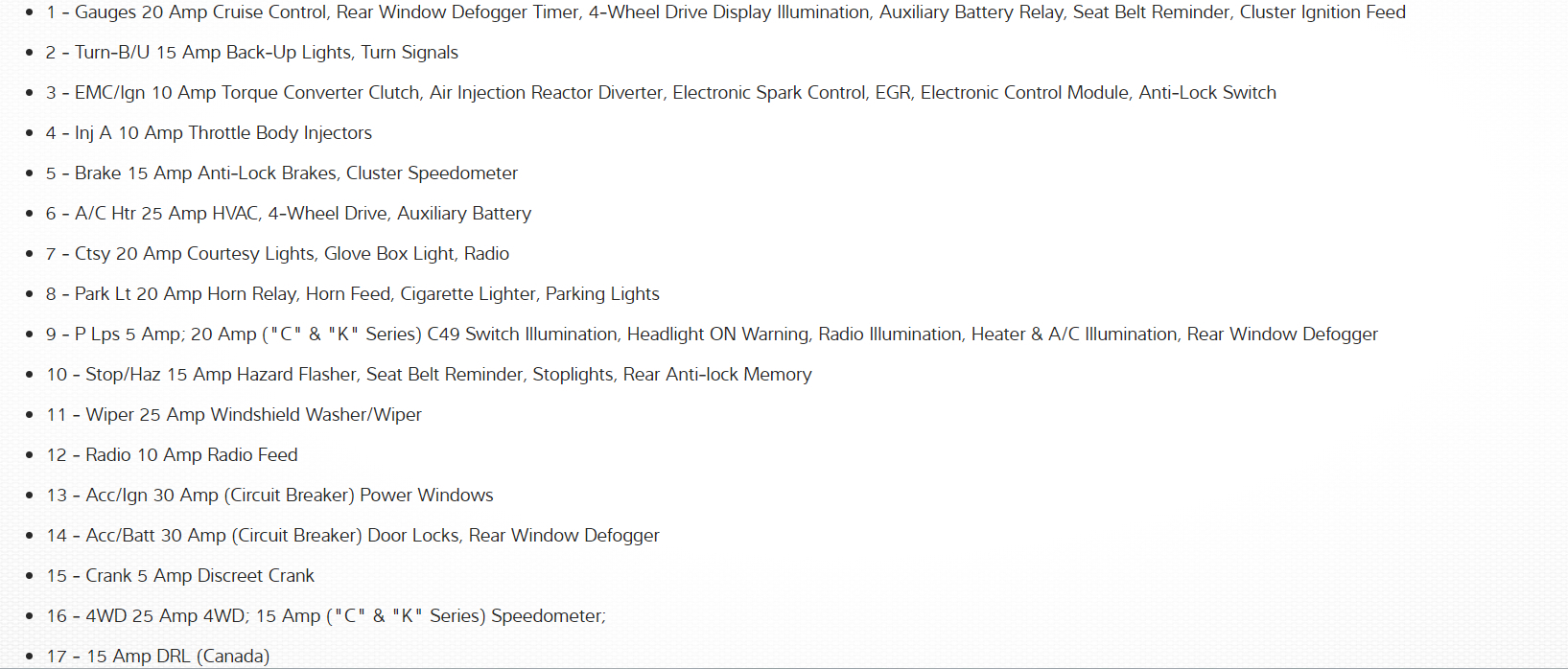

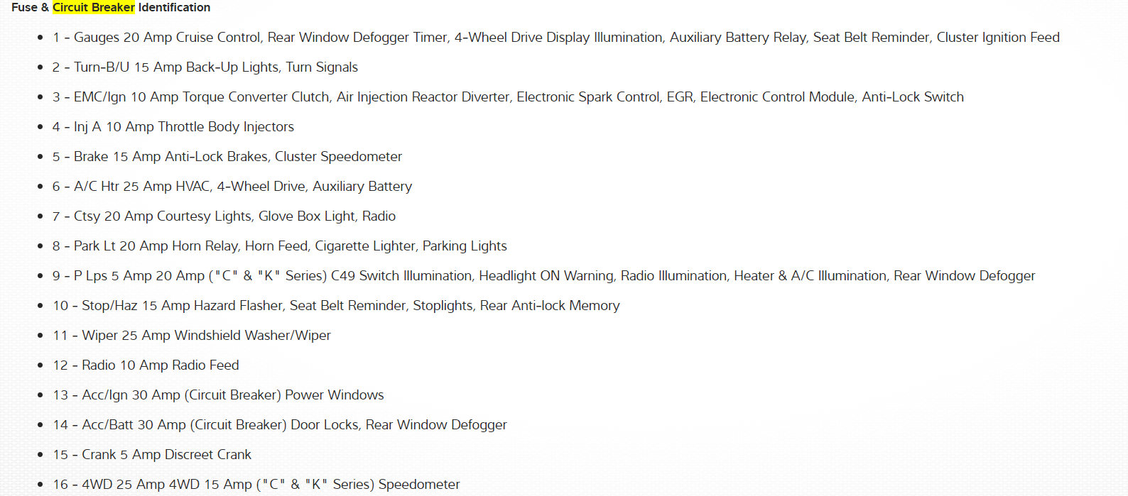

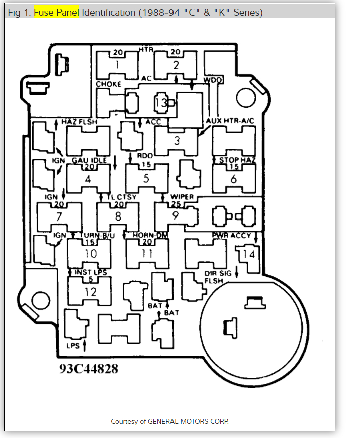

I have a new distributor and components, new fuel relay; new spark plugs and wires. I’m on TDC I have fuel to TBI but no fuel in bowl I checked injectors, and they have pulse. I disconnected the HEI bypass and got fuel but if I continue it no fuel. Could it be the TBI fuel regulator the wires going to the injectors and the bypass what is up with that I’m thinking two different things.

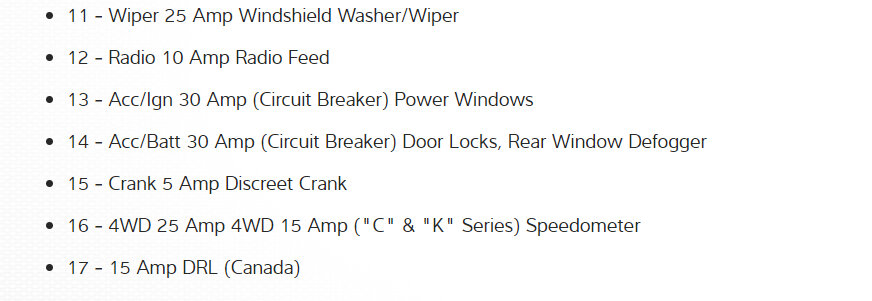

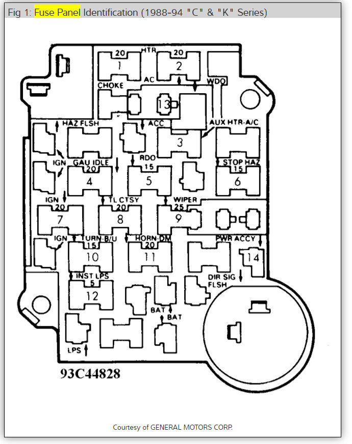

The first thing you need to do is check the fuses.
Here is a guide to help:

DAVID9082
I’ve already checked all that.

Okay, I didn't know, please unplug the fuel injectors one at a time to see if the pulse comes back, you may have a shorted injector. Also, let's run the codes to see what comes up.
https://www.2carpros.com/articles/buick-cadillac-chevy-gmc-oldsmobile-pontiac-gm-1983-1995-obd1-code-definitions-and-retrieval-method
Please go over this guide and report back. Also, can you see if the engine runs on starting fluid?
