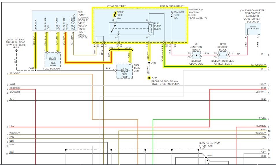

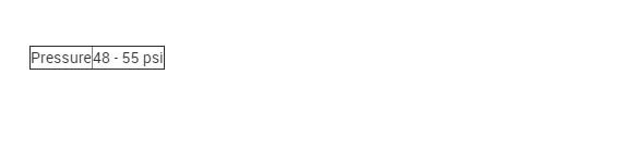

Replaced fuel pump and still no pressure. How much pressure do I need to start car?
Jan 17, 2020 at 7:29 AM
Good afternoon,

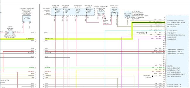

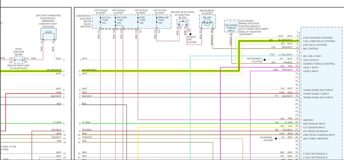

You need to verify power is going to the pump itself.

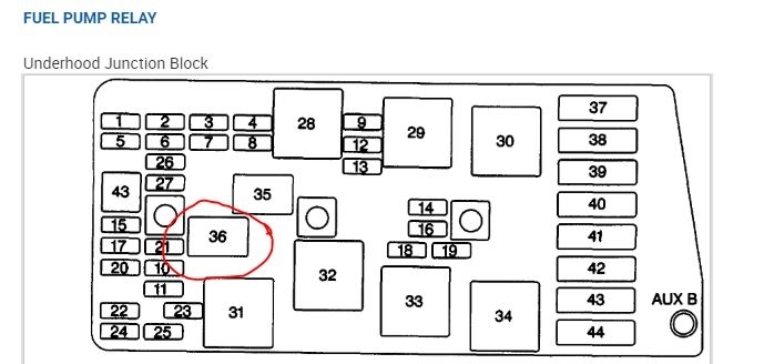

I attached the circuit for the fuel pump. The relay is under the hood and you need to verify voltage to the relay. You will need a test light or a voltmeter.
Can you hear the pump run with the key on?
The pressure is 55 pounds.
