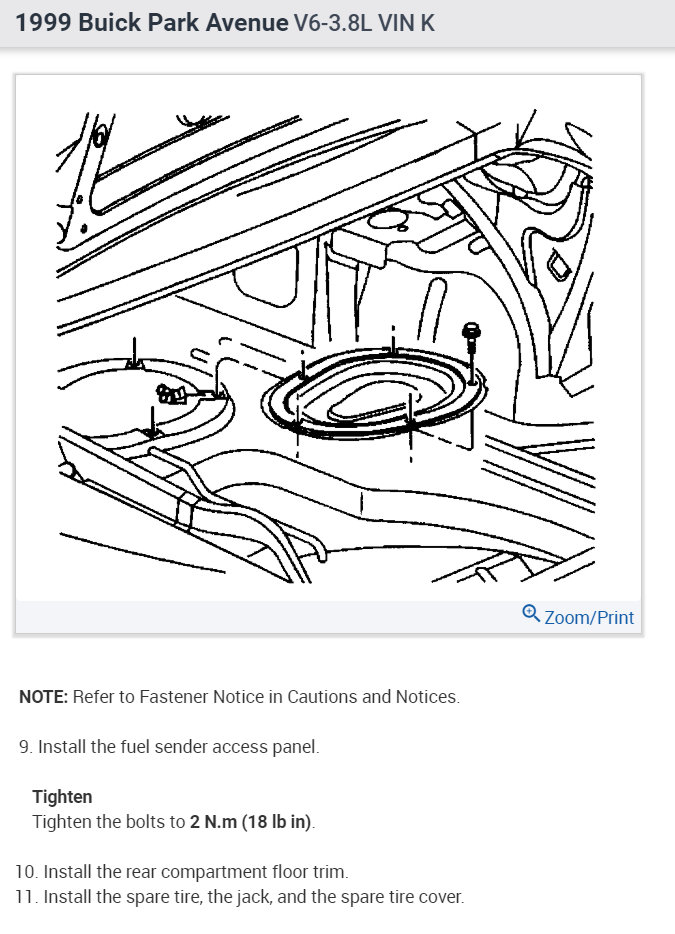

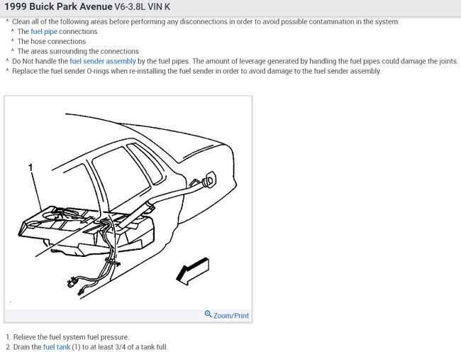

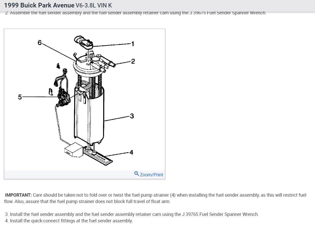

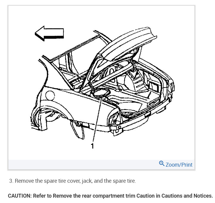

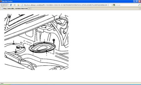

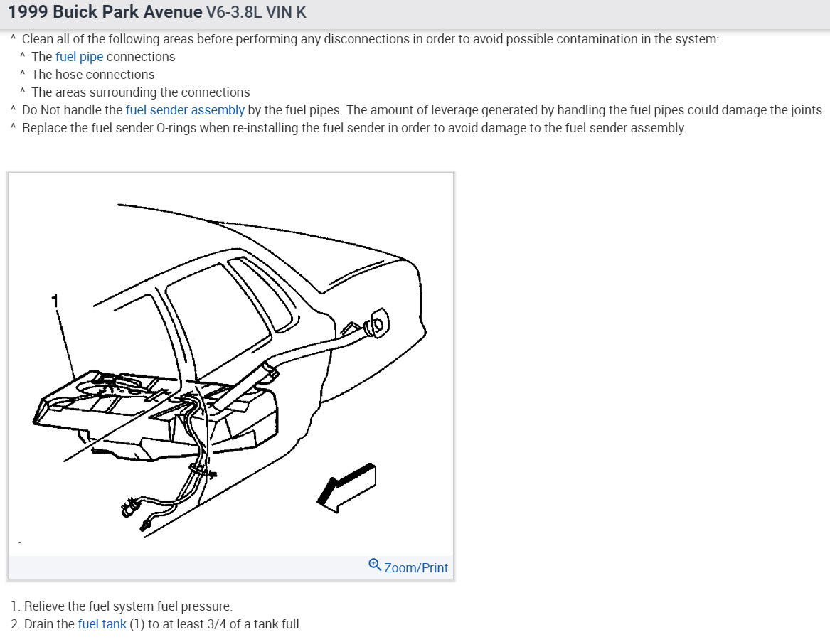

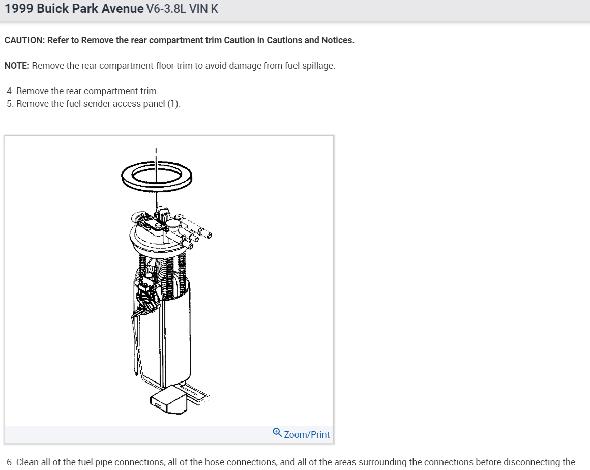

Does this car have to have the tank taken down for pump replacement or is the a cover plate for it? Thanks a bunch for any help.
Sep 23, 2010 at 10:40 AM
SATURNTECH9
  • 30,869 POSTS
There is an access hole under the rear seat. Here are diagrams below that show you how to do the job.
Cheers
