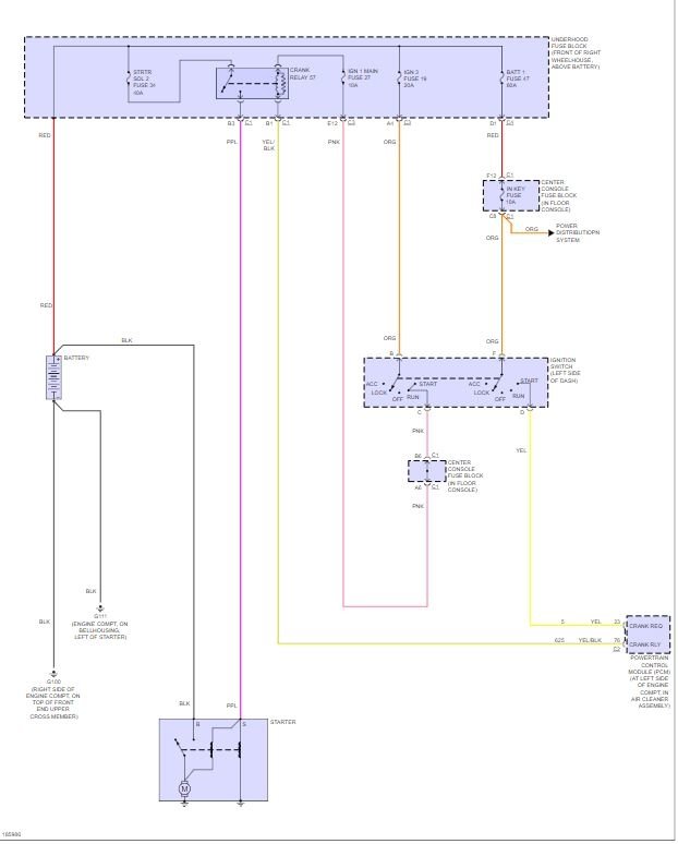

Will not crank or start. we have power and when trying to start there is a clicking noise coming from the fuse box. We replaced the starter, alternator, BCM, ignition control module, coil packs all withing the week with no change.

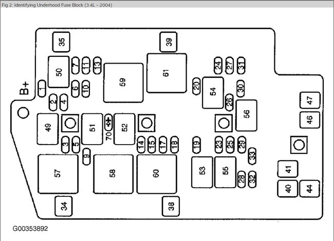

As far as the no crank, since the battery is new and it appears the starter relay is clicking, it may be the fuse for the other 1/2 of that relay.
Check the "STRTR SOL 2" # 34 fuse in the underhood fuse block.

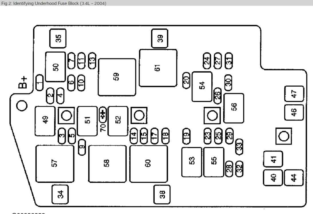

okay, the #34 fuse, is that the 40 amp green fuse that is about three quarters of an inch long?
Apr 8, 2018 at 11:45 AM
PATENTED_REPAIR_PRO
  • 1,853 POSTS
It is a 40a, #34 in the corner shown here.

relay 57 shown here under the hood.

I assume you jumped from the spot that was hot all the time from the strtr sol 2 fuse #34 to the spot that goes down to the starter.
If so, that does not check out any of them other fuses, so use the voltmeter and check them other fuses, IGN3 #19, BATT 1 #47 under hood, In KEY fuse in the center console fuse box, all hot all the times on both sides of each fuse, then the IGN Main #27 with the key on run/start both sides of the fuse, then feel if that #57 relay clicks or not when the key is turned to start.

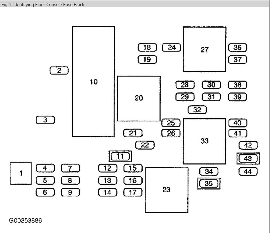

Yes it was . The battery keeps draining so fast. Which one is the in key fuse?

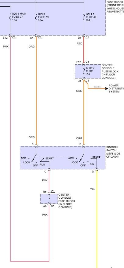

It appears you have a faulty ignition switch.
The "In Key" fuse is #42 in the floor console fuse box shown here.
Double check at the ignition switch the orange wire coming in for voltage from that fuse IGN 3 # 19 and with the key on run, the pink wire coming out that goes to that IGN Main 1 #27 fuse.

The orange wire tested at 0.
Apr 11, 2018 at 3:14 AM
PATENTED_REPAIR_PRO
  • 1,853 POSTS
the orange wire coming in for voltage from that fuse IGN 3 # 19 and with the key on run.
Are you sure you had the key on run?
If yes, and you are sure both sides of that IGN 3 #19 fuse has 12 volts on both sides then you have an open or short in that orange wire and maybe not a faulty ignition switch. Trace that orange wire and find the open, short or cut both ends and run a new wire, tape up the ends of the old wire, Then see if all is okay, now, then move onto finding out why the battery drains so fast.
