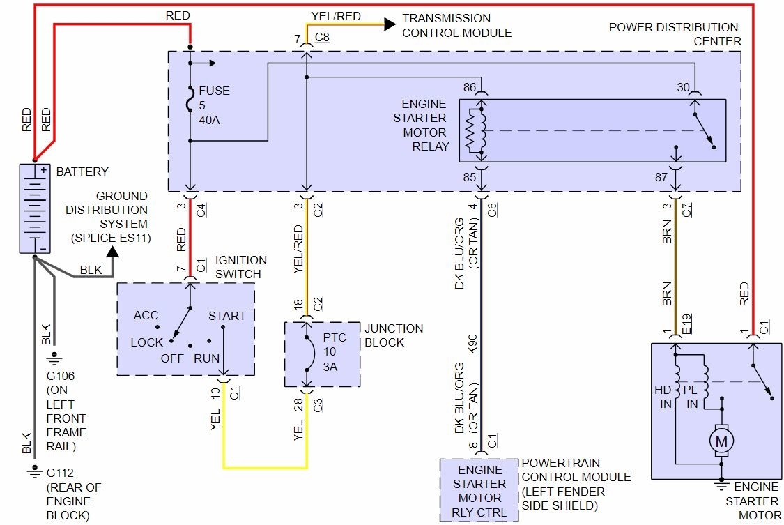

Battery and cables checked out. Checked pin 86 and test light came on. Checked pin 85 and no light. You said to check the ground at the PCM, where should I check that at? Do I back probe the wire that comes from pin 86 to the PCM harness or is there a way to check the PCM ground in general? I am somewhat familiar with working on cars but, thank goodness, I have not ever really had to deal with electrical problems so it is not my strong point. So, where do I go from here?

If you do not have a ground at pin 85 with the key on then go to the PCM harness and check continuity from pin 8 in connector 1 to pin 85. If that works then either the PCM is not receiving the crank signal through the transmission control module and it does not switch the ground on, or the PCM is bad. However based on your symptoms I am going to guess it is an issue with the neutral safety switch/range sensor not operating correctly.

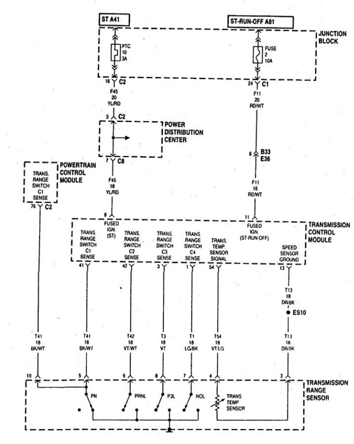

It is a convoluted system in the way it works. You turn the key to start. The battery voltage gets to the starter relay and stops. The leg going to the transmission control module wakes it up and it looks at the inputs from the neutral switch. If it shows park/neutral then it tells the PCM that it is okay to start the car. The PCM then grounds the relay and the engine turns over.
The testing you did shows the voltage switching to the relay is good. Now we need to verify the signal through the transmission module and "range sensor" is working.
One way to also verify that the wiring is okay would be to use a jumper wire from pin 85's wire (dark blue/orange stripe or tan wire) to ground. If turning the key now cranks the engine (might even start up with that ground) you have an issue in the switch or wiring on the transmission side (more likely the switch)
For that we will start with fuse 2. It provides the power to the range sensor through the TCM. The switches are cheap compared to the time it takes to test them. Yours should be the one in the middle. The other one is the early build with the three speed trans. Rather than testing each circuit I would install a new switch and go from there. The connectors and switches are both failure prone.

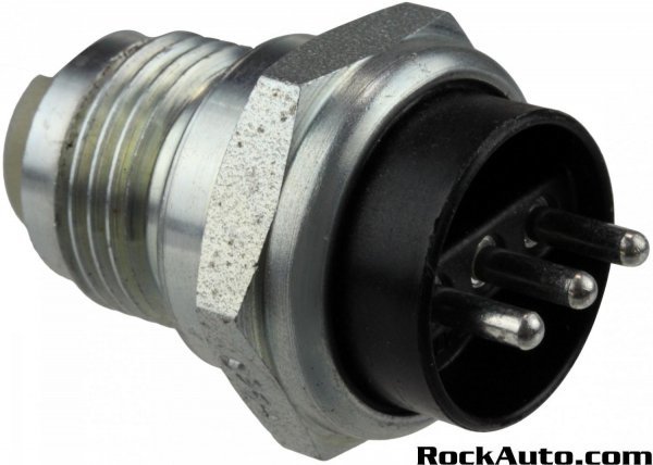

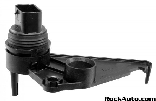

The range sensor/neutral switch are the same part. The main reason I suggest replacing it is simply because they are failure prone and you can remove and replace it in less time than it takes to test it.
However you can test it if you wish. The first schematic has the pin outs and in park/neutral it should have a ground on the black wire with white stripe. The ground should go away in all other gears.

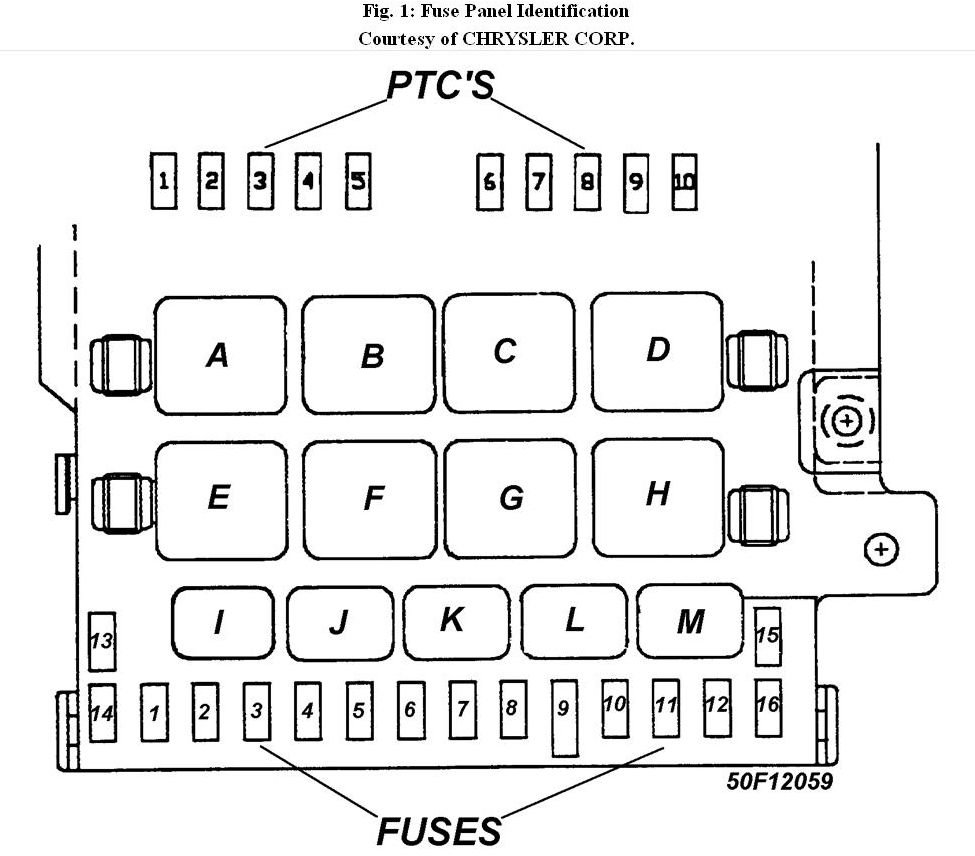

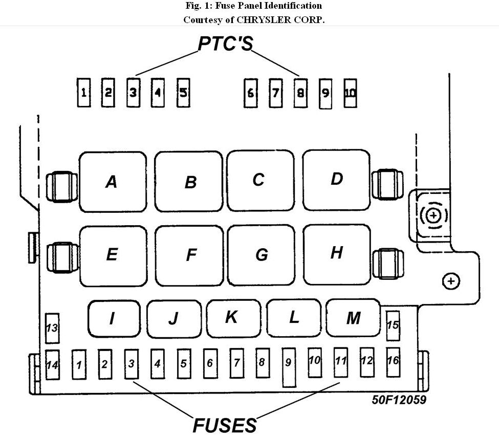

PTC 10 is a self resetting thermal fuse, works like a circuit breaker but for smaller loads. The junction block is under the hood and should resemble the image below.

Okay, the neutral safety switch that you referred too, which is the middle picture, looks like what I have. Now the big question, because I cannot seem to find a good reference, how do you replace it? It does not look as though it is as easy as the other one which screws out and then in, just my luck. I could really use some help with this.

The signal is sent over the data bus not a single wire it is not something that you can test that way. It sounds like the range sensor is working. The problem now is that to test farther you need a scan tool that can read the data and see if the signal to crank is being blocked.
My guess is that the TCM is getting the signals now as the shift indicator is correct and it gets that data from the range sensor through the TCM. You might try disconnecting the battery wait twenty minutes and reconnect. There are times that the PCM can get "confused" and that will reset it. Otherwise you will need to get a scan tool to test farther.
