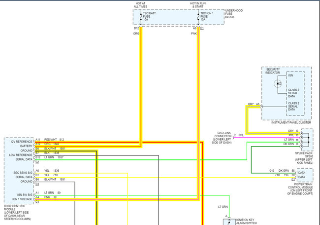

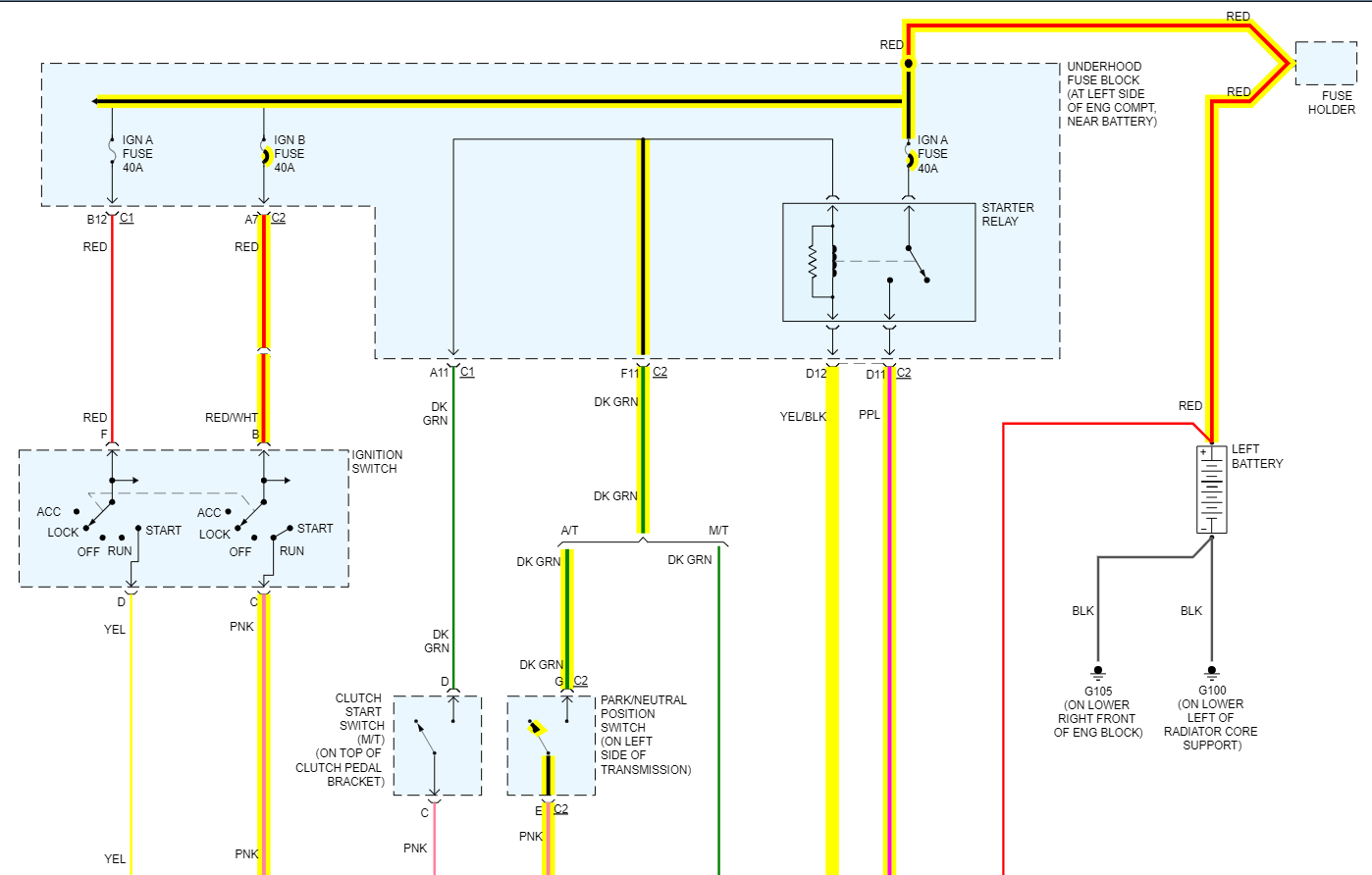

i have the truck listed above 1500.
I've Silverado rebuilt engine. i have everything plugged up. i’m getting a no crank no start condition. When i turn the key lights come on inside the cabin. I've noticed my reverse lights are not working. I've removed the starter relay and put paper clip in slot 85 using a multi meter ground black prop and checked volts on pin 85
and i get 8 to 4 volts. I’m not getting 12 volts. i have no codes.
This leads me to believe the neutral safety switch is bad. Or could it be something else?

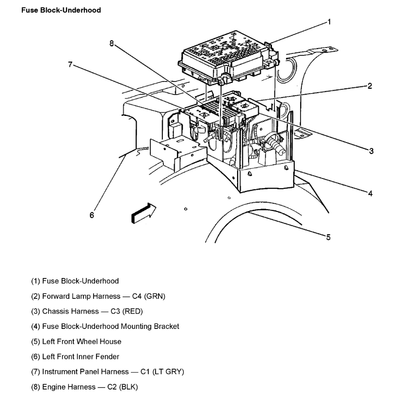

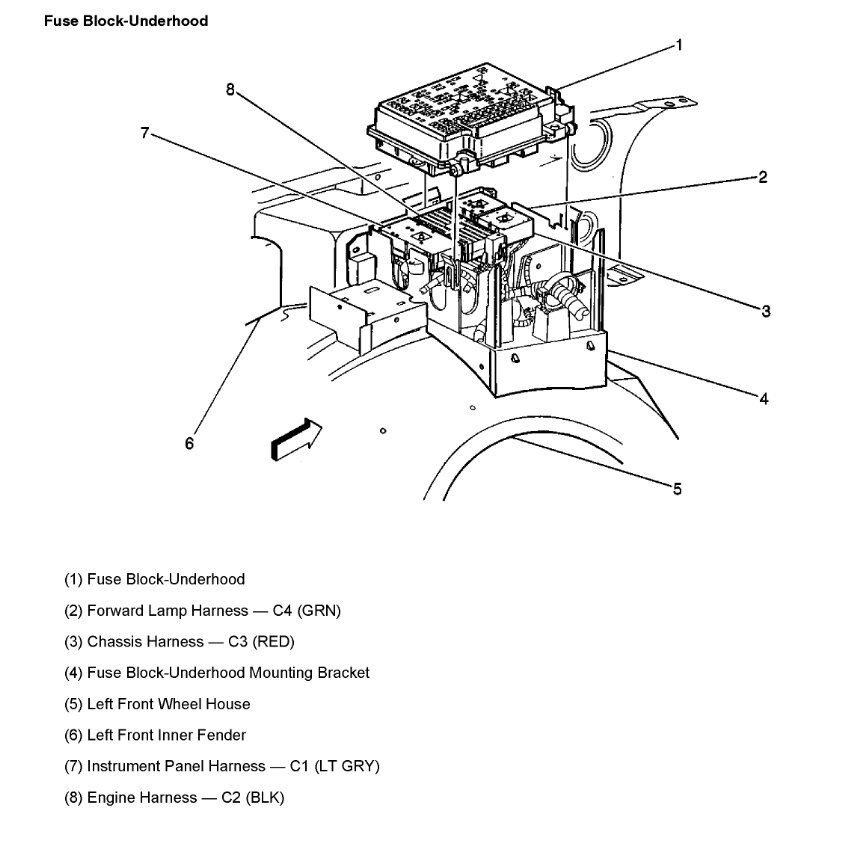

Hello, have you checked the underside of that fuse relay panel? They tend to corrode a lot being exposed to the elements. A lot of times the wires will eventually just break right off from the pins that the relays and fuses sit in, check that first and if it's clean in that panel we can trace the voltage drop back. Is this a 4wd and what size engine, or just give the VIN and I'll look it up from there to get the correct wiring diagrams for the whole vehicle.

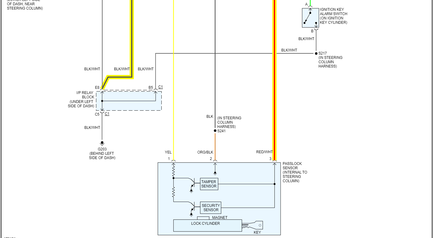

There's no security light at all? Not even when the truck is off and locked up? This is how the fuse panel will come apart, it's very common for corrosion inside these, especially if you live in an area where they use salt on the roads during winter.

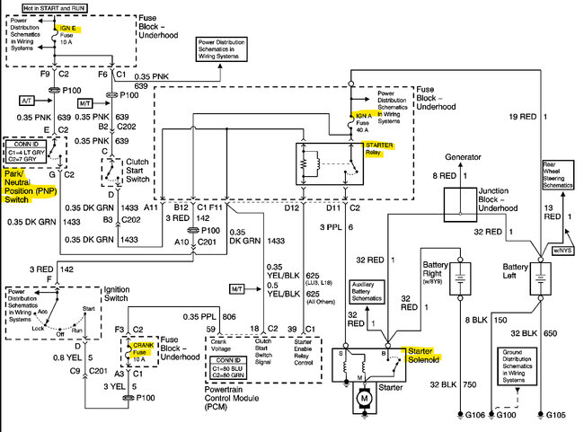

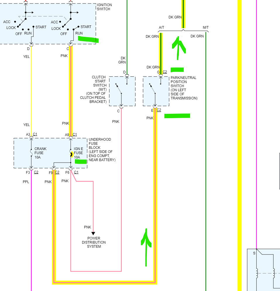

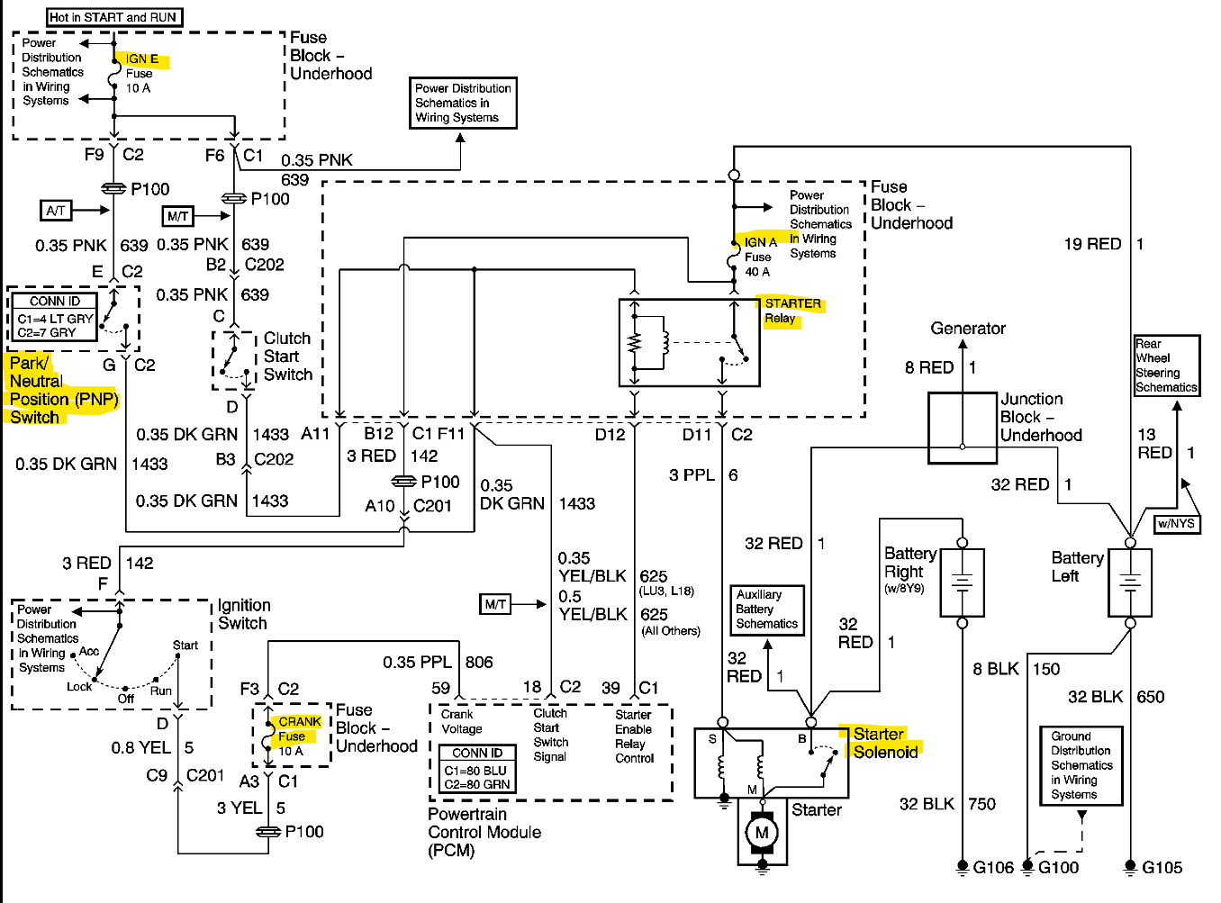

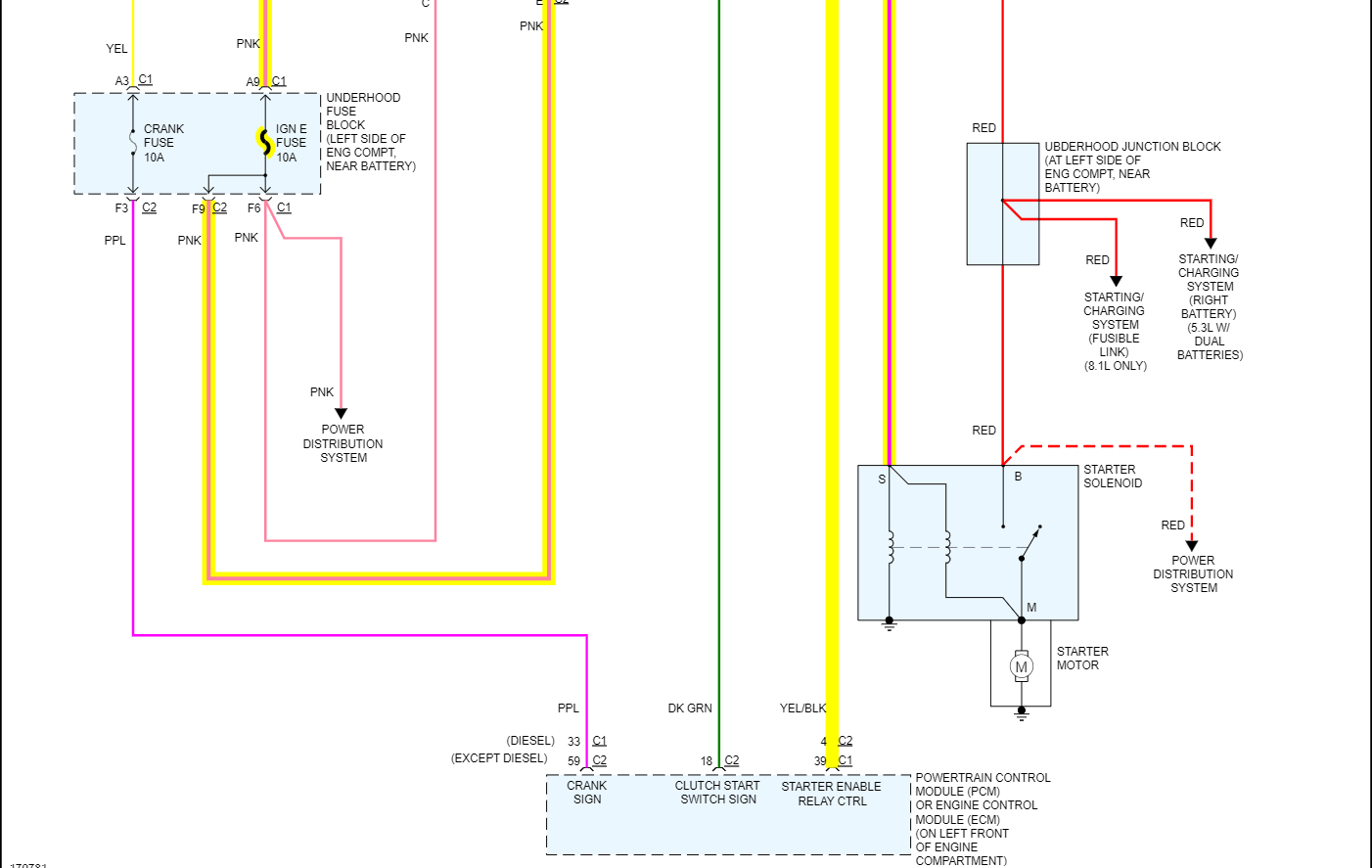

Here's your Starter circuit. Diagram 1 is the top, and the other is the lower section.
I've added the OEM diagram just to verify the wire coloring is correct.

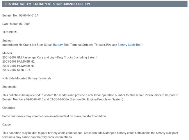

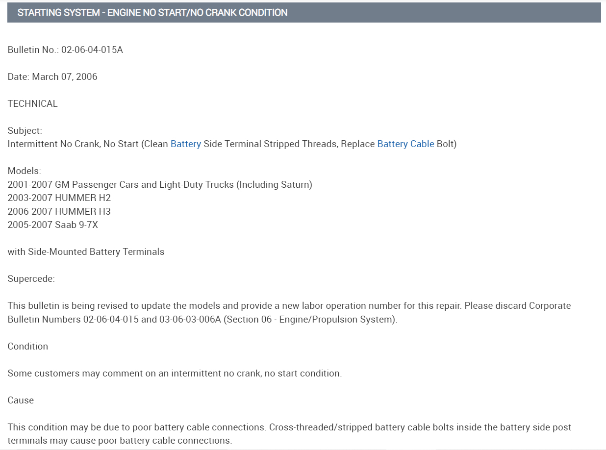

I'm sure you have, but just make sure the battery cables are nice and tight, there's a TSB out for it.

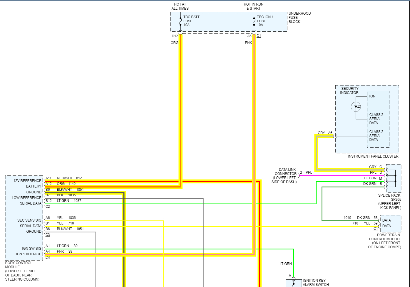

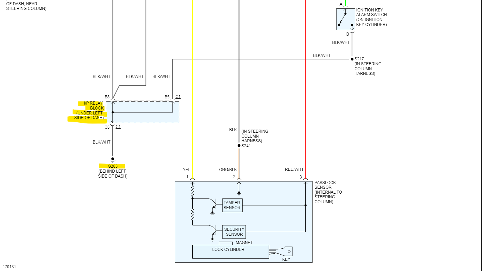

Diagrams 6 and 7 are for the Security light and Ignition switch circuit. I think you may find low voltage to other components as well. Refresh this page to see other diagrams as I post them.
The lower dash fuse panel on the driver side is sometimes exposed to moisture or water intrusion if the door or window seals are worn (8th diagram).
Does your Check engine light come on at just the Key On?

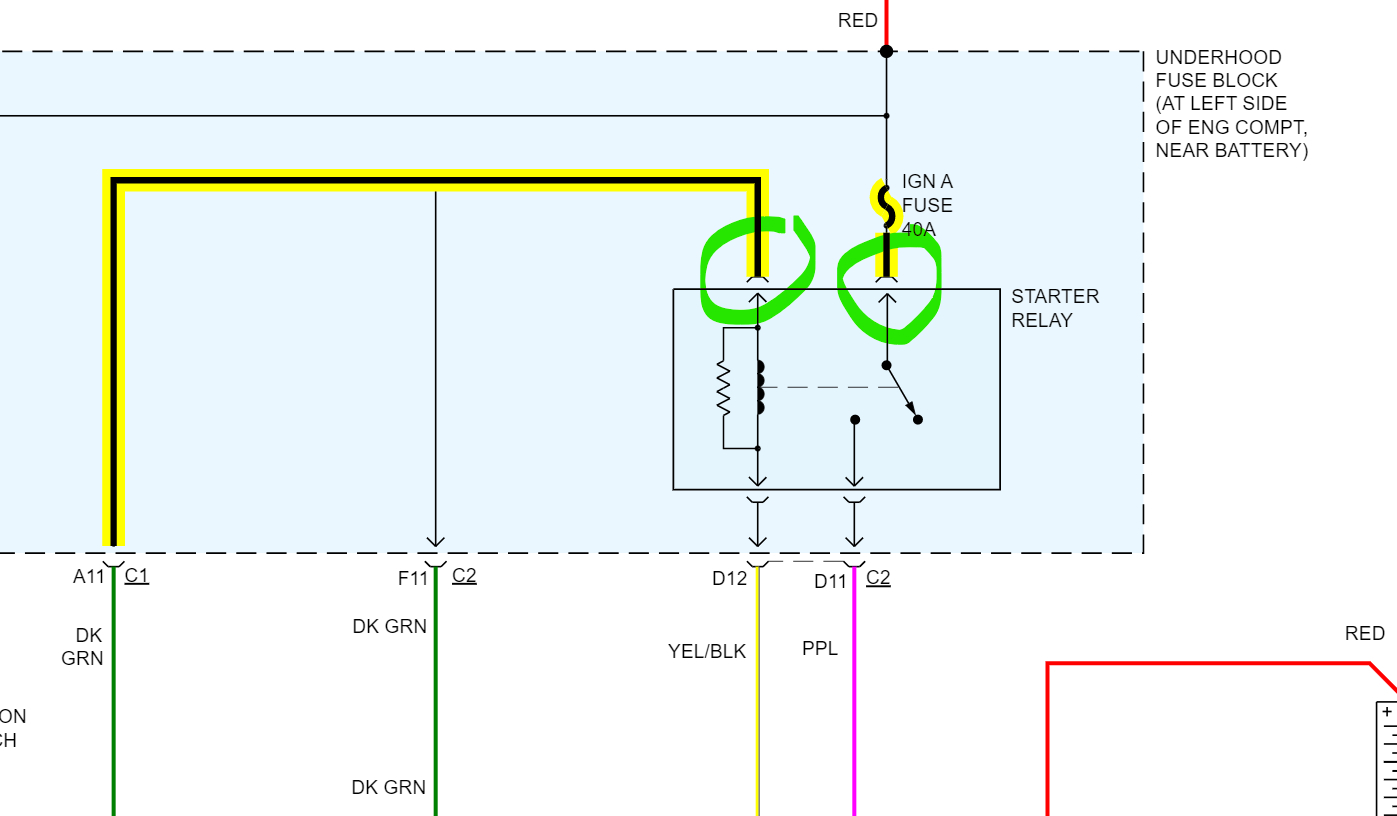

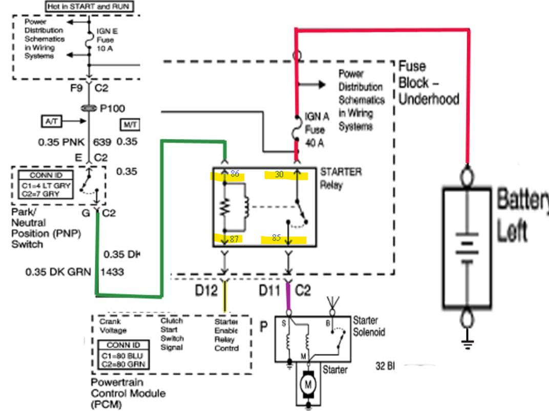

It can be the Park Neutral switch, but test it first, it's a very simple circuit to test, you could actually test the PNP switch and the ECM relay control with one test using the multimeter. The PNP switch gets power from the IGN E Fuse 10-amp while the key is in the Run or Start position. 12volts are going to come from that fuse, go through the PNP switch, through the Starter Relay coil, and down the ECM. But pin 30 is the load side of the relay, not the control side, pin 30 should have power from IGN A fuse 40amp. The wiring diagrams don't show which pins on the relay are the control pins and which are the load pins, do you have a relay that has the little internal diagram on the side? The PNP switch is on the control side of the relay. So, check the ign A fuse for power. I'm not sure why GM doesn't show the pinout for the relays even on the OEM diagrams, but I think you're missing power in a different place.

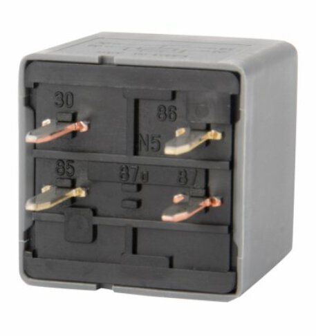

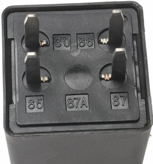

The relay I'm looking at pin 30 and 87 are the load side feeding power to the Starter, and pins 85 and 86 are the control side of the relay. On the bottom of the relay there should be pin numbers too.

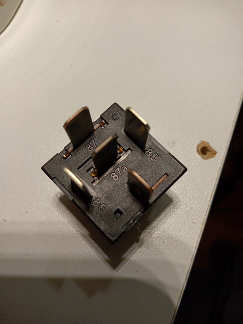

This is a relay I took apart but notice the pin numbers on the bottom. Check to see if you have these.

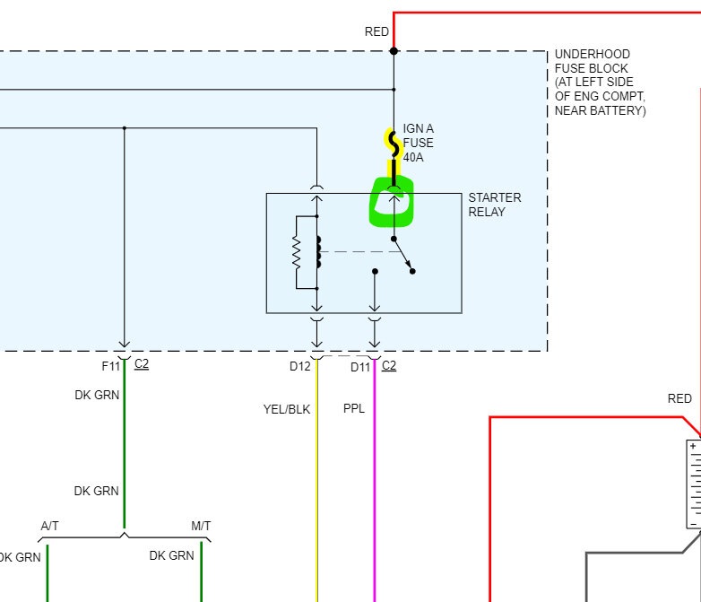

The 3rd diagram is from a 2005 Silverado, it has the pins labelled. You can see pin 87 is the pin that the ECM grounds to turn the relay on completing the pin 30 and 85 circuit and powering up the starter.
Actually, looking through this other service info, they might not have the pinout correct, but with the key On and the relay out, 2 out of the 4 pins should have 12volts. Does your relay have pinout numbers on the bottom?

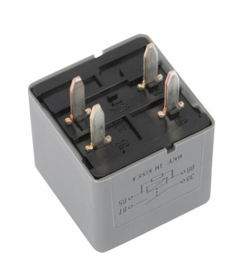

Hopefully this is the correct relay you have.

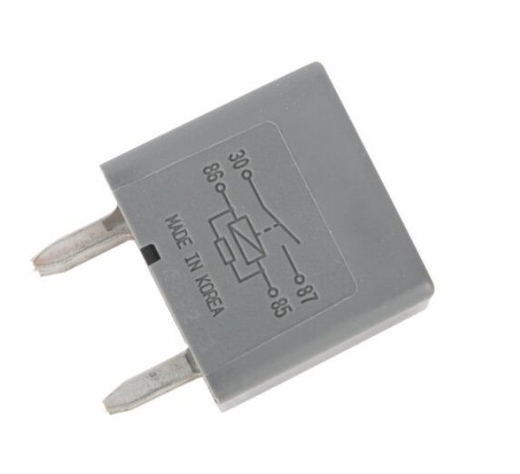

Okay, finally this grey relay is an OEM Chevy Relay, pin 30 is the load, it should have power coming from the IGN A 40amp Fuse.
Sorry for the confusion there. There were a couple errors in some service information.
Disregard that 3rd wiring diagram, which looks incorrect, I'm not sure who labeled that, but it could cause a serious issue if someone tried jumping out the relay pins. I can't seem to delete it.

yes, my relay has the numbers on the bottom.

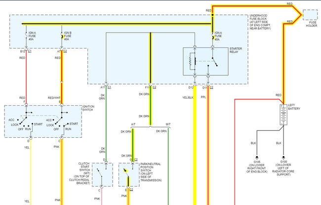

Check for 12volts at PNP switch before installing a new one, it will have 12-volts on the pink and dark green wire with the key "on" if it's working.

Technically speaking, with the starter relay out, and key "on" you should have 12volts on 2 of the pins where the relay sits. Thats the fastest way to check all power inputs to the relay.

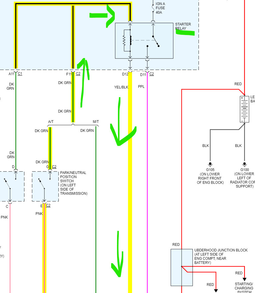

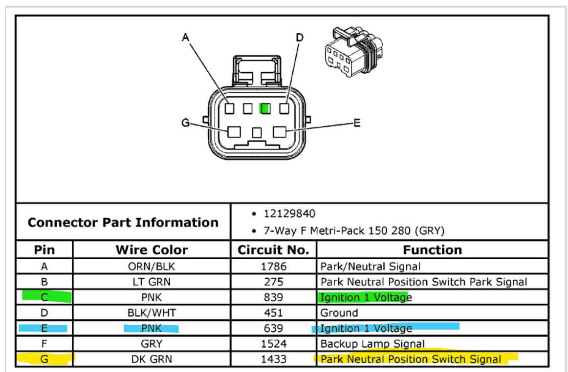

do you know which 2 pins should be hot on starter relay?
Jan 24, 2023 at 2:05 AM
HD2424
  • 190 POSTS

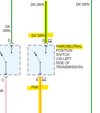

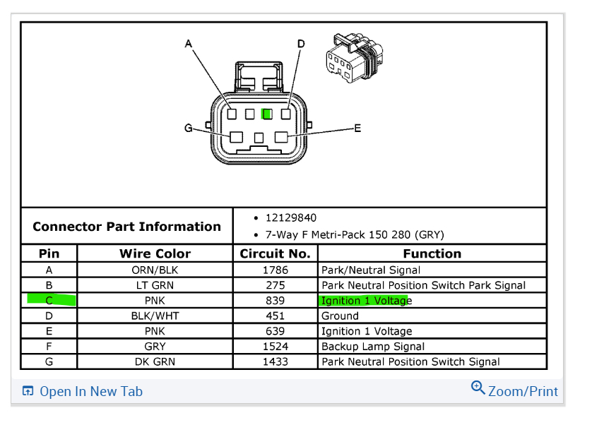

i see the picture now. i have power at the top right pin of starter relay no power on top left side of relay. Where does that green wire go?
Jan 24, 2023 at 2:10 AM
HD2424
  • 190 POSTS
is that dark green wire coming from neutral safety switch?
Jan 24, 2023 at 2:12 AM
AL514
  • 5,700 POSTS

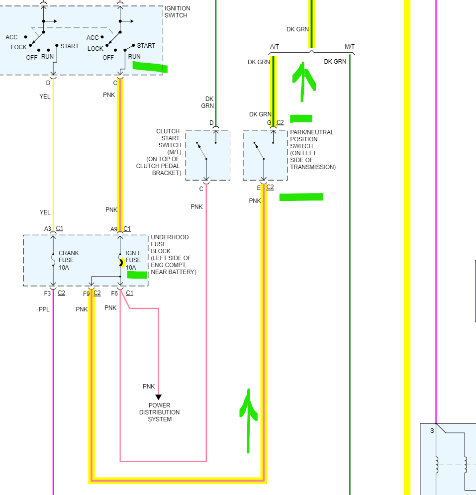

The dark green wire is power coming through the PNP switch, if you're missing power there go to the pink wire on the Park Neutral switch and check for power there, make sure the key is on.
It should look like this. It's the pink wire on a number of different transmissions.

update: I tested the third pin on the neutral safety switch plug like the above diagram specifies. i did have power at that pin. Since i have power there do you think it’s neutral safety switch? It’s getting power but not functioning.
Thanks for all your help I really appreciate it.
Jan 25, 2023 at 10:36 PM
AL514
  • 5,700 POSTS
The pink wire is the 12-volt power feed, and it comes out the switch on the dark green wire labelled G. There are actually 2 pink wires I see now; one is labelled E and one is labelled C. You want to check the wires labelled E and G. The pink wire labelled E is highlighted in blue on the connector diagram. And 12volts should be coming out on the Dark Green wire. I didn't realize there were 2 Pink wires both labelled Ignition 1 voltage.

If 12-volts are there, verify its coming back out on the dark green wire. Were you missing both 12-volt feeds at the relay?
Jan 26, 2023 at 12:41 AM
HD2424
  • 190 POSTS
update: both pink wires have power both pink wires have power going into neutral safety switch. If power is on both pink wires, then neutral safety switch must be bad? is this correct?
Jan 26, 2023 at 12:45 AM
AL514
  • 5,700 POSTS
You have to check that power is going through the switch, it should be going in on the pink wire and coming out on the dark green wire. Thats how the circuit works, if the vehicle is not in Park or Neutral, there will be no power coming out on the dark green wire. If it is in Park or Neutral 12-volts will be coming out on the dark green wire. The dark green wire goes to the Starter Relay.

Okay, i’ve tested the dark green wire coming out of pig tail on the bigger plug on neutral safety switch no power at the dark green wire there or the dark green wire that goes to starter relay. Would this mean there is short on dark green wire, or the neutral safety switch is bad because it’s not sending power to dark green wire?

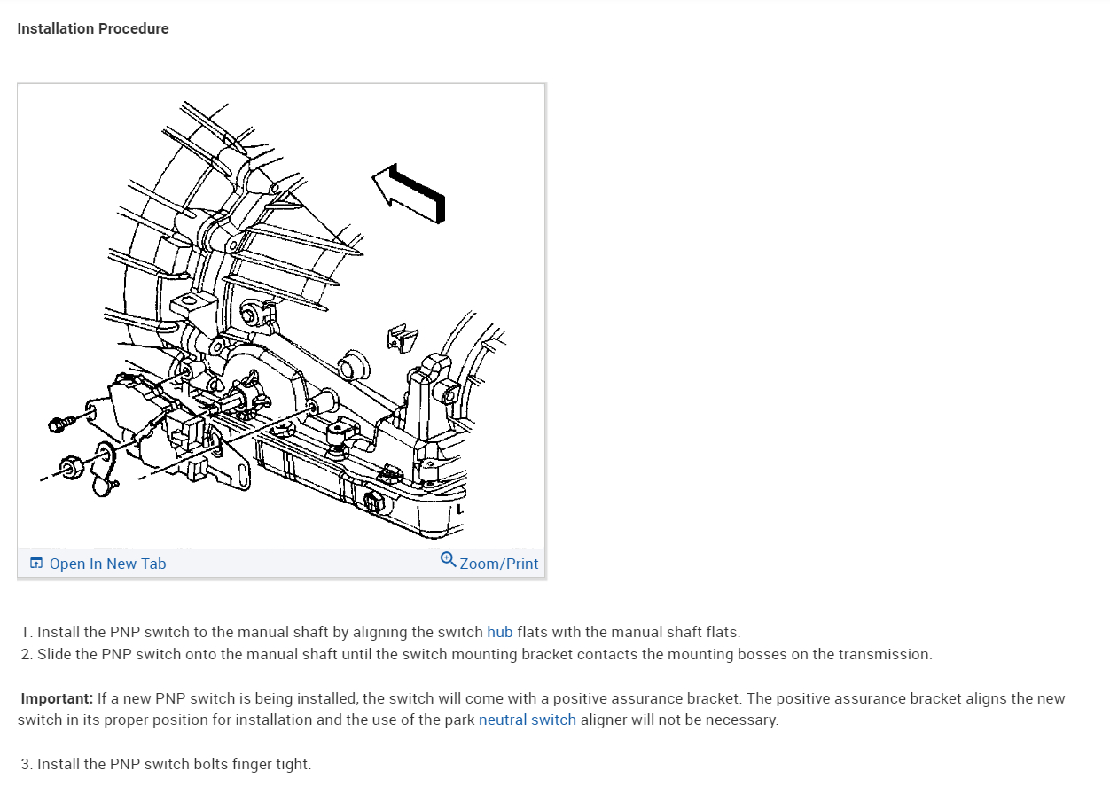

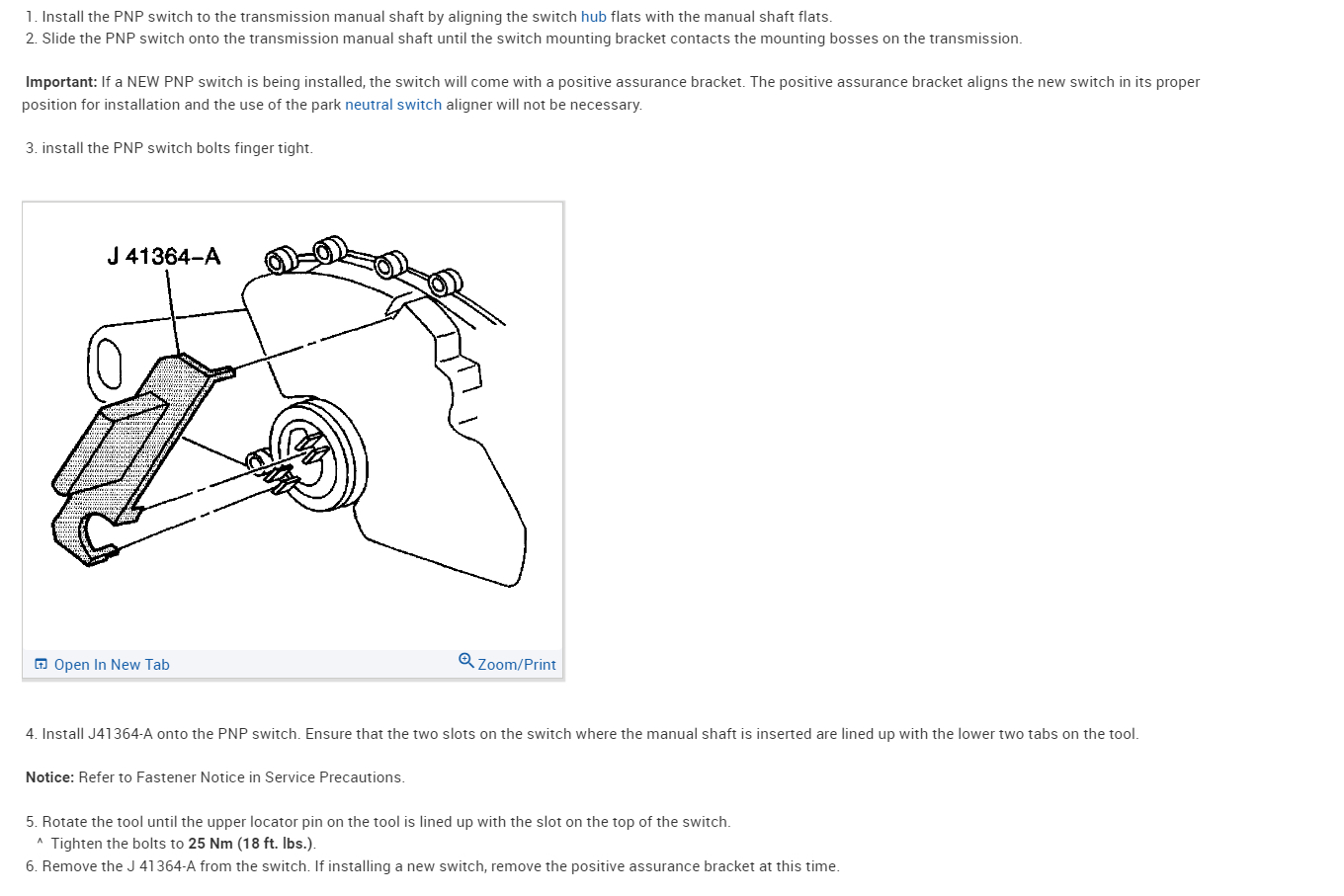

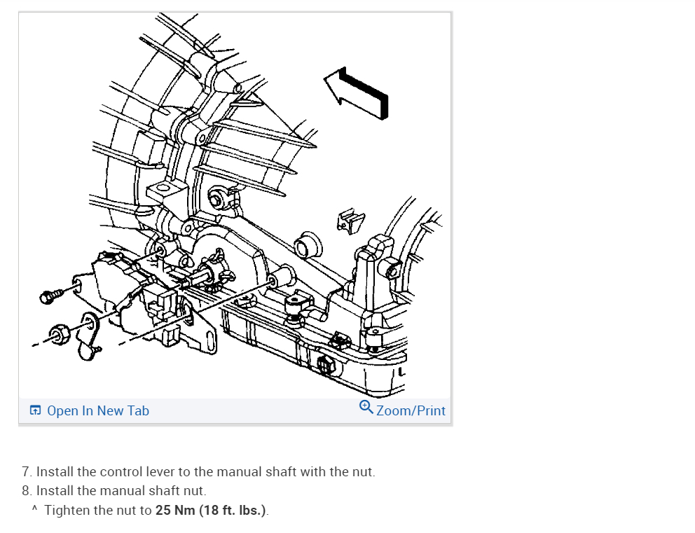

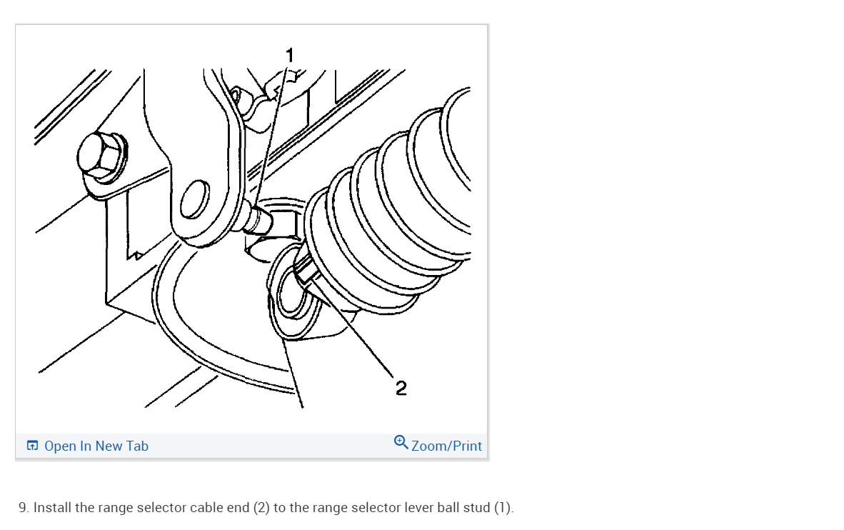

As long as the key was "on", it's not a short, it's an open circuit. You can try putting the vehicle in Neutral to and run the same test, but yes there should be power coming out on the dark green wire going to the Starter Relay. Make sure the Park Neutral switch connector is not corroded or anything, but it sounds like you have found the issue. Try moving the shifter from Park to Neutral and back to Park just to verify that it's not something in the linkage going to the PNP switch. Sometimes the linkage wears and the switch does get moved all the way into Park. The linkage to the switch should be tight.

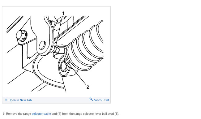

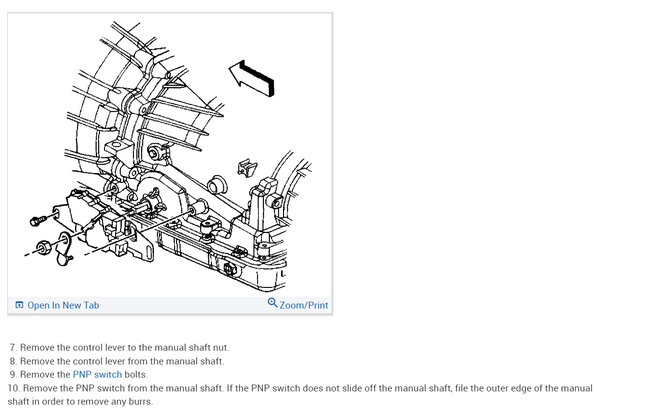

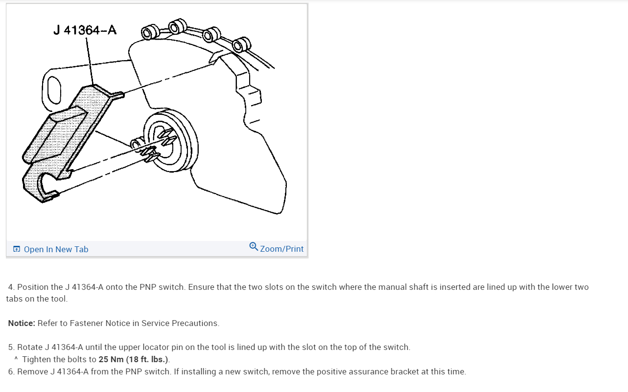

the new switch should come with a small alignment bracket, (Positive Assurance Bracket) to make sure the switch goes on correctly, there is an alignment tool J41364 A that is used if the switch is taken off for other reasons, but a new one should come with it aligned.

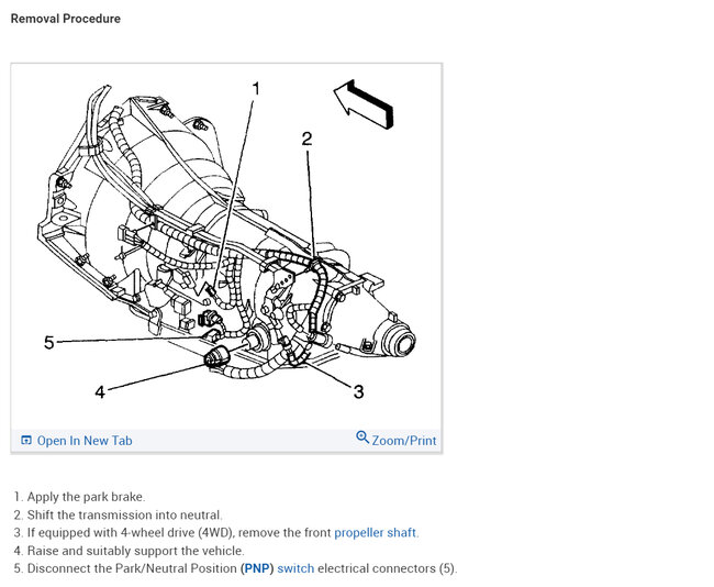

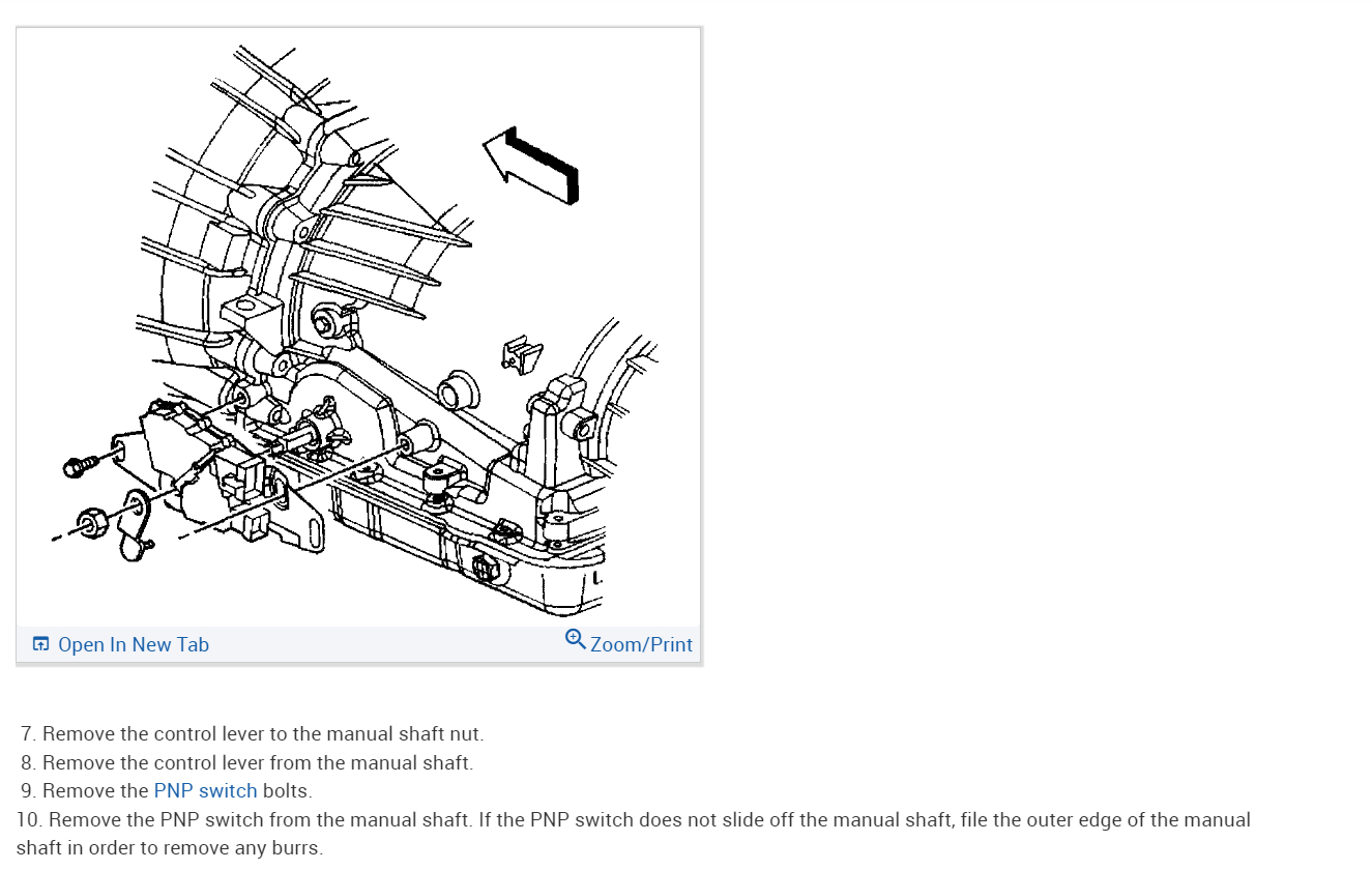

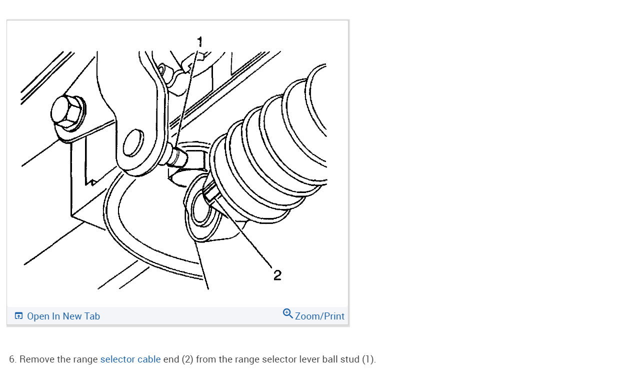

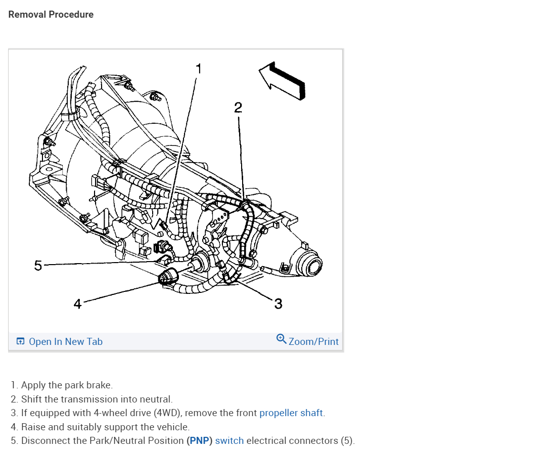

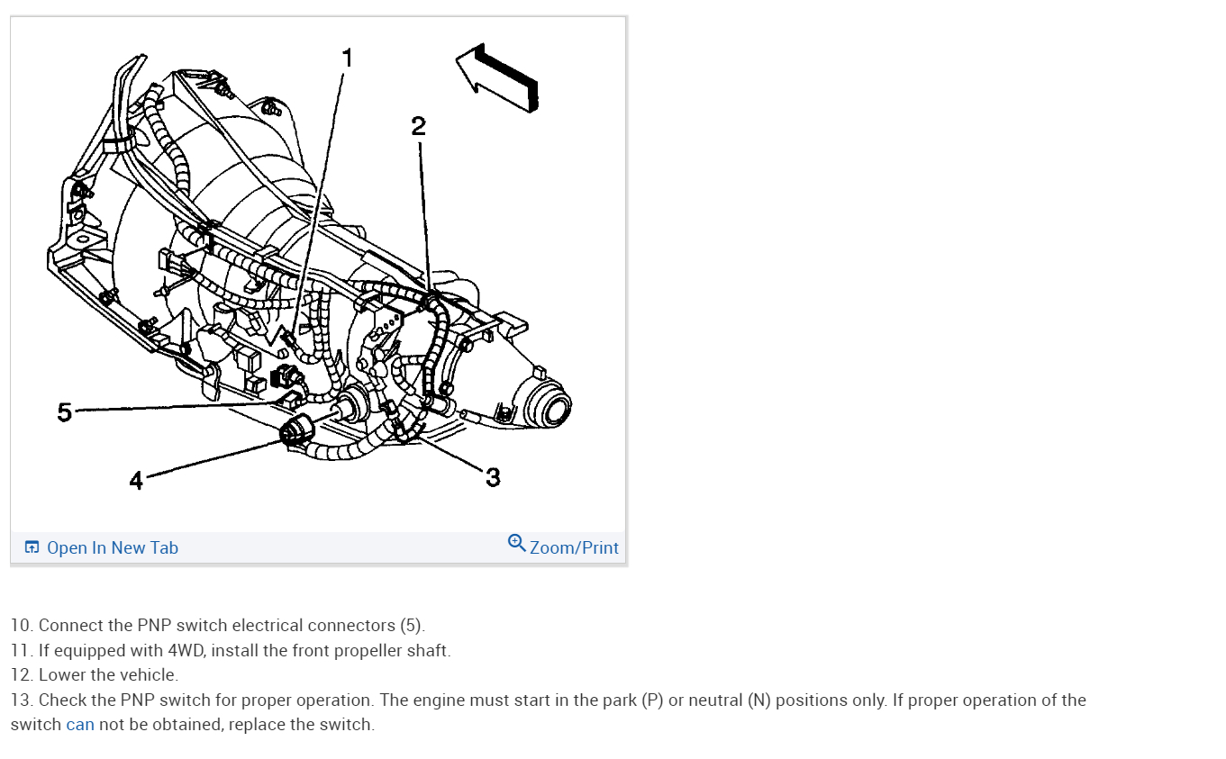

Yes, here's the instructions for replacing the switch. There are 2 different transmissions for this truck, but it's the same when replacing the Park Neutral switch. Just put some blocks under the wheels to prevent it from rolling while doing the repair.

Update: changed out neutral safety switch, truck started right up.
thanks a million for all your help.
