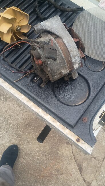

This goes back to our other conversation. What's the deal with the alternator. He said it's old and not a single output""??
Sep 24, 2026 at 9:39 PM
  • 55,423 POSTS
I would watch this video and then start a new thread.
https://www.youtube.com/watch?v=6YRW8fyNudY&t
Sep 25, 2026 at 6:04 PM
CARADIODOC
  • 34,381 POSTS
The left photo is of an older Ford generator. What the comment might have been in reference to is there's just one field terminal on the back. The second one would be grounded internally. I don't think this is the best choice for wind power. Remember when I said "all generators are very inefficient at low speeds"? With a car engine idling at around 800 rpm, and an alternator pulley roughly one sixth the circumference of the crankshaft pulley, at idle, the alternator is already spinning at close to 4800 rpm, and it's producing almost no usable power. It isn't until you raise engine speed that they become efficient enough to produce usable current. To do that, it can take up to around five horsepower to drive the alternator. It's going to be almost impossible to get enough wind energy to drive an alternator fast enough.
If you were to experiment with car alternators, the better choice would be a Chrysler unit from 1970 or newer models. Next would be a Nippendenso alternator used on mid '90s and newer Chrysler vehicles. Both have both field terminals on the back, with no internal voltage regulator or internal circuitry to contend with. They still need a good five horsepower and pretty high rpm.
