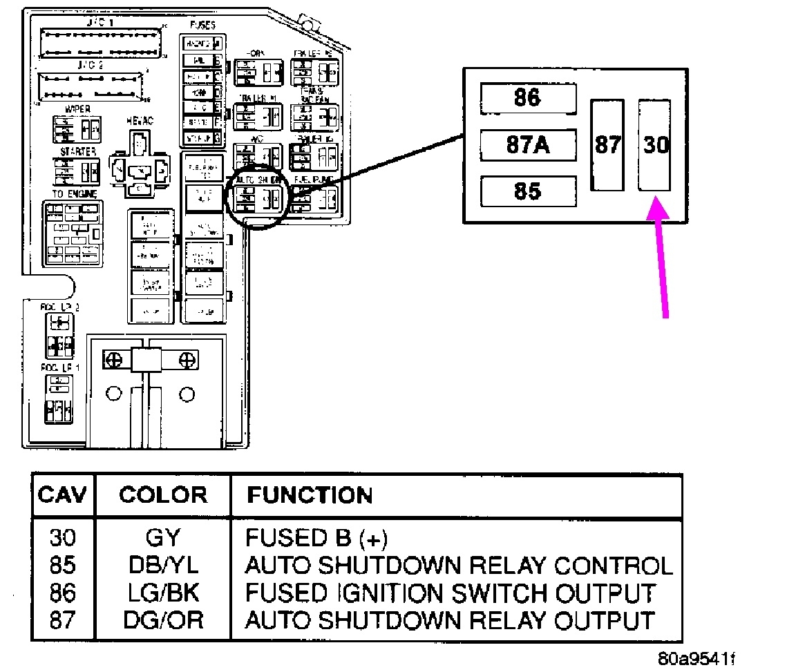

No crank, no start has a brand new battery ?
I'm not getting light on any on either run or crank

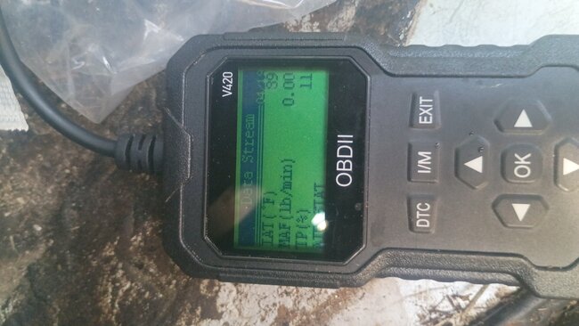

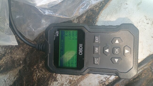

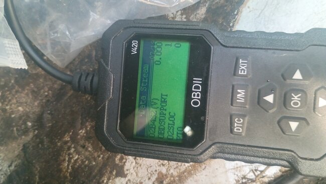

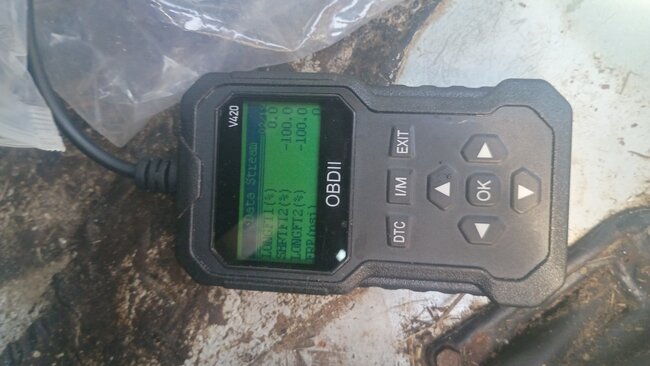

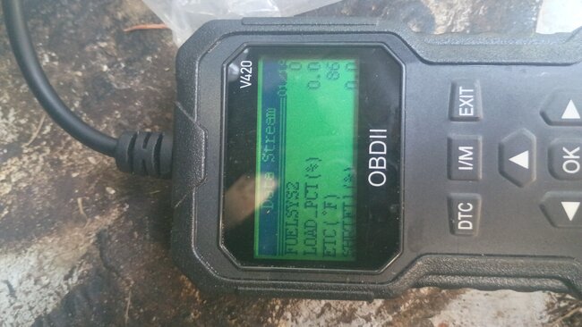

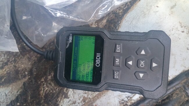

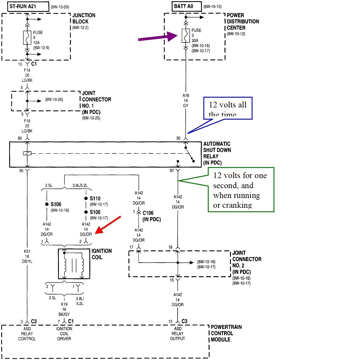

Your scanner readings are getting too far ahead. We aren't at the point yet where they come into the picture. I understand the test light isn't lighting up for engine rotation, (cranking or running), but what about that first one-second-long pulse just as the ignition switch is turned on to "run"? That will tell us if the ASD circuit is capable of working.
If you do not see the light for that first second, go to the ASD relay socket with that relay removed, and check for 12 volts on terminal 30. It should be there all the time. If it's missing, suspect fuse # 3, a 30-amp is blown. I can't find the full listing for the under-hood fuse box, but it appears fuse # 3 is one of the ten large cartridge-type fuses just left of the ASD relay in this first drawing. I pointed it out in the second diagram with a purple arrow.

M man no freaking it's got power on the on the relay I don't know what I'm doing wrong

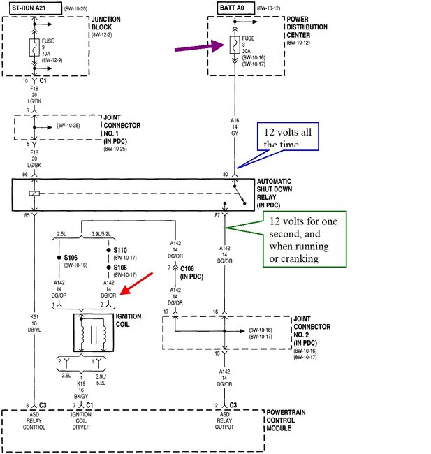

If you have 12 volts on terminal 30 in the relay socket, we're good up to that point. Next, pop one of the other relays like it into that spot. Use the horn or wiper relay. we just need a known good one. Place your finger on it, then feel for its click on, then off when a helper turns the ignition switch to "run". If you feel that double click, we can move on back to testing at an injector. Remember, you only expect to see the test light turn on for one second when the ignition switch is turned on to "run". If you don't see that, check the test light's ground clip to be sure it's making good contact. Put it right on the battery's negative cable clamp.
If you never see the 12 volts right at an injector, we have to investigate a break in that dark green / orange wire, possibly a corroded splice or bad connection between a pair of mating connector terminals.

Terminal 30 gets 12v. I swapped relays around and I think I'm just getting a residual click from the other relays because it's not a definitive click

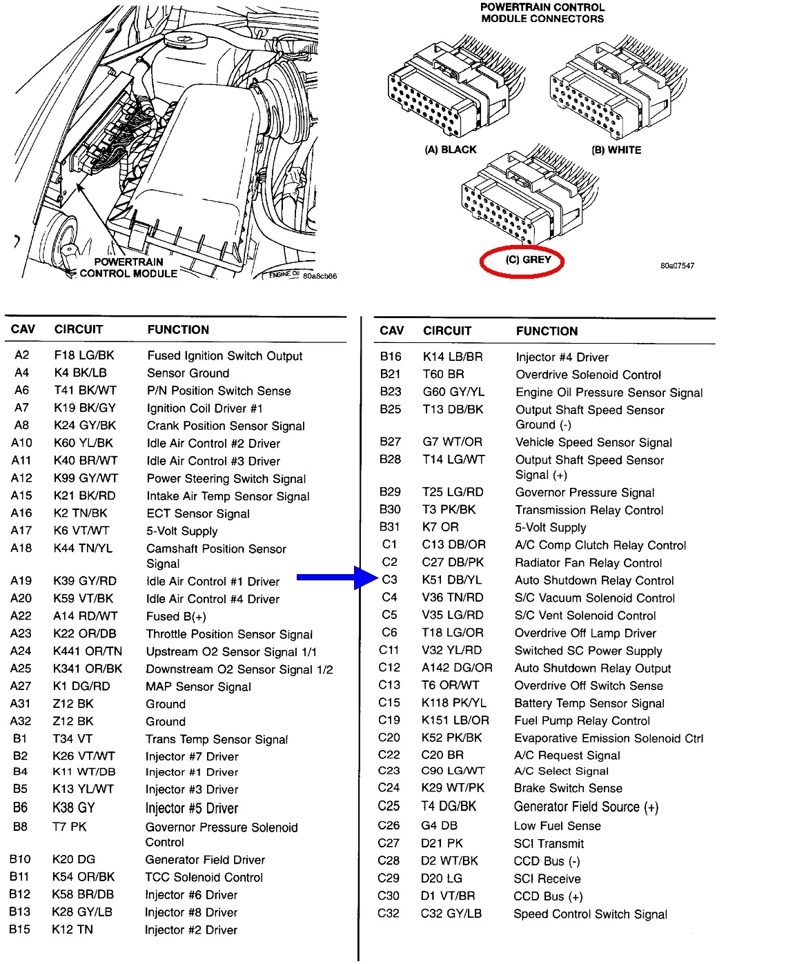

Dandy. Next, refer back to the last drawing showing the relay terminals. Check on terminal # 86. All you have to do is turn the ignition switch to "run", then check for 12 volts on 86.
Aug 26, 2026 at 4:11 PM
As you so amusingly said.. "Dandy!" Love it. But yes 86 came on 12 v at run

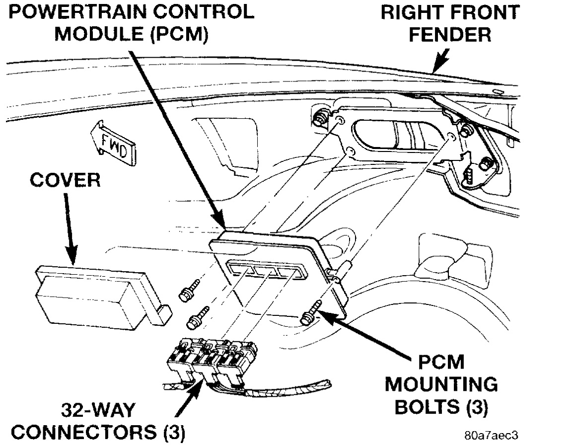

Okay, if the relay is not clicking, and you have the 12 volts on # 86, the ignition switch circuit is working. That leaves terminal 85 is not getting grounded by the computer. It's looking like the Engine Computer is defective, but there's one more test we can do. The relay has to be plugged in for this test. We need to see if the 12 volts is making it all the way to the computer.

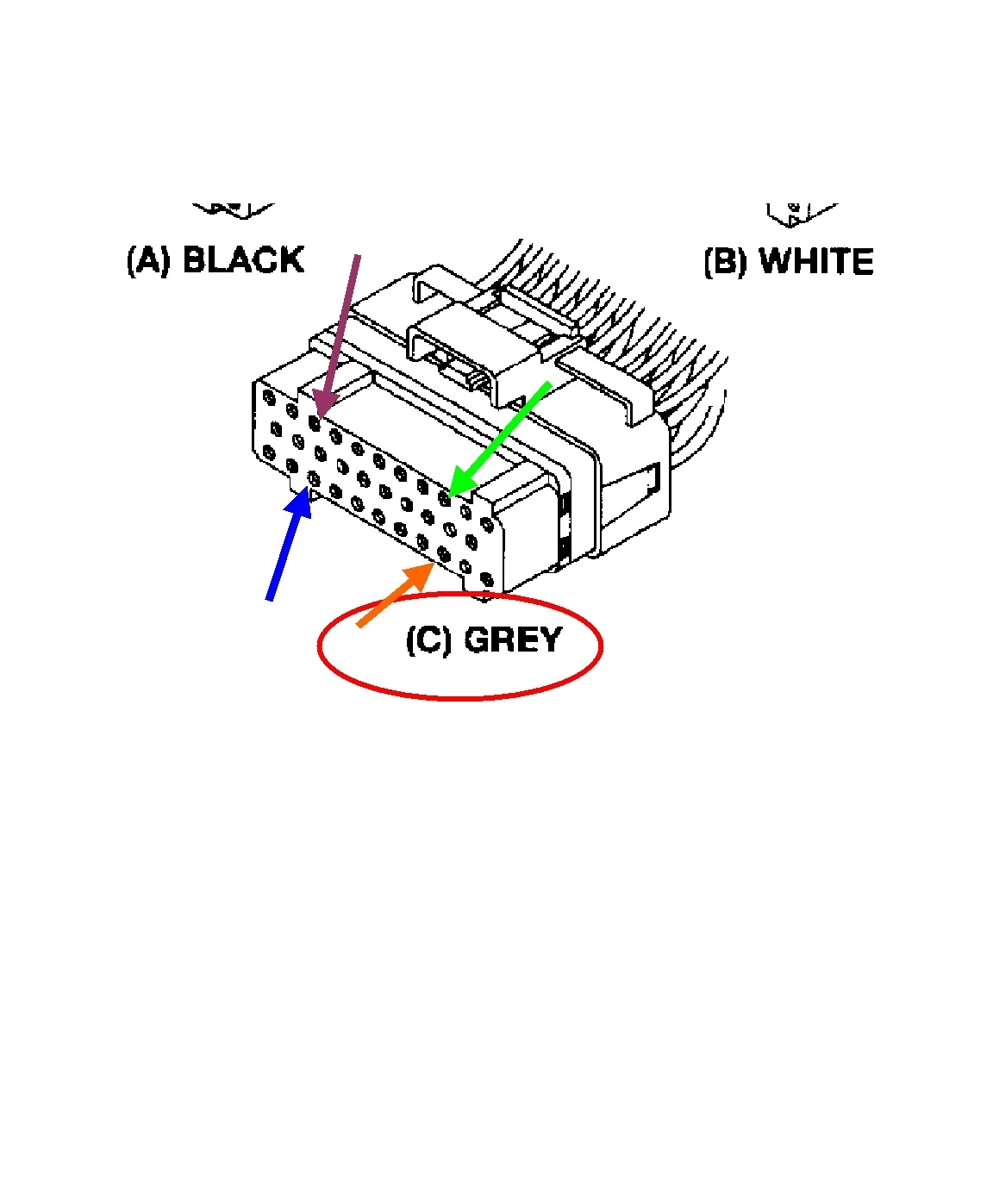

The Engine Computer is on the passenger side inner fender, (first drawing). The wire we're after is the dark blue / yellow which goes to terminal "C3". That means terminal # 3 in connector C. The red circle I added in the second drawing shows connector "C" is the gray one of the three. I was surprised to see they didn't include the terminal locations here, so you'll have to go by wire color. The numbering always starts in one of the corners, then goes across to the far opposite corner. Terminal # 3 is going to be at one of the four arrows in the third drawing. I have a suspicion it will be at the purple arrow, but look for the dark blue / yellow wire to see which corner it's closest to.
A word of warning here. It's fine to unplug this connector, but don't try to take it apart. I did that on our '97 Dakota at school, then it took me a couple of hours of frustration to get it back together. I don't know how they do it on the assembly line, but it was way harder than any other plug I've worked on. I had terminals flying everywhere with no way to hold them in their positions.
To add to the misery, I seem to recall these connectors have protective covers over the wires to keep water out, so you can't back-probe them to take readings. This is why you have to unplug the connector, then gently stick a sewing needle or a stretched-out paper clip in the terminal, then touch the test light's probe to that to take the reading. You should find 12 volts there all the time the ignition switch is in "run".
By the way, without going into the gory theory, the test light is the better choice here over the digital voltmeter. The light will give more accurate results in this type of circuit.
Let me know what you find now, then we'll continue on.

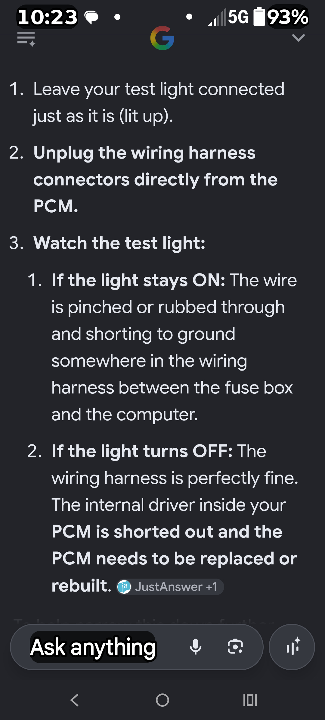

Okay so I did with you asked me to do the and they and they did light up C 3 lit up and C 12. While I was bored I went YouTube hunting videos and I saw some stuff on the ignition coil testing it down underneath in them two pins and they they both one side will come on on run as in the other side would pulse on crank and run so that's what's up on the ignition coil I was playing around these relays a little bit and it dang near cranked up on its own. So what all relays do I need for my truck?

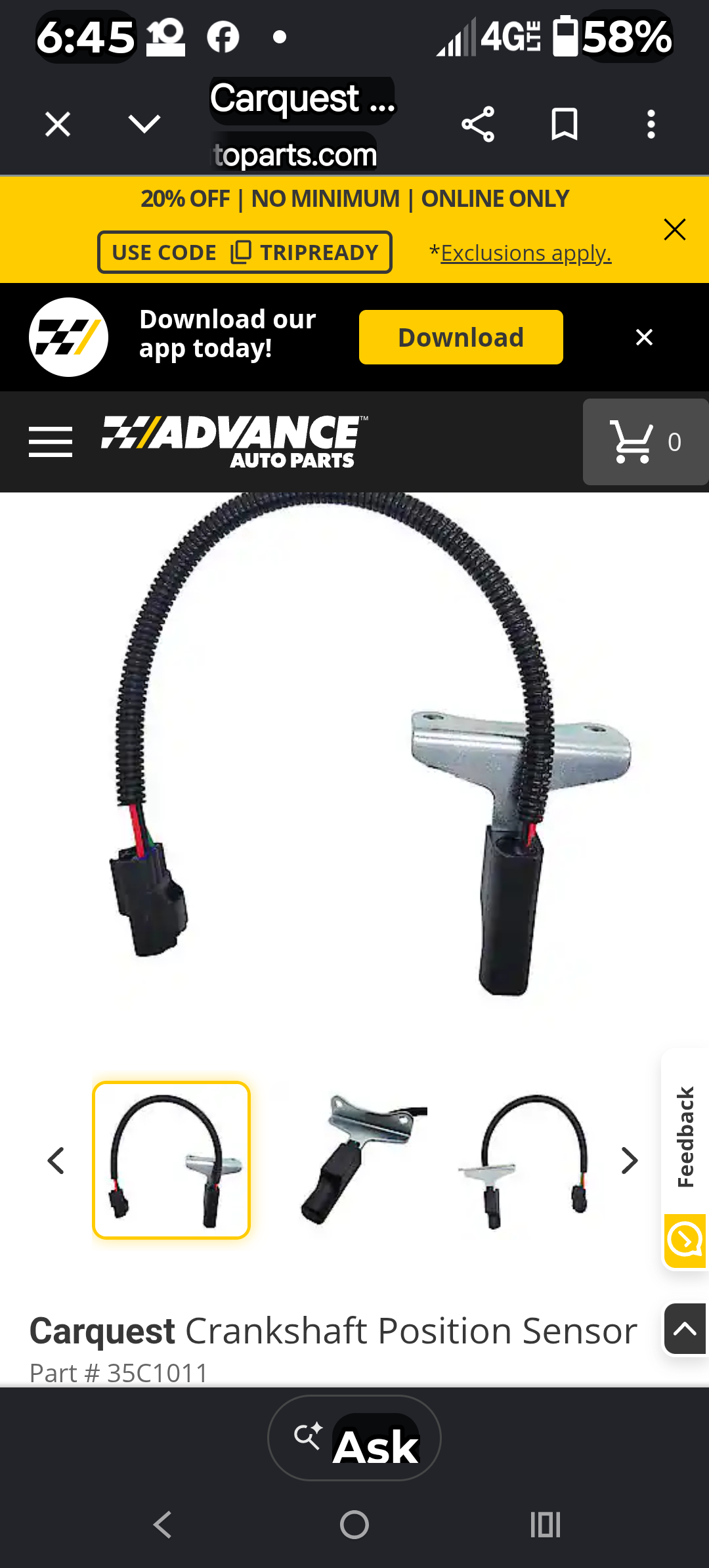

When you look at a new camshaft or crankshaft position sensor, if you see it has an oval-shaped bolt hole for mounting it, or a "U"-shaped slot, that design is adjustable for how far it is stuffed into the engine. That air gap is critical. To set that gap, new sensors come with a thick paper spacer glued to the end, or a thin plastic rib is molded onto the end of it. The paper spacer will slide off and be lost the first time the engine is cranked. The thin plastic rib can wear down a little. If you remove, then reuse one of these sensors, you can get a new paper spacer from the....... Well I wasn't the only one trying to put it in. But it does seem like I remember some sort of rubber that was getting in the way of putting in the crankshaft position sensor. I didn't finish putting it in but is it to late for the new one if it got fully tightened without that spacer?

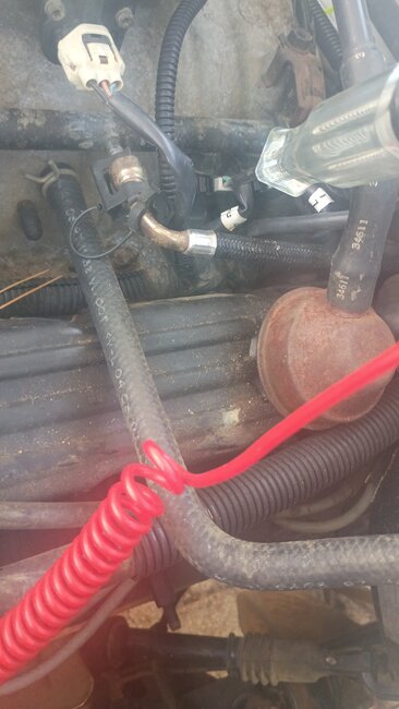

I redid the injectors test and got constant on gr/or. And I got a pulse on crank on the other wire

You can see that the mounting bracket on this design sets the air gap for you. There is no adjustment and no spacer necessary.

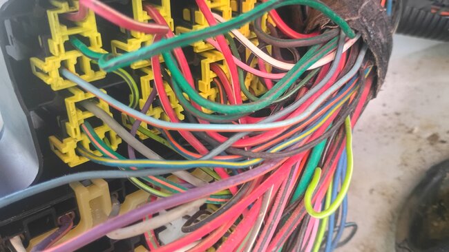

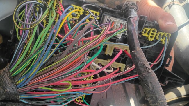

I keep forgetting to bring up the joint connectors on the relay box. Possibilities of some corrosion or something?
Aug 30, 2026 at 6:17 PM
So I took off the PCM so I can check all of the connectors, test wire continuity, and repair showing the underside and then the fuel pump relay specifically because my friend came out and helped me do tests and he knows how to read everything tool wise and the fuel pump is not sending fuel nor doing the 3 second prime.

Another way to approach this is to use a jumper wire or stretched-out paper clip to jump terminals 30 to 87 in the fuel pump relay's socket. That will give you all kinds of time to crawl underneath, if necessary, to listen for the hum of the pump.

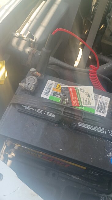

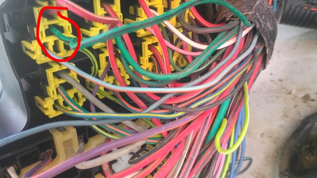

Ok so we have had a breakthrough today!!!!. I know that I was going above and beyond but at the same time, this was a number 1 answer that everybody I came across said might help. I cleaned every relay pin plus tightened them. My last idea was to clean up the joint connectors. I actually think that is where the problem is. But we straight wired the fuel pump to the battery on the crank wire and VOILA!!!!!! I still want to know how to fix it correctly.
Aug 31, 2026 at 9:19 PM
I need to know which wire you hot-wired. If you ran a constant 12-volt wire back to the pump, that still leaves a lot of undiagnosed circuitry. If you grounded the low-current, (coil) side of the fuel pump relay, that would prove the high-current half is okay and we need to look at why the Engine Computer isn't doing it.
This is a good time to explain the reason the system is designed this way. In the event of a crash where a fuel line gets ruptured, as long as the ignition switch remained on, the fuel pump would continue running and it would dump a lot of raw gas onto the ground. Obvious very serious fire hazard. Instead, with a ruptured fuel line, there could not be any fuel under pressure, so the injectors would stop spraying in fuel. The engine would stall, then there would no longer be signal pulses from the crankshaft position sensor or the camshaft position sensor. When either of those signals goes missing, (loss of engine rotation), the Engine Computer turns the ASD and fuel pump relays off. That stops the gas from being dumped on the ground, and it removes the 12 volts to the ignition coil and injectors so a bare wire there can't spark a fire.
How to look at the proper repair depends on exactly what you did to get the engine running. Obviously, the cam and crank sensors are working, and the ASD relay and circuits are okay. Tell me very specifically which terminals you used and how you jumped them.

Well I took apart the PCM and cleaned and tightened every slot then air hose blew them out and I sandpapered every relay pin as well as the fuses then I put that back together and dude got home and he jumped the wire on the far right side of the wiring harness. 8 said that was the wrong one that he needed to do the next one to the left (the green and black wire.... Hehe) tried cranking and it worked. Took off the jumper wire and it cranks every time without gas pedal but it idles at 1100rpm....

Which that one went to pin 85 on the fp relay
