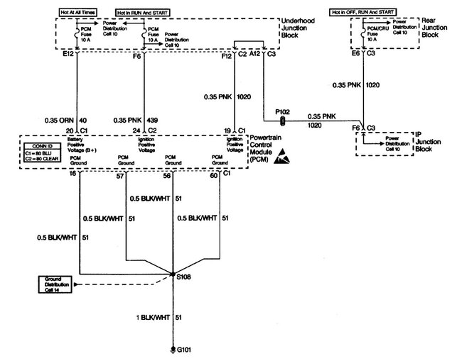

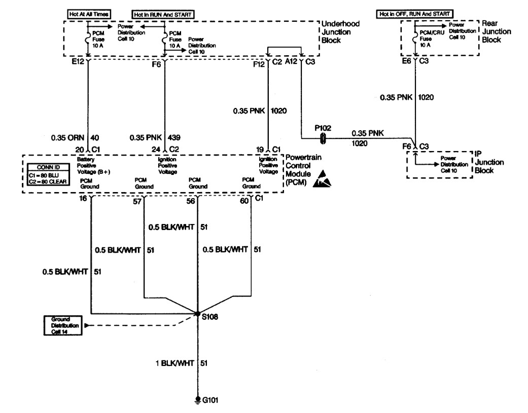

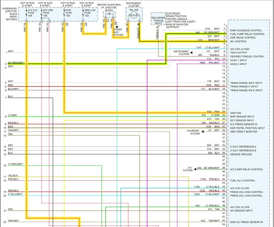

Hello, we have a pinout for the PCM for you, have you gone through with a test light and verified all the fuses have power? And does the Check engine light come on at key on?

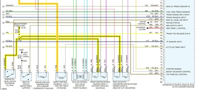

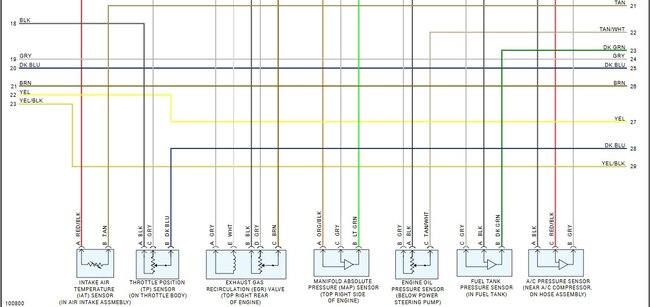

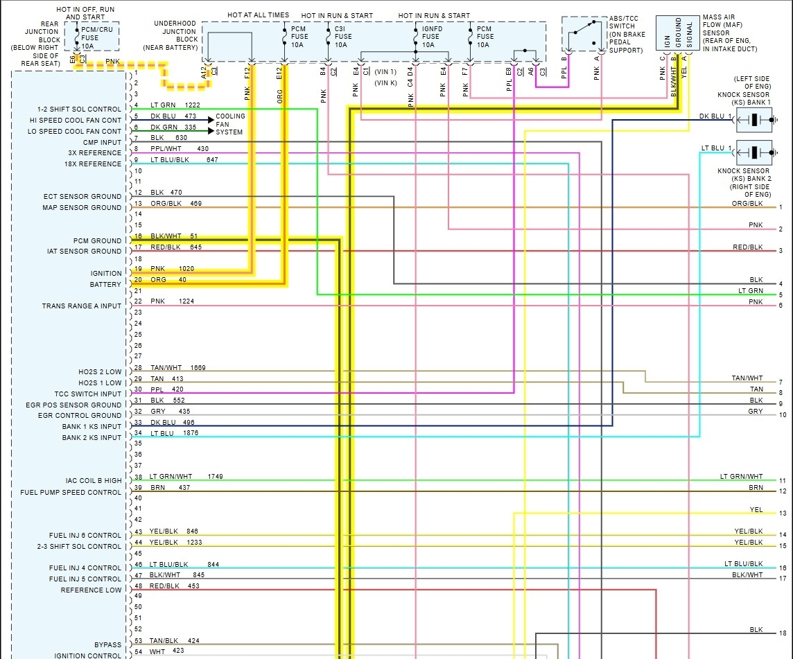

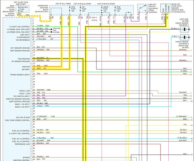

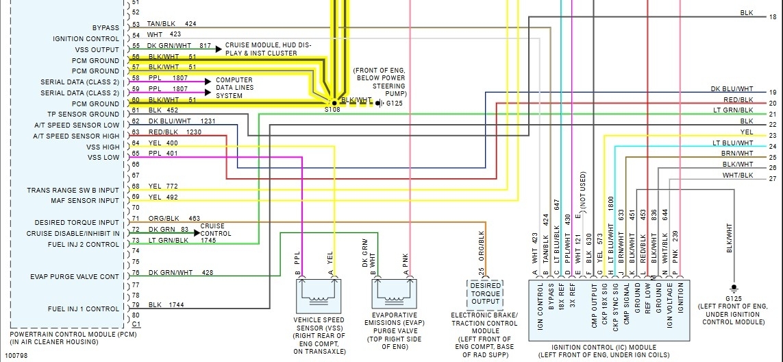

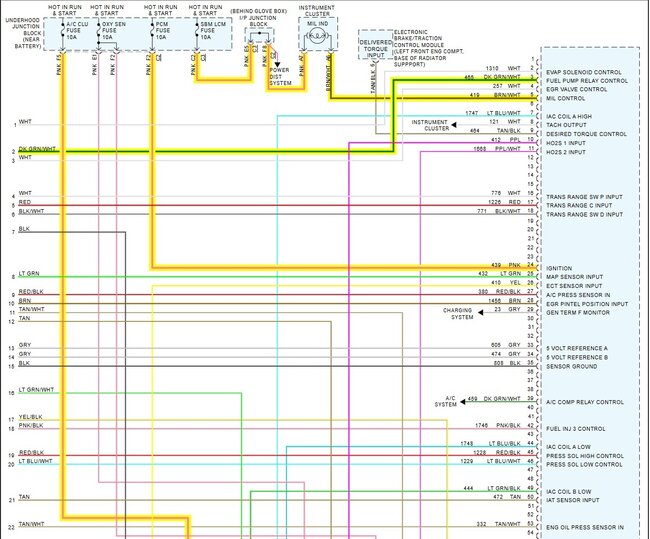

Did you upload the diagram yet and I just can't see it, or have you not uploaded it yet?
Oct 2, 2024 at 12:29 PM
AL514
  • 5,654 POSTS

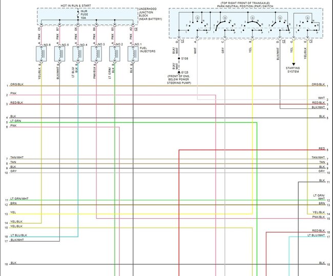

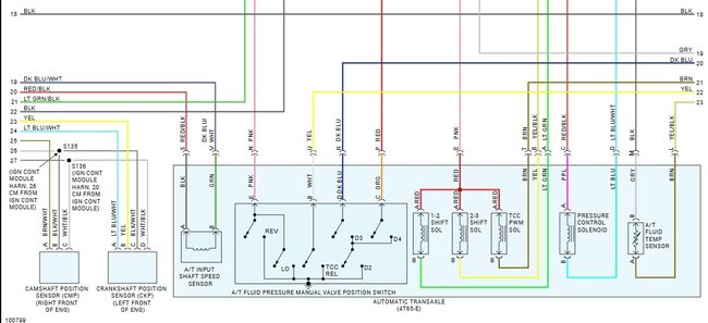

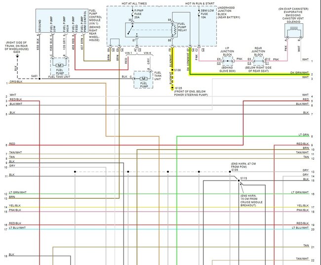

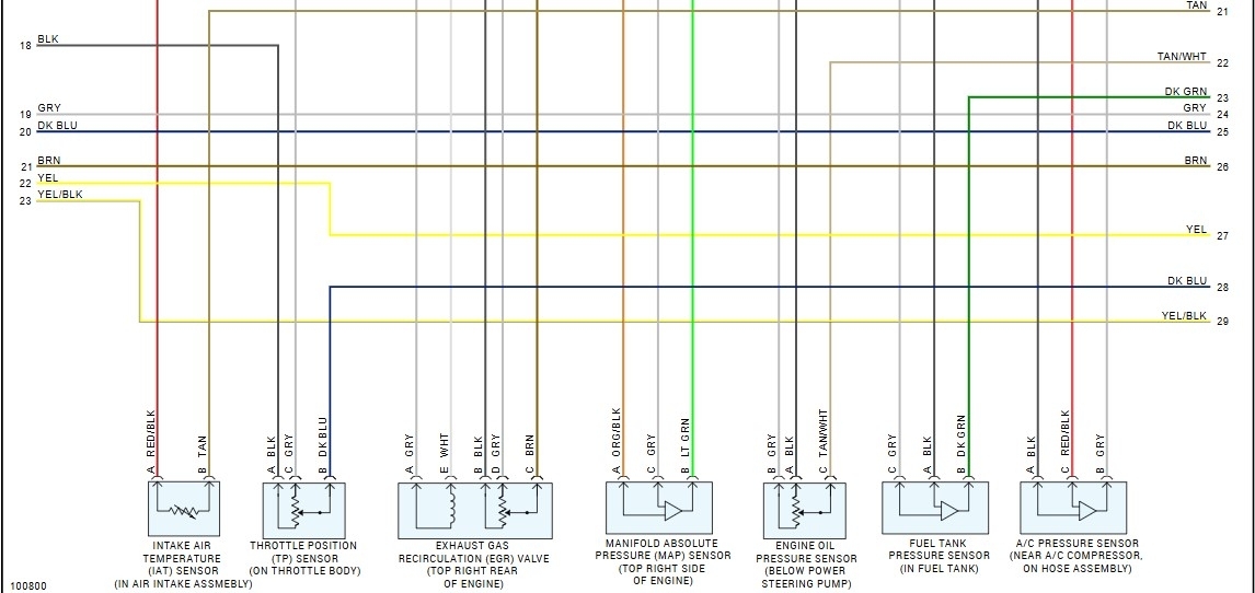

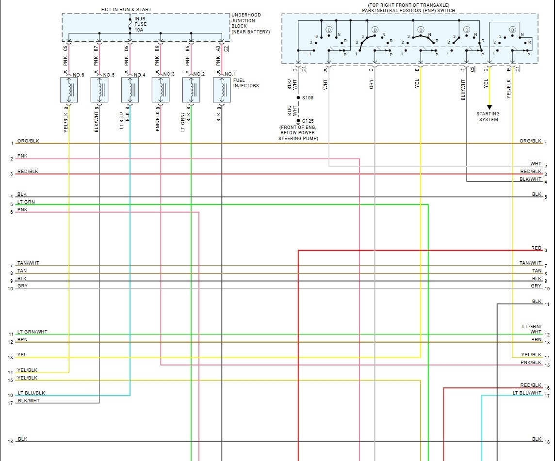

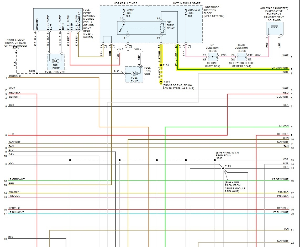

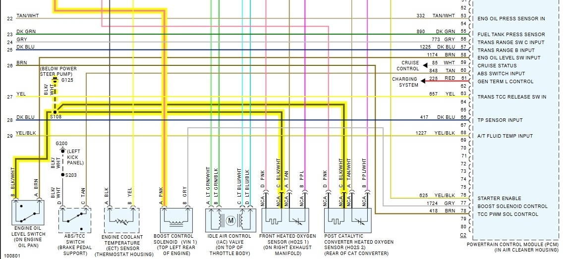

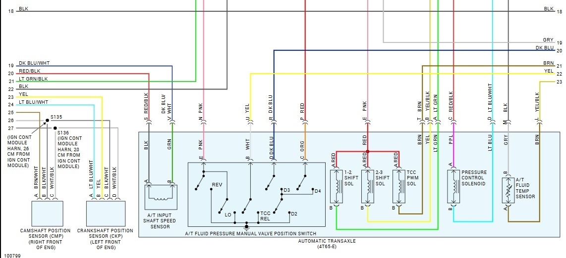

The 1st diagram is the oem PCM powers and grounds. Diagrams 2 and 3 are top and bottom page one of the entire PCM wiring diagrams, 4,5 page two, 5,6 page three, and 7,8 page four top and bottom.

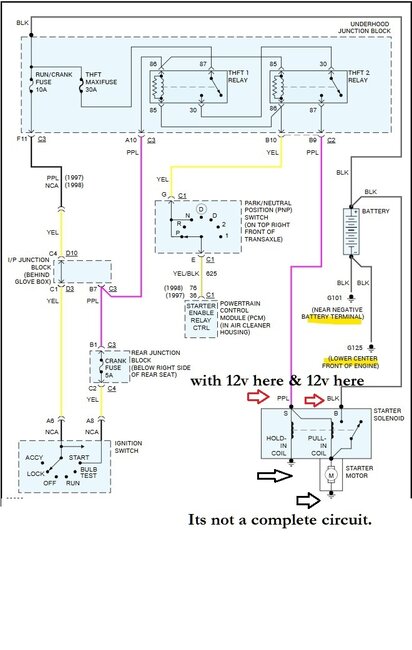

You have power to both wires at the starter with the key in start? And still no crank? If so, put a test light on battery negative and touch the engine block, if the test light lights up you have no ground to the engine block. Here's the starter wiring diagram.

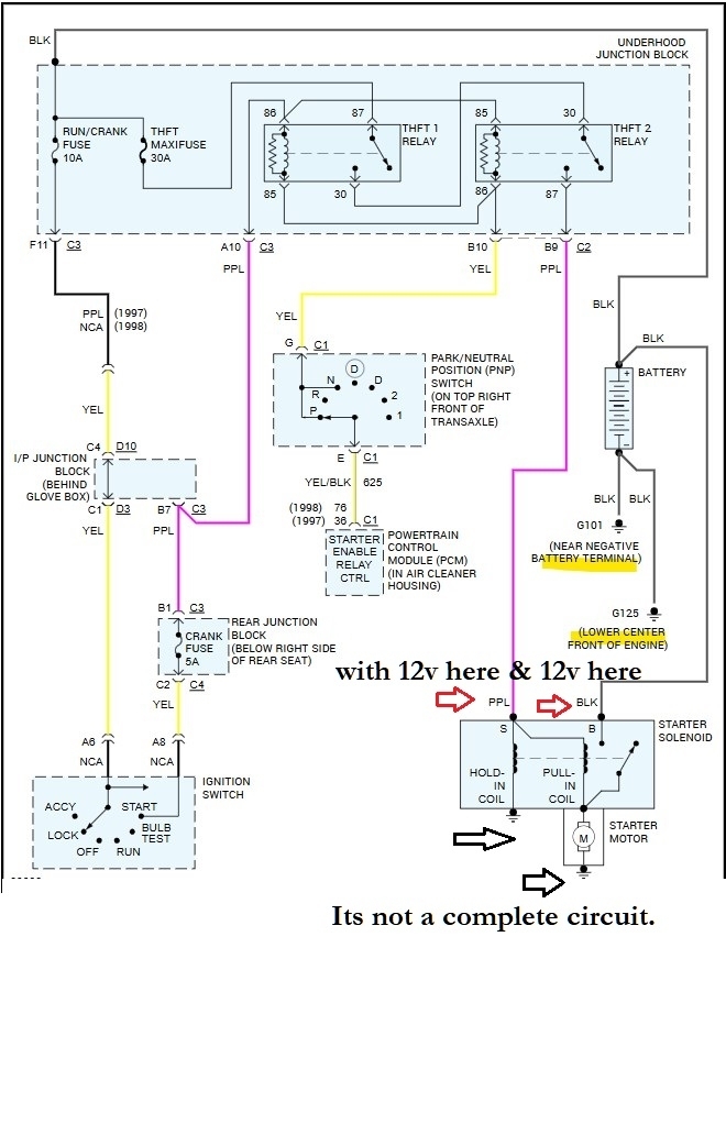

Yes, but even if the grounds are in the proper locations, which doesn't mean they can carry current, if a ground wire is bolted to a location that has paint on it, or the ground eyelet is not good, you will get strange symptoms like this. If there is power to both wires on the starter and the starter solenoid is not clicking to engage the starter motor, it sounds like you are missing an engine ground. A test light hooked to battery negative, then touching the engine block will tell you if the block lacks a ground. Because power is already at the starter, providing a ground with a test light to the engine block will light it up.
Or you can try just hooking some jumper cables from battery negative to the block and to the body, providing a temporary ground, if it comes to life, you know what the issue is.

Well, with power on both starter wires, if it's a full 12volts, and the starter is not engaging, either your starter is bad, or there is no ground. A bad starter will usually click the starter solenoid, but not engage to the flywheel, you wouldn't have power on the ignition switch wire at the starter if it was the Immobilizer security issue, the PCM would not energize the THFT 1 or 2 relays. I will have to continue with this tomorrow, its already midnight here.

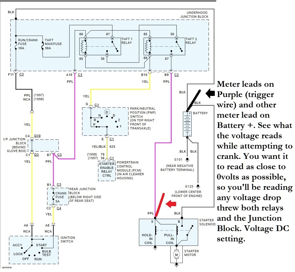

What voltage reading do you get on the solenoid wire (trigger wire) when attempting to crank it over?
I would also do a voltage drop test on that wire from battery positive to the trigger wire and see if there is some huge voltage drop occurring while trying to crank. Jumping to the solenoid from the heavy gauge starter wire obviously doesn't have any voltage drop on it and it's provides enough current flow, so there might be an issue where the trigger wire can't carry current.
If you read high voltage during cranking, that's the amount being lost on that wire due to a connection issue somewhere. Do that test first, you might need to have someone else crank it for you so you can monitor the multimeter.

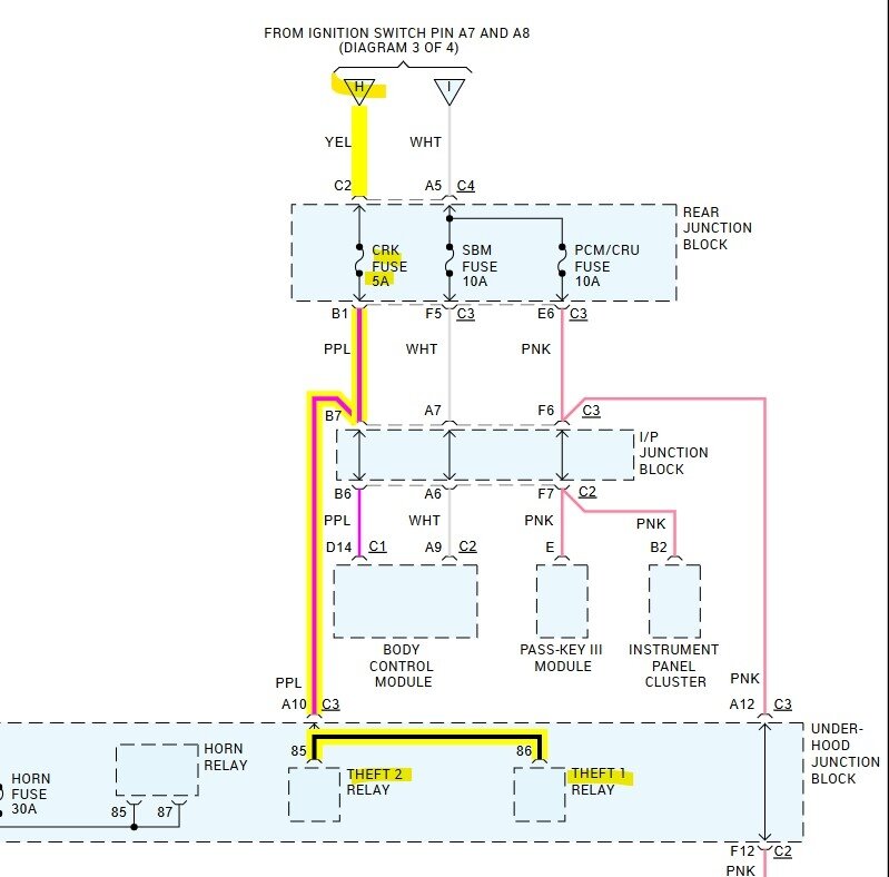

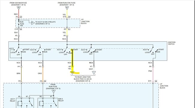

The purple smaller gauge wire should only have battery power in crank, correct. What does it go to in the start position?
Oct 3, 2024 at 11:05 AM
AL514
  • 5,654 POSTS
This is the power from the Ignition Switch Start position to the 2 Theft Relays,
Oct 3, 2024 at 11:18 AM

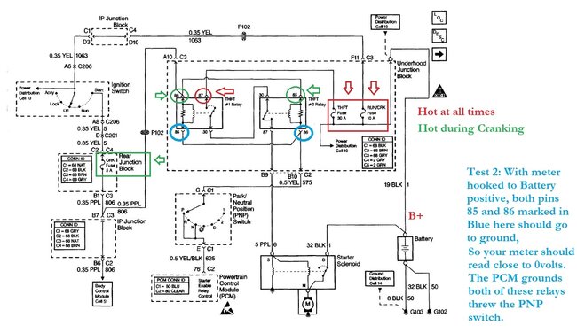

Okay, so, if you were to switch the leads around on that last test, you would read +12.5volts, its only reading -12.5 because the leads are reversed. So you are reading voltage drop on the positive side of the circuit. You should not read voltage on the purple wire in any other position except Crank, thats all. During cranking you should only read less than 1volt max from positive to positive. Even 1 volt is pushing the limit, but for keeping it simple right now, lets say 1 volt.

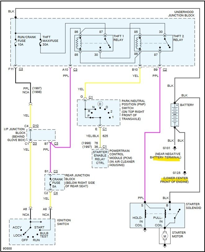

Hook your black meter lead to B- and go back and check for voltage at the other protection components in the circuit, ie
Run/Crank Fuse 10A, should have power all the time,
if its okay, then go to the Theft 1 Relay, take the relays out and check for power at their pin locations,
it should have power all the time on pin 87 because power comes from the THFT Fuse 30A, and then with the key in the Crank position there should be power at pin 86 (THFT 1 Relay) and at pin 85 (THFT 2 Relay).
Check with your meter and test light, lets make sure power is getting to those locations first. You will need someone to crank it for you so you can be sure you have a good connection and dont spread the relay location pins, just touch the meter leads to the pins, spread connector pins can cause all kinds of issues.
So THFT 1 Relay should have power on two pins while in Crank, and THFT 2 Relay should have power on one pin during Crank.
Im going to post the oem Starter diagram for you in a sec here also.
What fuse was the label for the #2 fuse that was blown?
Oct 5, 2024 at 9:11 AM
AL514
  • 5,654 POSTS
This is the oem Starter diagram, Ive highlighted the relay pins that should be hot at all times and in Crank, in different colors. let me know what you find, depending on the results of these tests, will determine where we go next.

so, are we looking for a maxi fuse for the theft fuse? there's only one 30 amp fuse in the underhood fuse box it is for my horn other than a maxi fuse.
Oct 5, 2024 at 10:14 AM
AL514
  • 5,654 POSTS
Hmm okay, let me recheck service info for any other vehicle listings, do you see the two THFT relays labelled in that box?
Oct 5, 2024 at 10:21 AM
AL514
  • 5,654 POSTS
It may not be a Maxi fuse, even the other Vin # for this vehicle has the same diagram for the starting system. THFT Fuse 30A. It's possible the incorrect fuse is put in the 30-Amp location, is there any THFT fuses in the engine compartment fuse panel?
