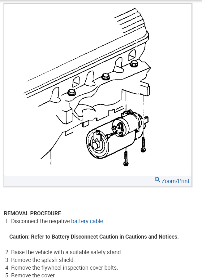

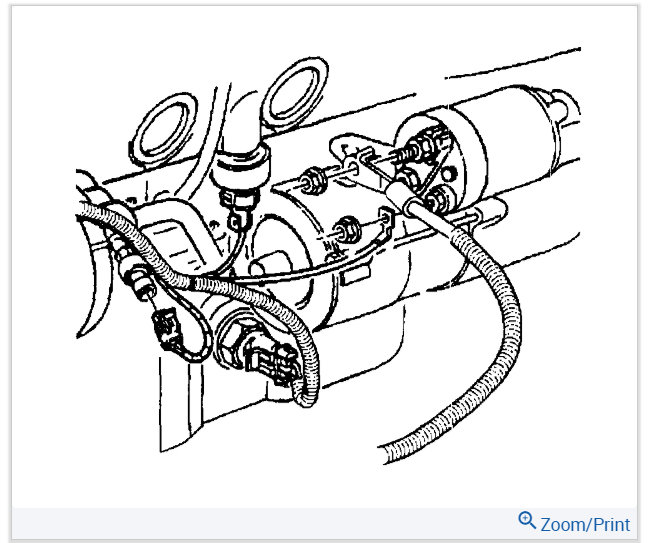

It sounds like the starter motor has gone out or you have a bad battery connection. Here is a guide to help you get started on checking for the problem:
If okay use a test light to test the small trigger wire and the starter to confirm the failure. Here is a guide:
If bad here is a guide to show you how to change the starter out:

Thank you it was the starter. I got an AC Delco unit for $134.00 started right up.
