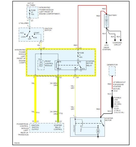

I bought the van listed above and I was told that it only needed a starter. The car would not crank at all, so I put a new starter in it, still same symptom, jumped the starter with ignition open and no spark. Bought a new ECM and the car started right up and ran for about 30- 45 minutes. Until I shut it down to restart and make sure that it would be alright. The van started up but shut off after 10-15 seconds. As I kept trying to restart, it went right back to no crank mode. I believe that maybe a crankshaft position sensor or cam sensor is probably shorting out the ECM. I noticed that when I unplug the negative battery terminal, or attempt to reconnect the negative terminal, I get a light ark or light spark. Is it possible that it could be maybe one of these sensors? Anyone?
Any help would really be appreciated!
Thank you,
ED
Apr 1, 2020 at 11:22 AM
Good morning,
When you try to start it does the theft or security light come on and go off after about 10 seconds? It could be a security issue.
https://www.2carpros.com/articles/how-to-reset-a-security-system
Are there any codes set in the system?
The small arc is normal. Sensors will not fail an ECM at all.
Did you have the ECM flashed to your VIN number prior to installation?

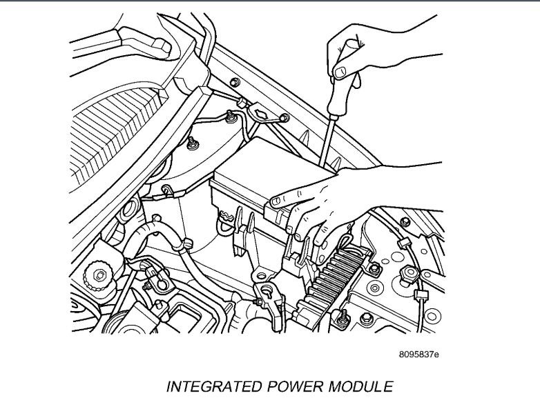

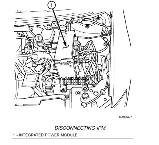

a common issue is the power module or the TIPM. That is the fuse box and is very common for this issue.
REMOVAL
1. Disconnect the negative and positive battery cables.
2. Remove the battery thermal guard.
3. Remove the battery.
Integrated Power Module
4. Using a flat-bladed screwdriver, twist the Integrated Power Module (IPM) bracket retaining latch outward to free the IPM from its mounting bracket
Disconnecting IPM
5. Rotate the IPM counter-clockwise to access and disconnect the electrical connectors.
6. Remove the IPM bracket clips from the hinge.
INSTALLATION
1. Snap the left side of the Integrated Power Module (IPM) housing in its mounting bracket and connect the various electrical connectors.
NOTE: Ensure that the Connector Positive Assurance (CPA) on the five-pin B+ connector is positively engaged to prevent generating a Diagnostic Trouble Code (DTC).
2. Rotate the IPM clock-wise until secured in mounting bracket. An audible click may be heard.
3. Install the battery.
4. Install the battery thermal guard.
5. Connect the negative and positive battery cables.
6. Using a scan tool, check for any stored diagnostic trouble codes. Ensure that all vehicle options are operational.

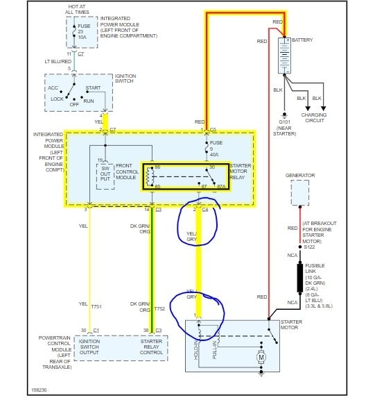

No, there were no codes stored in the system and the anti- theft light does come on for about 10 seconds then goes out but still no crank. I can hear clicking from the relays in the fuse box in the engine compartment but nothing else. Another thing I noticed is that every time I go to crank the van, the inside fan or the AC/heater with turn on by itself, along with the DVD player (that is mounted on dash) comes on and starts blinking as well? I really do believe it has to do with the transponder key and or the transponder module in the steering column or at the key switch.
Apr 9, 2020 at 11:58 PM
Okay, I attached a wiring diagram again for you. Check the wire at the starter solenoid for power in the start position when the car will not start.
That will tell me if the TIPM is sending power to the solenoid.
