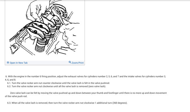

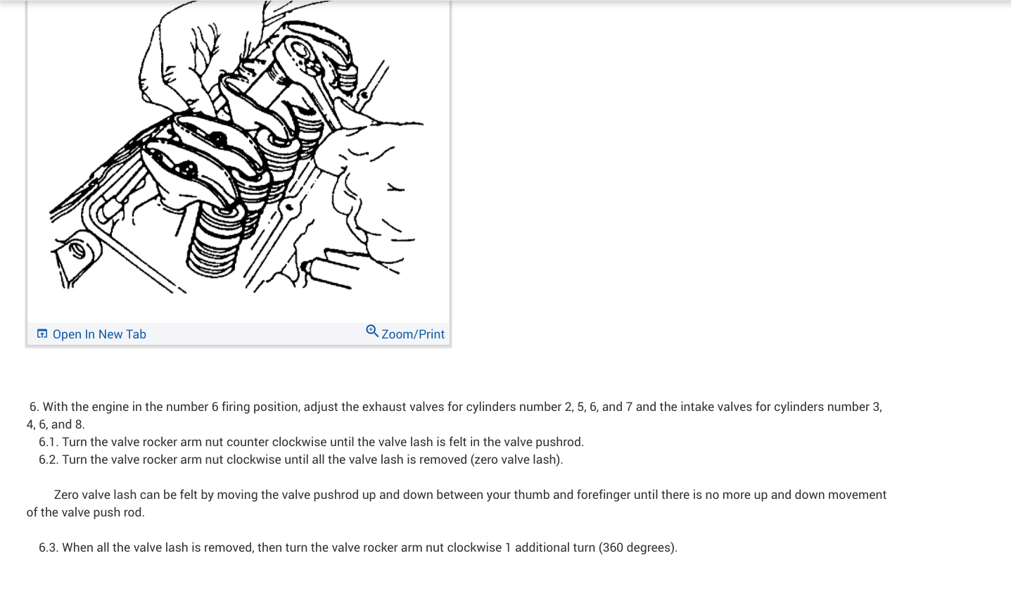

I just completed the replacement of both head gaskets and a valve job. After I finished and tried to start the engine, it would not start. I know the timing is on. Checked compression and found I had 0 psi. I'm thinking I tightened the valves too much. I have taken off the valve covers to re-adjust the valves according to the GMC manual. (I've done this 6 times before and the last time was 20 years ago!) I believe I made a mistake!!!
I do not see any bent push rods or bent/broken valves.
Will over tightening the valves cause 0 compression?
Thanks in advance.
Carl

I don't believe so, and if it did you would have a bent valve and/or bent pushrod. Did you lap the valves into the cylinder head valve seats?

Yes I did. I'm going to try to adjust the valves using the GM repair manual. I did adjust them using their method, but went 360 again, a quarter turn at a time, and tightened them again! After I adjust them again I'll shoot air into the cylinder and feel or hear for leaks.

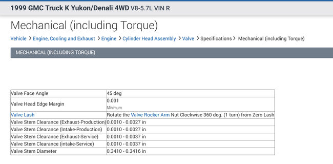

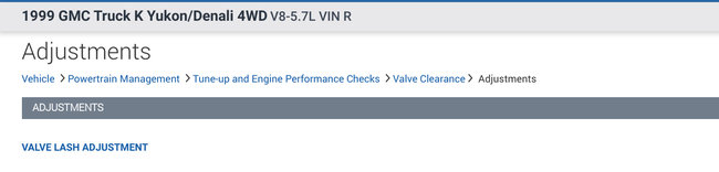

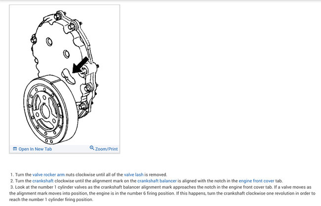

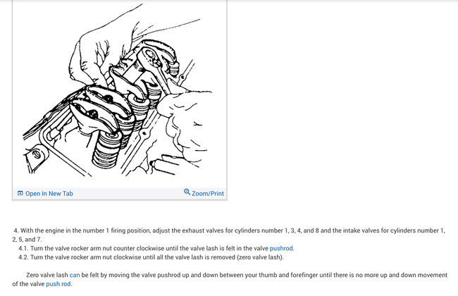

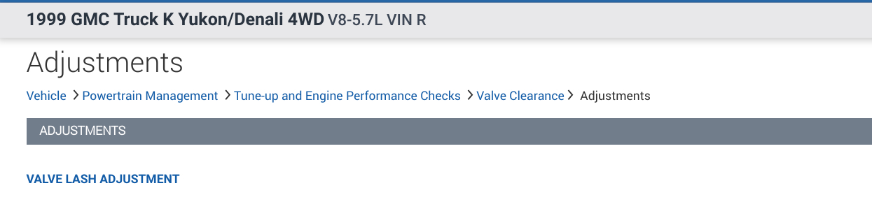

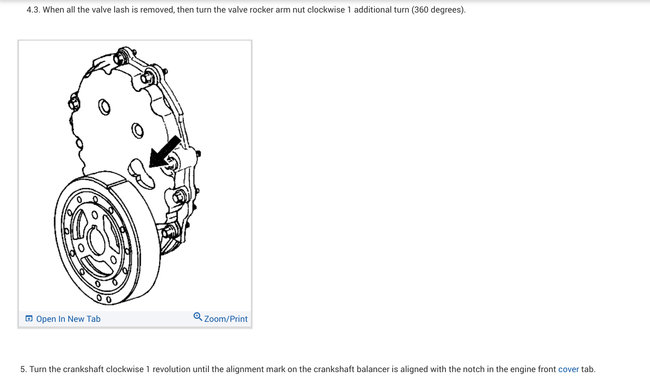

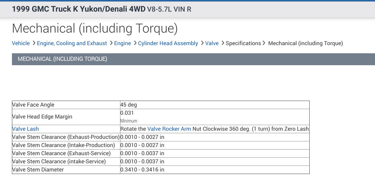

Okay, so in the diagrams down below I have included the specs. for the valves on your vehicle's engine and the instructions from the vehicle manufacturer on the procedure for adjusting the valve lash. Please go through these guides and get back to us with what you find out. Also, did you use the same head bolts when you reinstalled the heads on the engine block? I have found doing a search of Technical Service Bulletins[TSB][s] for your vehicle one that deals with the head bolts. Please get back to us with how things are going.

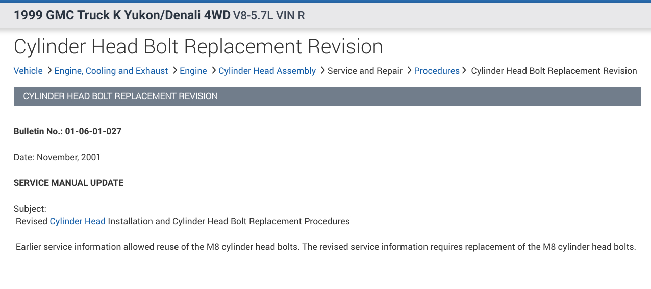

Yes. I used new head bolts. I have the same manual as you are showing. I'll let you know when completed.

The best way to adjust valves is to start on number 1 cylinder TDC loosen both intake and exhaust rocker arms so there is plenty of free play hold the push rod with two fingers and rotate the push rod between your fingers as you tight the rocker arm until you have resistance than stop that valve is adjusted. Do this in firing order each cylinder at a time and the vehicle will start. (The best way is to adjust valves is with the valve covers off vehicle running). Let us know if this info. was helpful and if it fixed your vehicle.

I've adjusted the valves per the GM repair guide and I now have compression in every cylinder! I've put it all together but will not try to start it until the distributor arrives. Hopefully tomorrow! I believe it will start now as it is cranking more freely and have good compression in all cylinders.
