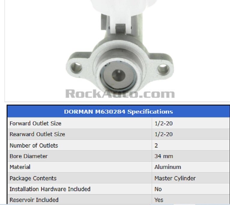

Finally, the one thing that's left is what I suspect has happened. There's at least four different master cylinders listed for your truck. They have different cylinder diameters for different applications. It's customary to incorporate some significant difference so the wrong one can't be installed. The most common is the port size. In this case they're all the same, so it appears any size master cylinder can be installed. The cylinder diameters listed are 1.25", 1.338", 1.438", and 1.456". I'm betting you have a 1.25" diameter bore when the application calls for a larger one. With the smaller bore, you'll need to push the brake pedal further to get the required volume of brake fluid.
There's almost 1/4" difference in bore sizes. That is huge when designing a system that's balanced front-to-rear, and with a good compromise between pedal travel and pedal effort.
GM lists different part numbers but I can't find any numbers on the castings to compare. That leaves physically measuring the diameter of the bore. You might be able to do this with a tape measure. If that doesn't provide enough accuracy, you'll have to pull the piston assembly out, then measure the inside diameter of the bore.

This is a photo of the master cylinder for your truck. You can see the snap ring and the fully-released piston. I've also seen some with a wire ring holding the pistons in. Those require swear words to remove.

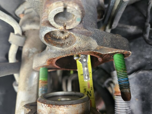

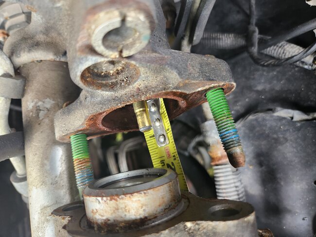

Update. Piston is back against snap ring. Bore is 1.25 to 1.312. Pedal is 2 inches off floor when pushrod contacts master piston. Pushrod only travels about .75 inches which means the master piston only has a .75-inch stroke. What's going on here? I know when a vacuum booster is installed the pushrod travel is adjusted. I don't know if or how there is an adjustment on a hydraulic booster. By the time the pushrod travels that. 75 inches the pedal is on the floor. I read the average stroke for a master cylinder is 1.5 - 1.75 inches. I have tried to include pictures with measurements. Apparently I can't include them?

Push rods are not adjustable on most domestic models. They are on a lot of import models, but that is not a maintenance adjustment. It is set at the factory and is not meant to be changed.
It sounds like you're describing a mechanical problem inside the booster. I've never run into that on vacuum or hydroboost boosters. In fact, in over 40 years, I only replaced one vacuum booster and am aware of one other one that was replaced by someone else. I'm not aware of anyone having a problem with a hydroboost unit. Also, we don't rebuild them ourselves, so we don't teach that or even take them apart.
I'm going to get one of our other experts involved. He may have run into this before.

Thank you. Why can't I add photos? This shows pushrod fully extended, pedal on floor.
May 14, 2023 at 1:14 PM
JEFF HERMAN
  • 486 POSTS
Here's the pushrod when it just contacts the master piston.
