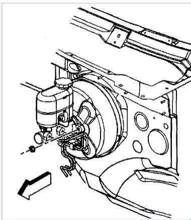

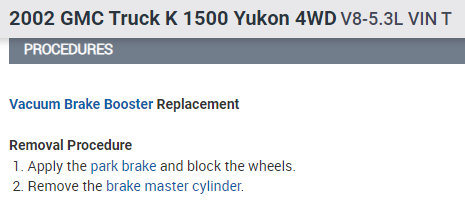

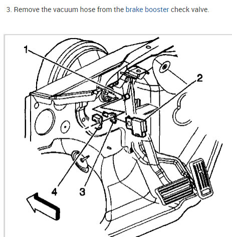

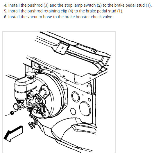

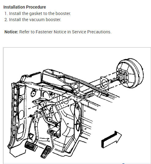

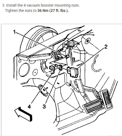

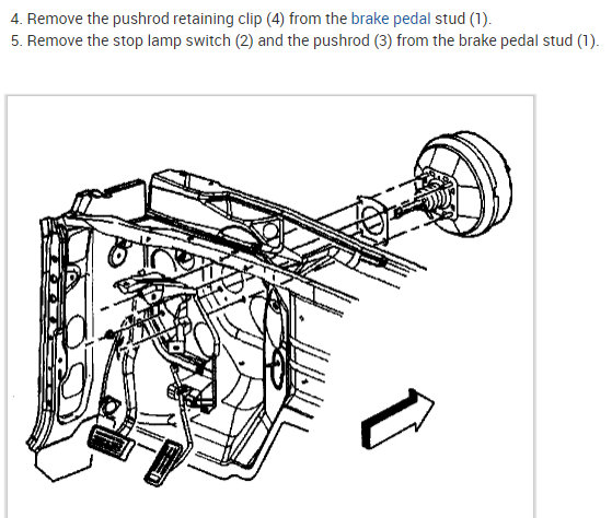

The brake pedal is hard to push please help me change the booster out.
Jun 29, 2010 at 11:31 AM
DANNY L
  • 5,648 POSTS
Hello, I'm Danny.

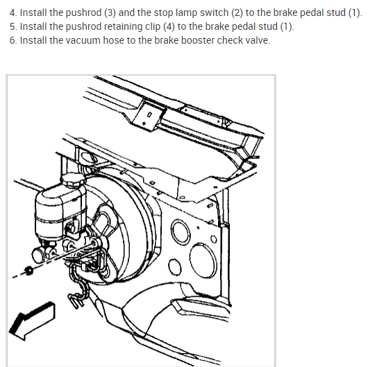

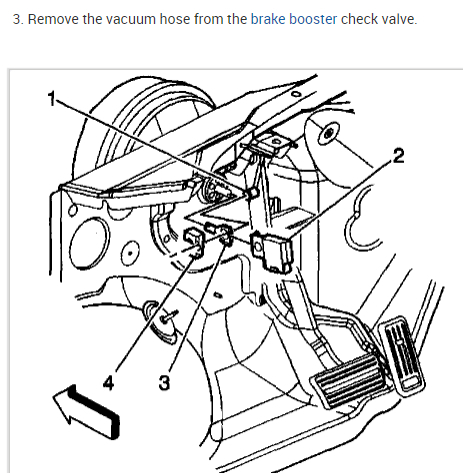

Here is the information you requested. I've attached picture steps below for removal and replacement of the power brake booster on your vehicle. Hope this helps and thanks for using 2CarPros.
